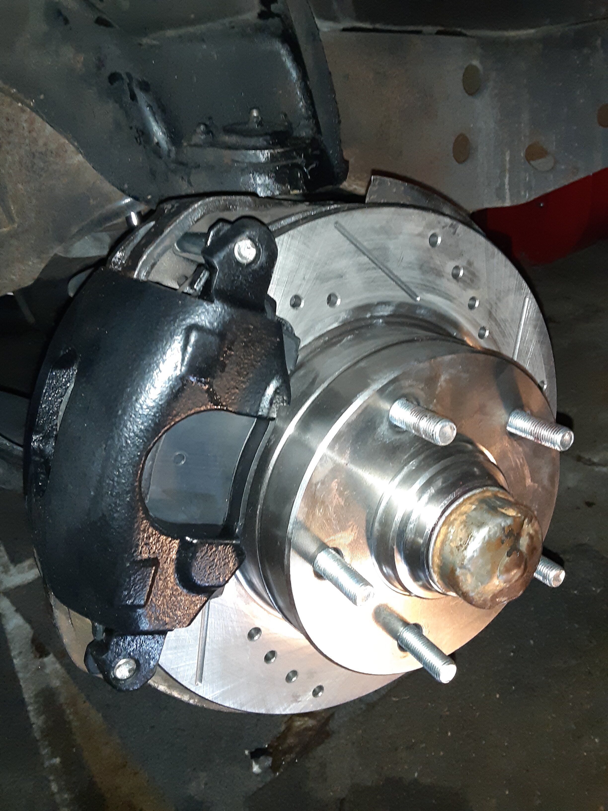

I am going to be replacing my front rotors with drilled and slotted rotors. The question I have for anyone here is as far as the brake pads go would you use the original organic type or would you go to a ceramic or semi metallic?

I know This type of rotor there is a difference between right and left side correct? And are they stamped left and right Also did you use the Z 23 rotors or the Z 26 seems as though the Z 26 are the better ones just curious what you used. I looked on power stops’ site and it showed how to tell the difference but I’m still curious which ones you used.
If you haven't purchased yet, slotted is OK, drilled only makes the rotors lighter (less mass to absorb braking heat) and don't help in braking. Some crack around the holes. Race cars pretty much stopped using drilled rotors.
One more question regarding these power stop brakes installed the rotors and the pads they will not go on the rotor with the caliper pushed all the way back is it acceptable to take those shims off that seems to be the only way they will go on other than sanding pads down which doesn’t sound like a good idea

I have original calipers I got them from Leo rebuilt them I just don’t believe that the calipers should be hammered on to mount them on the rotors. When I first bought the car the pads on the car were riveted there were no shims on them. The next set of brakes I bought from Napa were riveted pads and they had the shims on them. Right now I don’t see any other option I just wanted to know if anyone else had the same issue I do
Removal of the shims is what my son had to do to both of his cars. Make sure to coat the back of the pads, where the shim was with "disc brake quiet" or similar product. The shim is an anti- rattle/squeak shim.

Right I knew that’s why they were in there but previously with other brake pads I’ve never had to remove them. I have some brake silicone type lube that I could put a thin coating on the back of the pads and I think that would work. What do you think?

Mine wouldn't go on either but the piston wouldn't go back all the way so I replaced them. The first few stops may feel a little spongy but once they seat in you'll like them.
OK I’m hoping so.
I got my Power  Stop brakes and rotors on, bedded them in according to their instructions and the brakes have definitely improved. I always felt that something was wrong with them. I had GM rotors on the car date code F192, June 1972. The surface looked heat hardened, or work hardened and with less than a minimum thickness of .965. I used to work on these cars in the late 70’s to mid 80’s and I know I don’t have the knowledge that many people on this site have, but something always seemed wrong and now with the Power Stop rotors and brakes it is considerably better. On another note I also got rid of the hesitation or bog at full throttle on the Quadra jet. I made some adjustments as per Cliff Ruggles book on Quadra jet‘s and I have gotten rid of the bad hesitation when I nail it. Sometimes there is a very very slight hesitation when I floor it if the RPM is too low but I can live with that, just keep the rpm up and it takes off great. I wish I had that knowledge years ago. It also roasts the tires pretty good on a 3400 RPM clutch dump.
