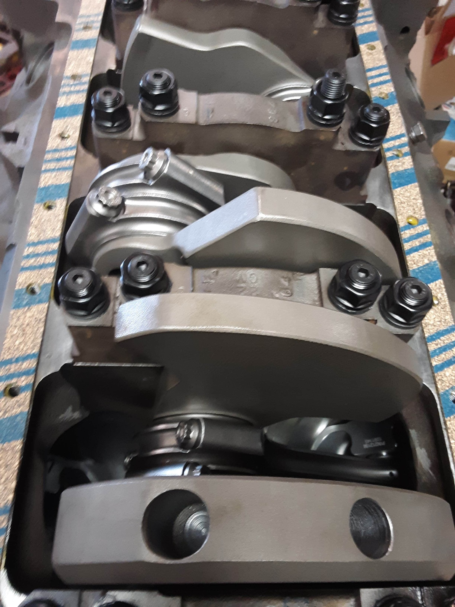

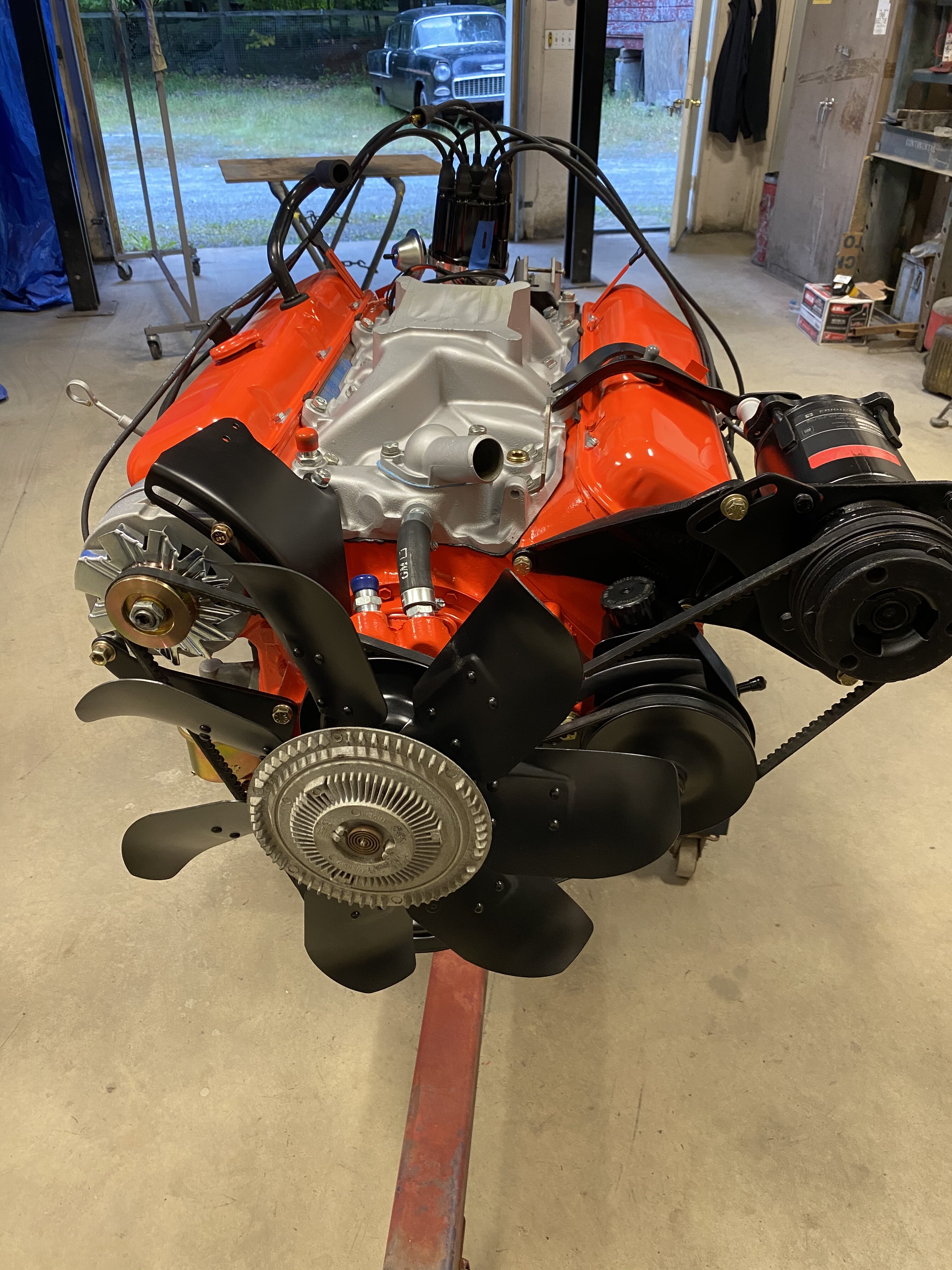

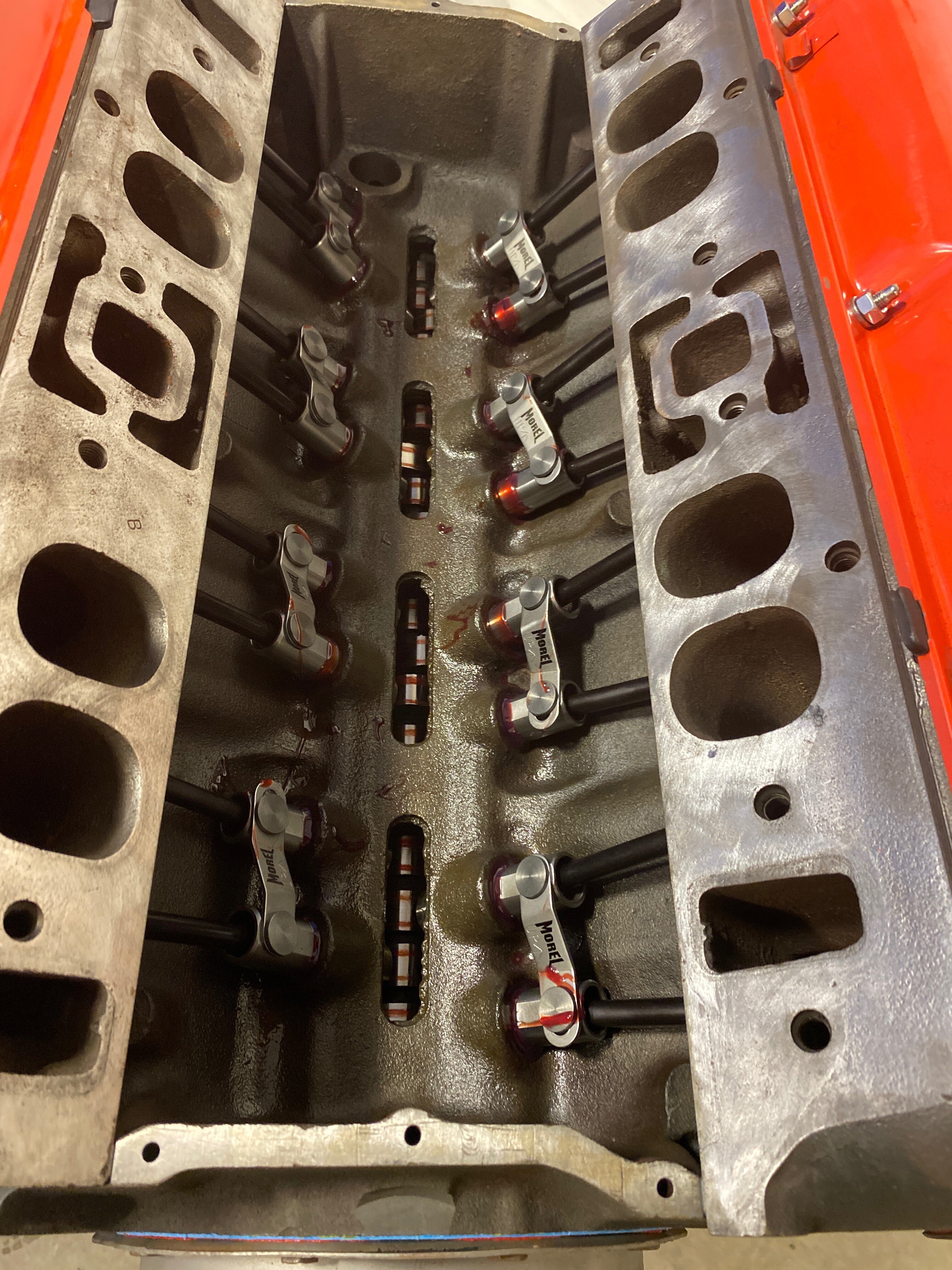

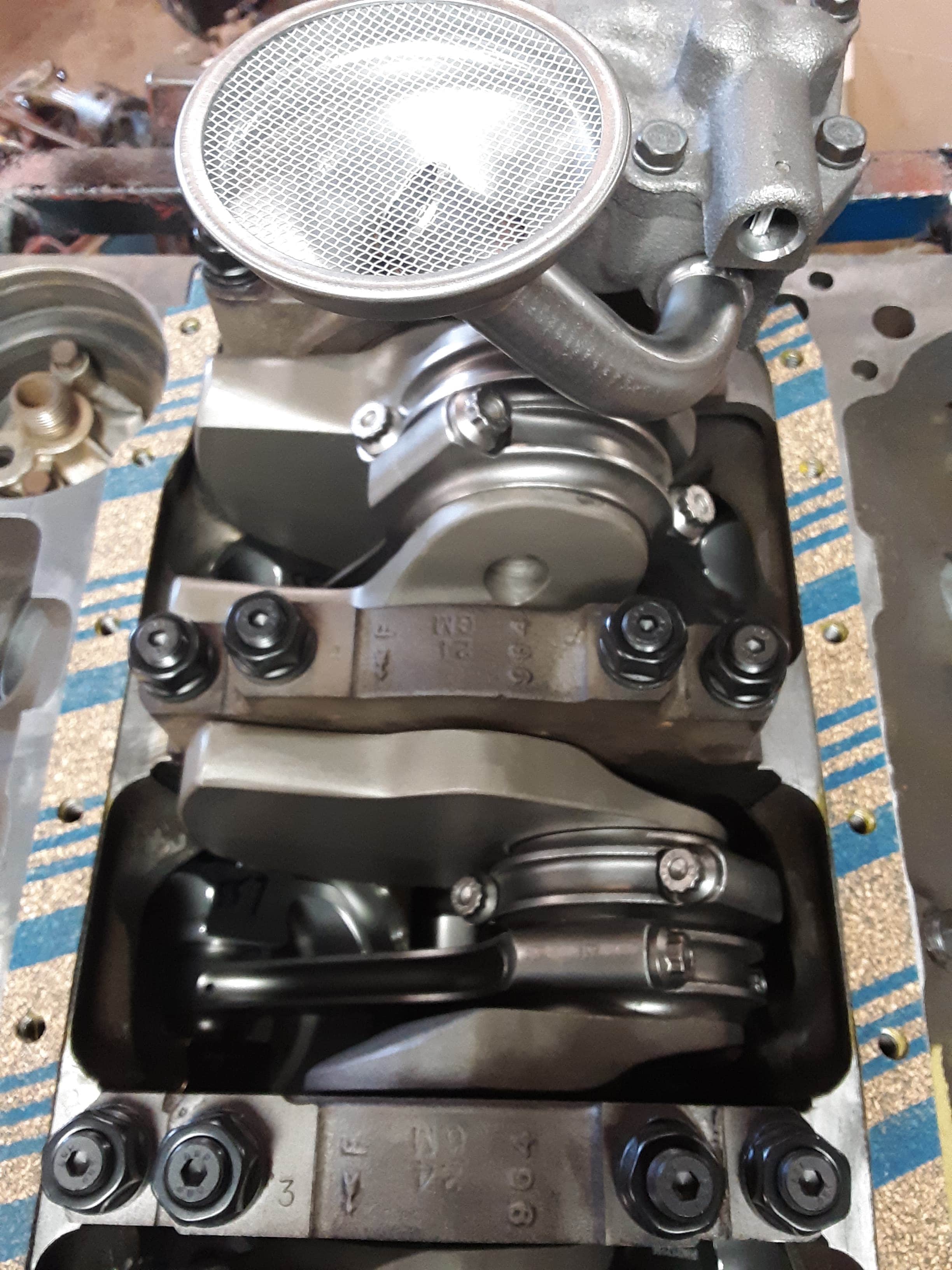

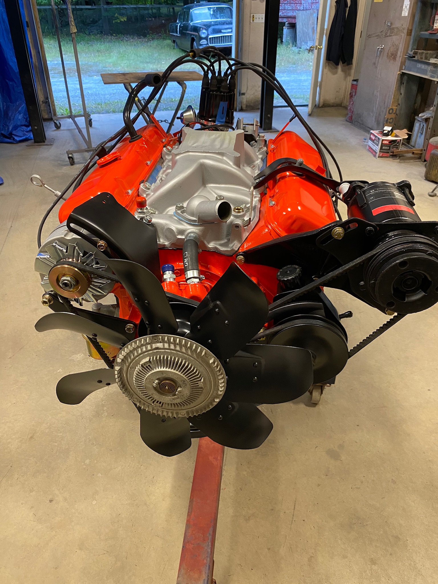

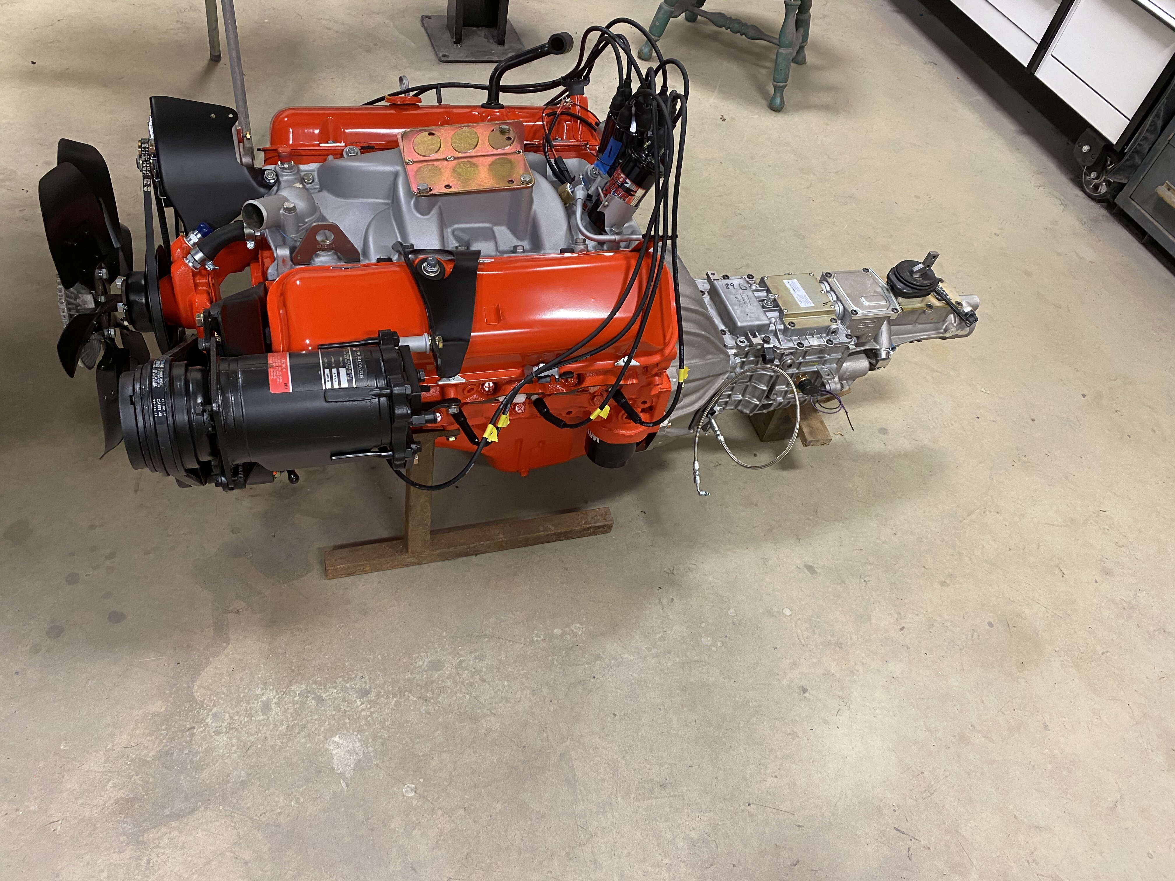

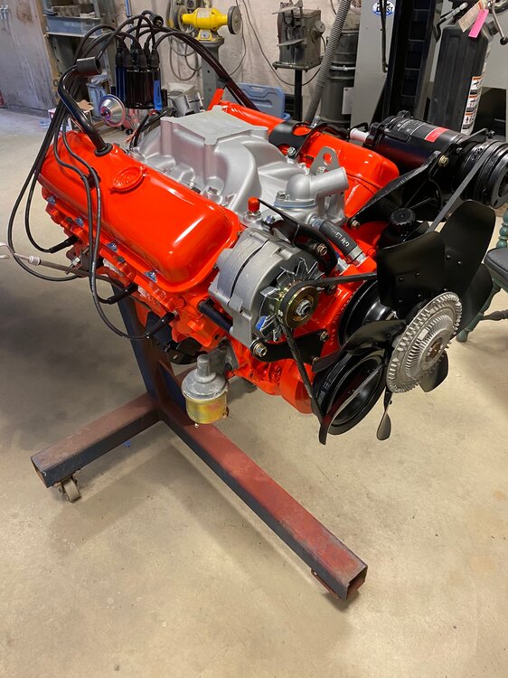

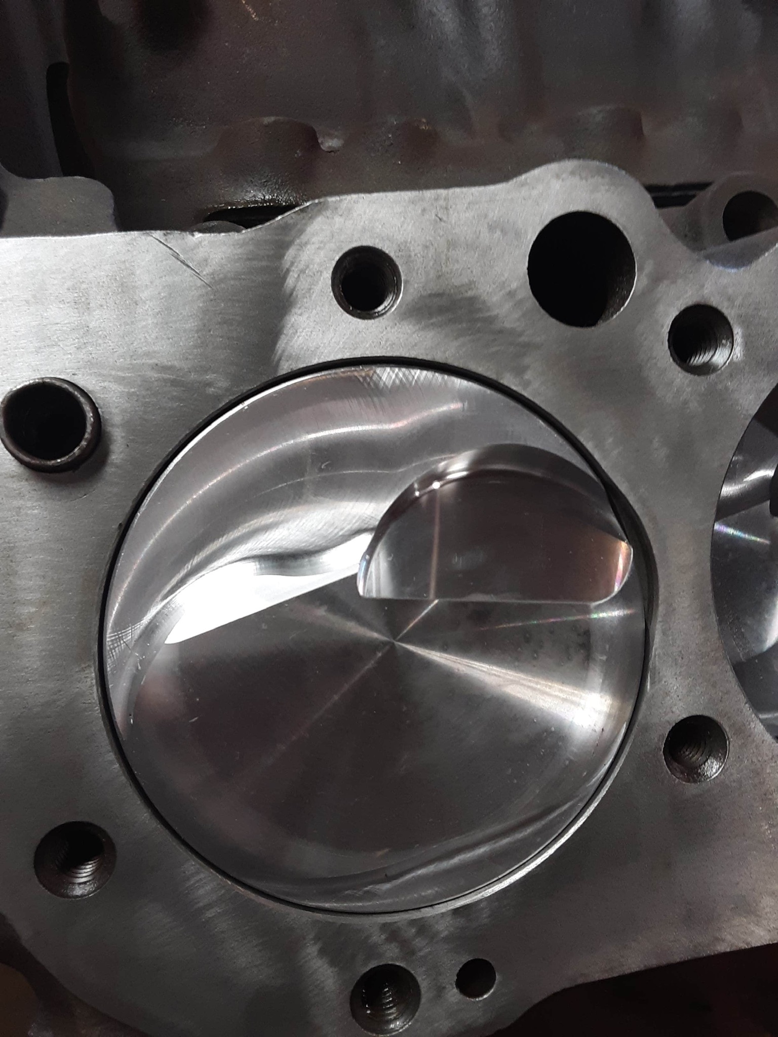

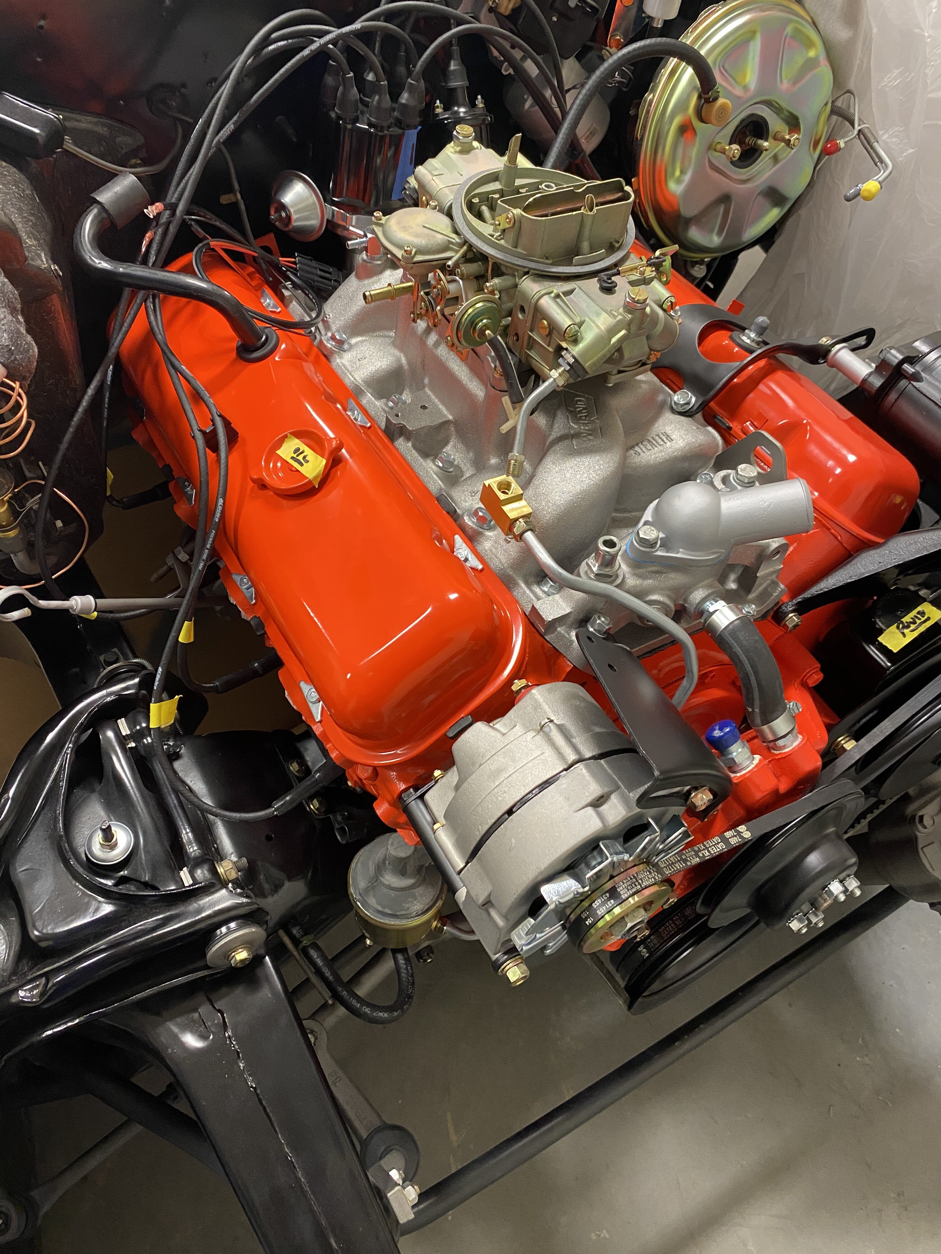

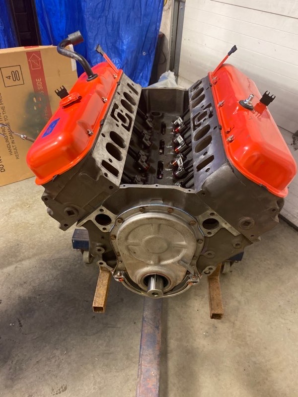

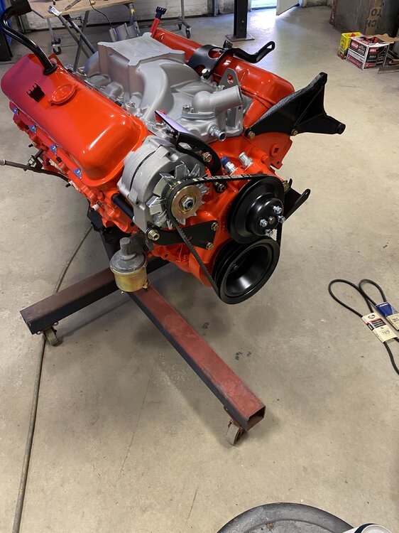

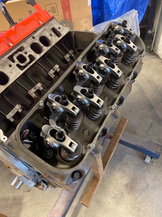

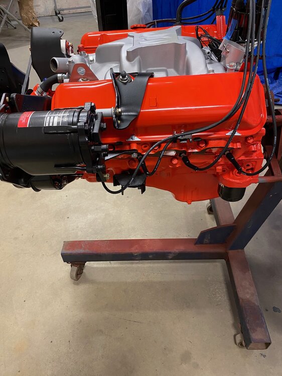

This is where I’m at.  Nos 454 4 bolt block stroked to 496.comp cam #11-422-8 roller cam.  .520 lift 218/224 duration at .050 so roughly 270 278 advertised duration. Cam is installed at 105 degrees rpm range 1,600-5,400.  781 oval port heads. 5 speed. I’m gonna replace the 3:31 with 3:73.   4 core radiator.  I have to redo the buckets and rear bench. Is legendary the place to buy?   Also, front and rear glass date coded. Where to buy?

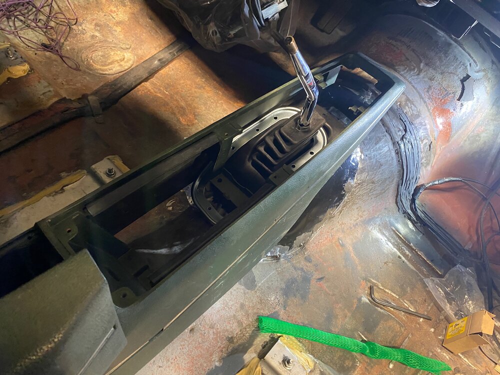

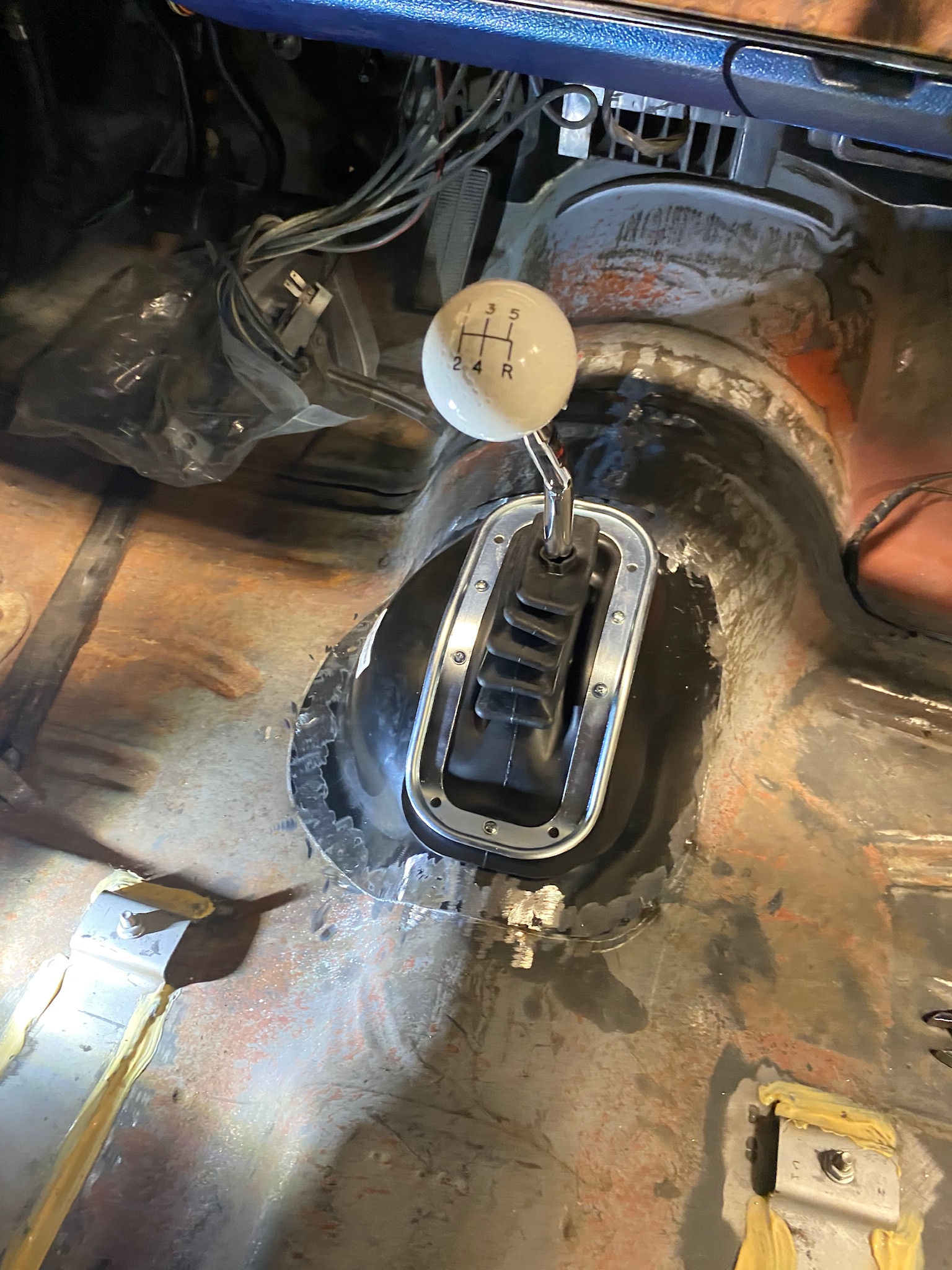

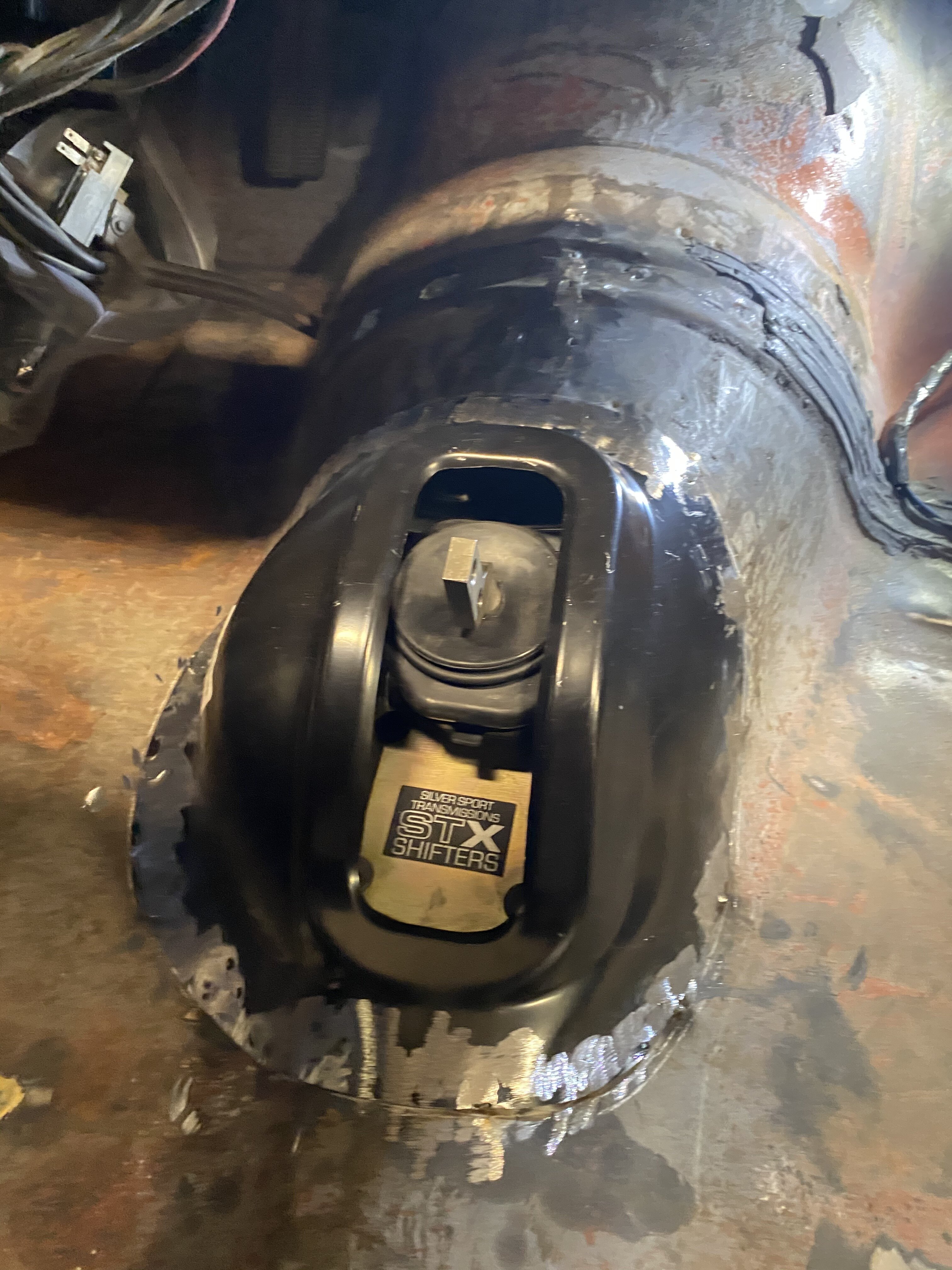

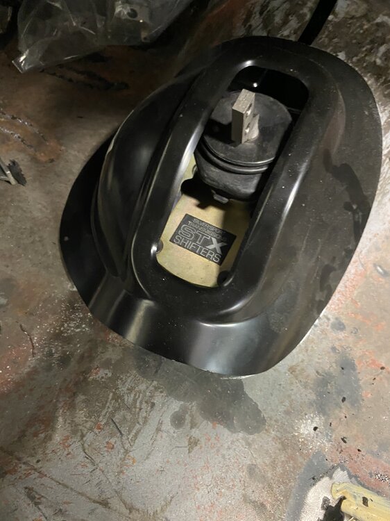

How did the transmission fit in the tunnel? It looks like you did not have to do any modifications. Were you able to use the original transmission crossmember? What are you going to do with the back drive ride that locks the steering column? Reason why is I am thinking of doing the same upgrade to my 1970 four-speed car.
John S
No modification on the tunnel. 5 speed fit right in. Had to use sst crossmember. 6 speed is a different animal. Very big trans. Tunnel would have to be completely taken out. I figured I didn’t need another overdrive gear.

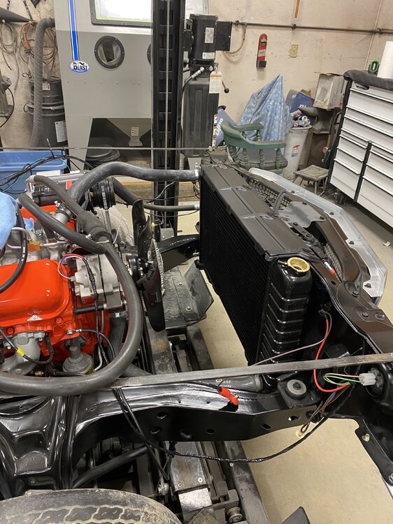

Just a note, I would cover the radiator opening to keep mice out.
