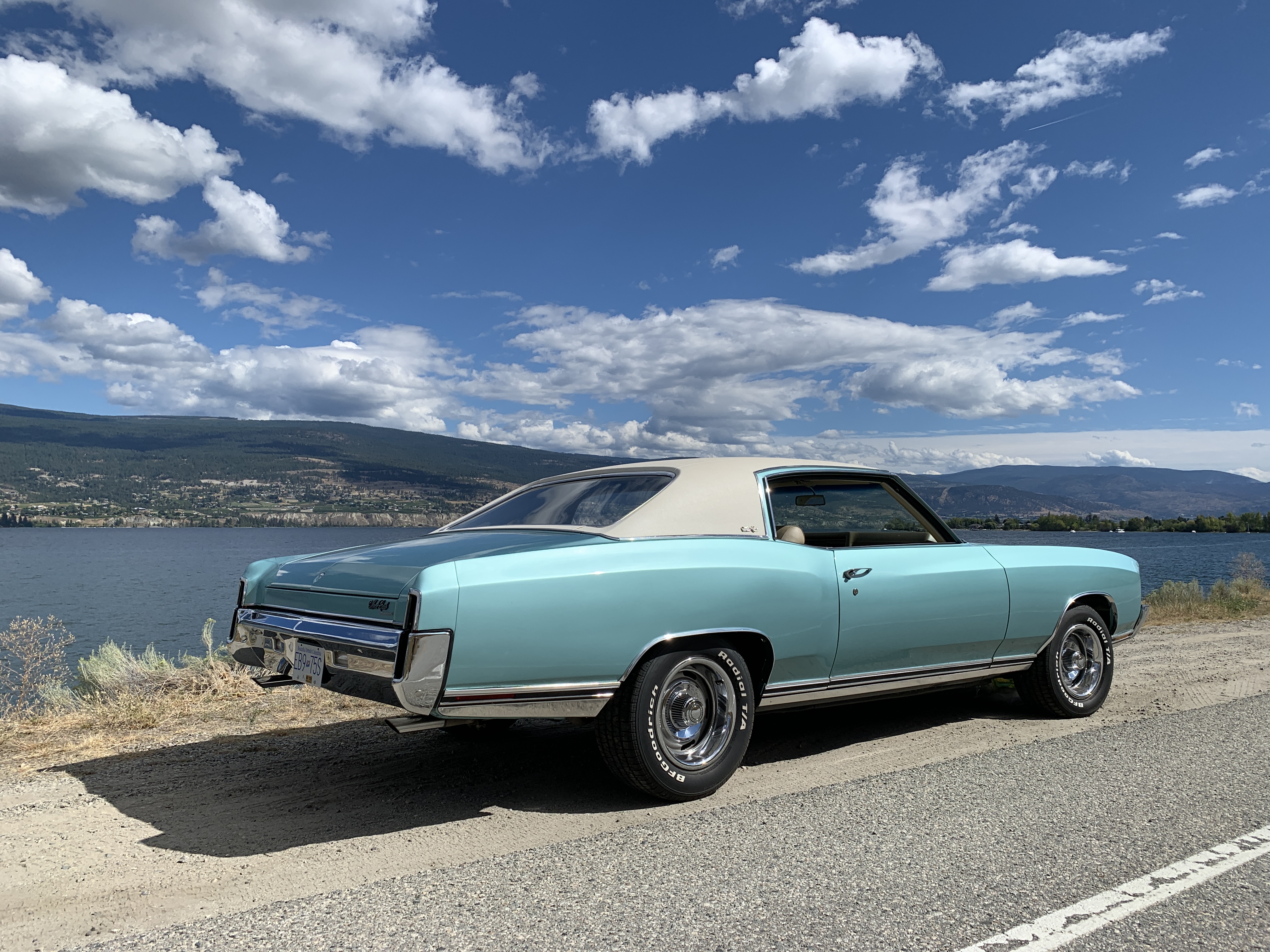

Bill Henry Posted May 18, 2021 Share Posted May 18, 2021 She got some new shoes over the weekend. 😎 8 Quote Link to comment Share on other sites More sharing options...

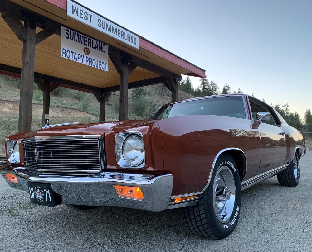

Canuck Posted May 18, 2021 Share Posted May 18, 2021 I’ve seen three first gens in less than a week with new Cooper Cobras including mine. 🙂 1 Quote Link to comment Share on other sites More sharing options...

1970mcss Posted May 19, 2021 Share Posted May 19, 2021 Bill, they look great. What size did you go with? Quote Link to comment Share on other sites More sharing options...

Mikstudie Posted May 19, 2021 Share Posted May 19, 2021 19 hours ago, Canuck said: I’ve seen three first gens in less than a week with new Cooper Cobras including mine. 🙂 Cooper Cobras on mine too, your new tires look great... Quote Link to comment Share on other sites More sharing options...

Bill Henry Posted May 26, 2021 Author Share Posted May 26, 2021 On 5/18/2021 at 8:06 PM, 1970mcss said: Bill, they look great. What size did you go with? They are 245/60R15 on 15x7 rallies😎 1 Quote Link to comment Share on other sites More sharing options...
