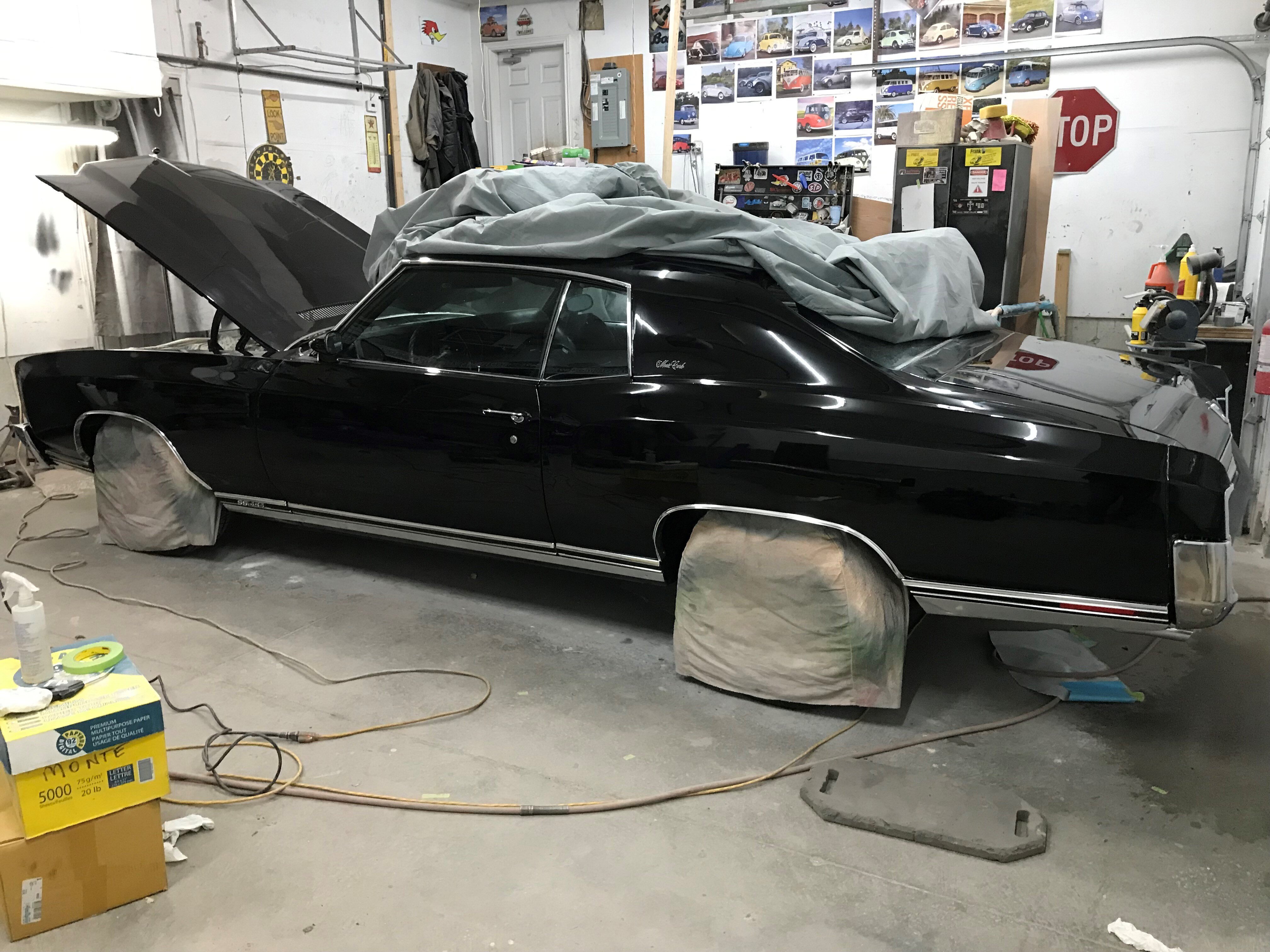

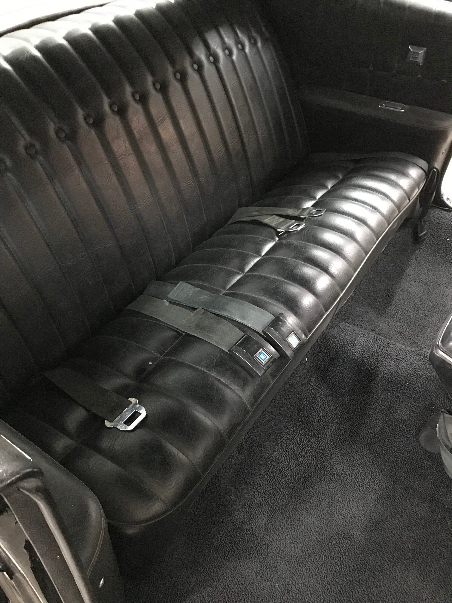

Finished cutting and buffing tonight. Then we installed the panel and insulation behind the rear seat and installed the rear seat back. Next will be installation of ACC carpet with mass backing. We have an awl and soldering iron ready for the install of the carpet. :)

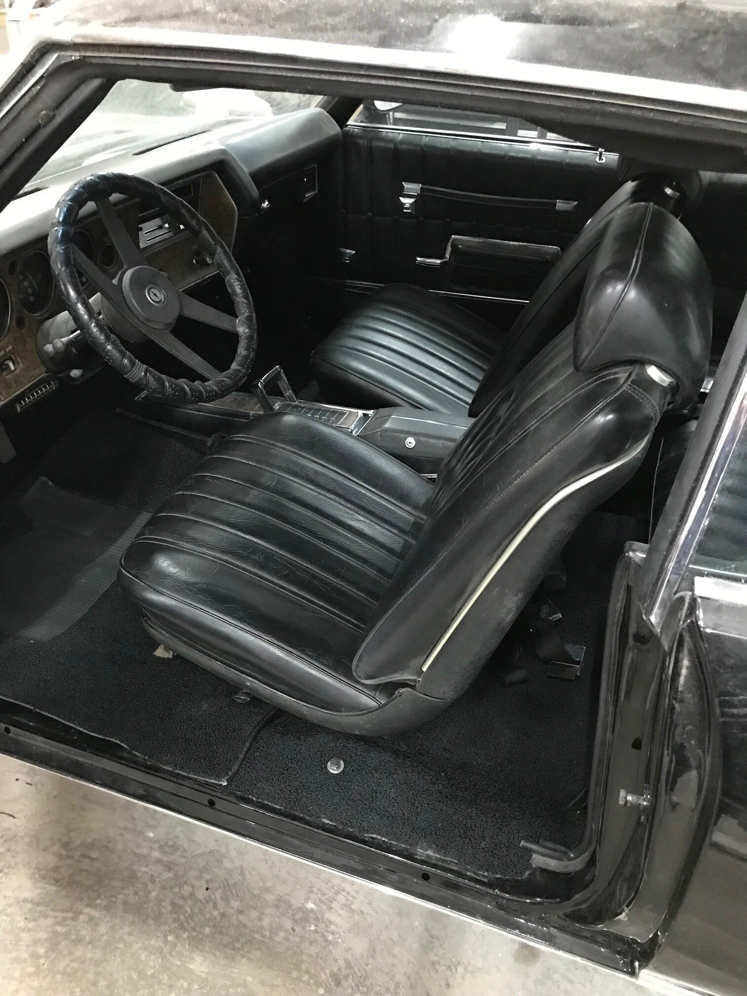

Carpet install began last night and will continue tonight. An awl works well for locating holes and a straight soldering iron is perfect for making holes. It melts a nice round hole and cauterizes the edge so it won't frey etc. It is also fast and easy.

Hi Jared, I checked my photo dates.....it sat for a week before we started the cut and buff....final clear was sprayed June 23rd and cut and buff began June 30. It has five coats of a high quality clear on it.

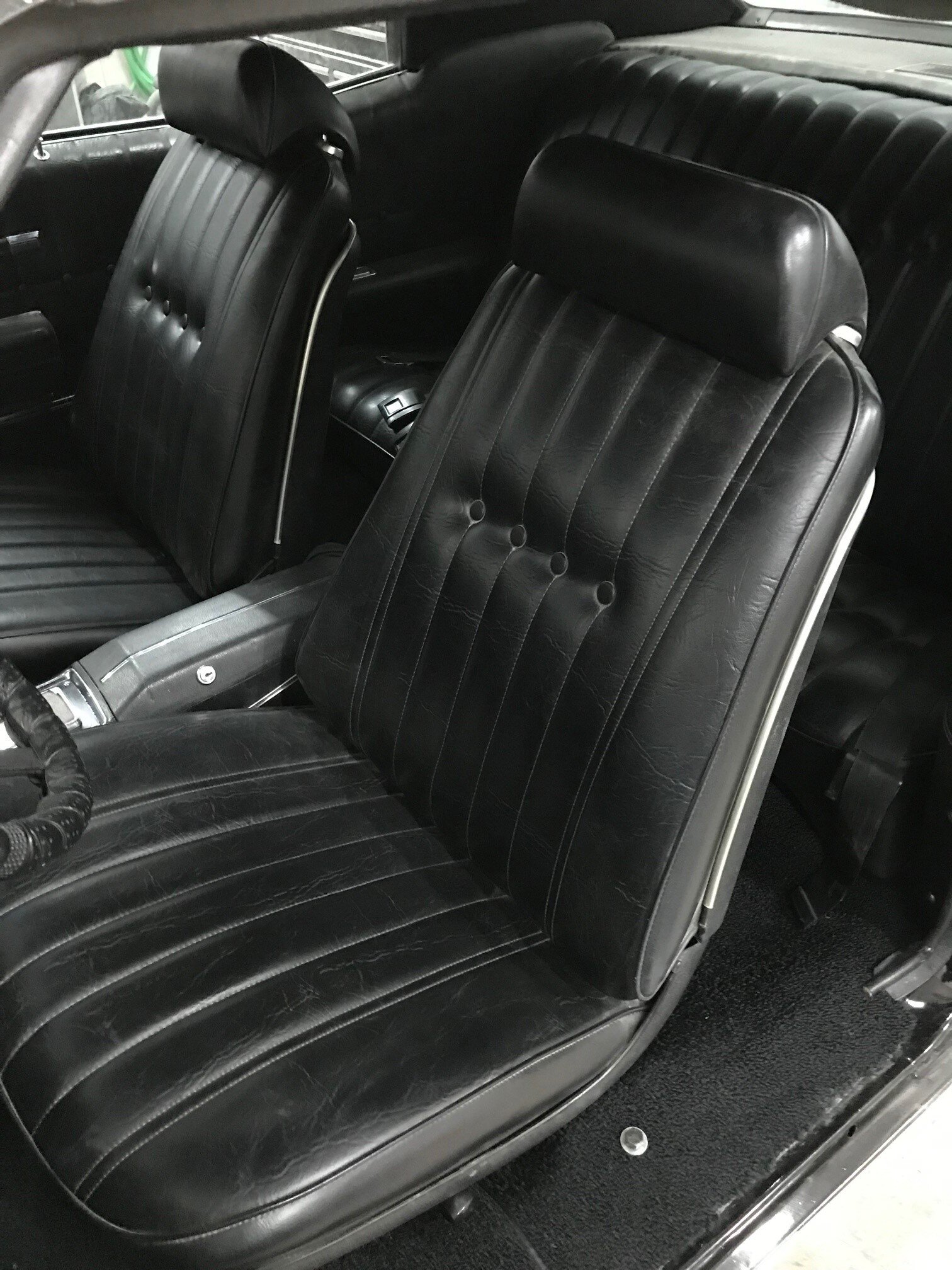

Update....all the seats, console, kick plates and seat belts are installed as well as the dimmer switch. I really took my time installing the carpet as I didn't want to make any wrong cuts etc. Next is to trim along the sills and install the NOS sill plates. She's a dusty old girl right now but I'll be doing a complete detail when everything is done.

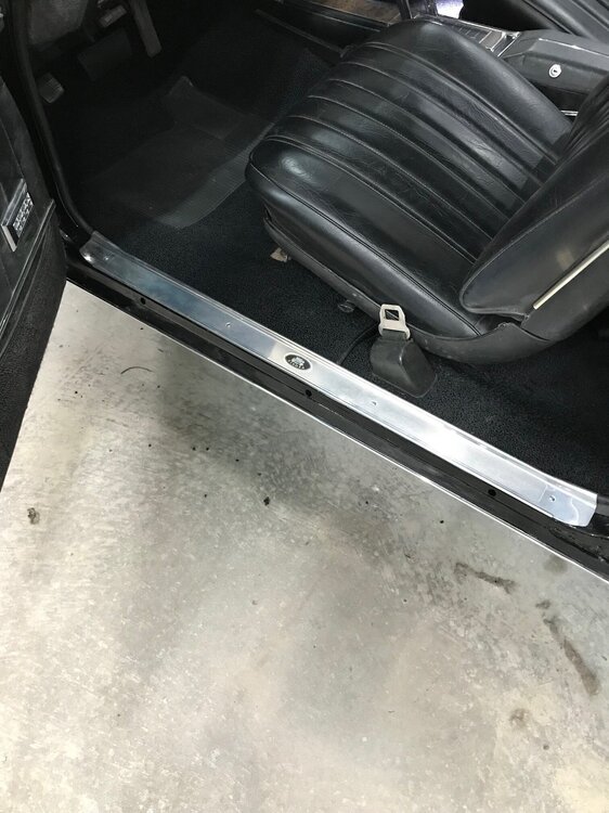

Update.....last night we trimmed the carpet at the sill plate area, installed the sill plates and the rest of the seat belts. One slip with the utilty knife and I now have an ouchie! LOL Getting close to the finish line except like others have said "they're never truly finished" :)

Love the electric tape ( car too by the way). I’m a fan of duct tape and paper towels. I know that you put nos sill plates on, my question is why don’t the nos sill plates have the rivits by the emblem?  Yours are not the only ones that I’ve seen this on. If they are on yours I apologize I can’t blow up the pictures and still get them clear.
