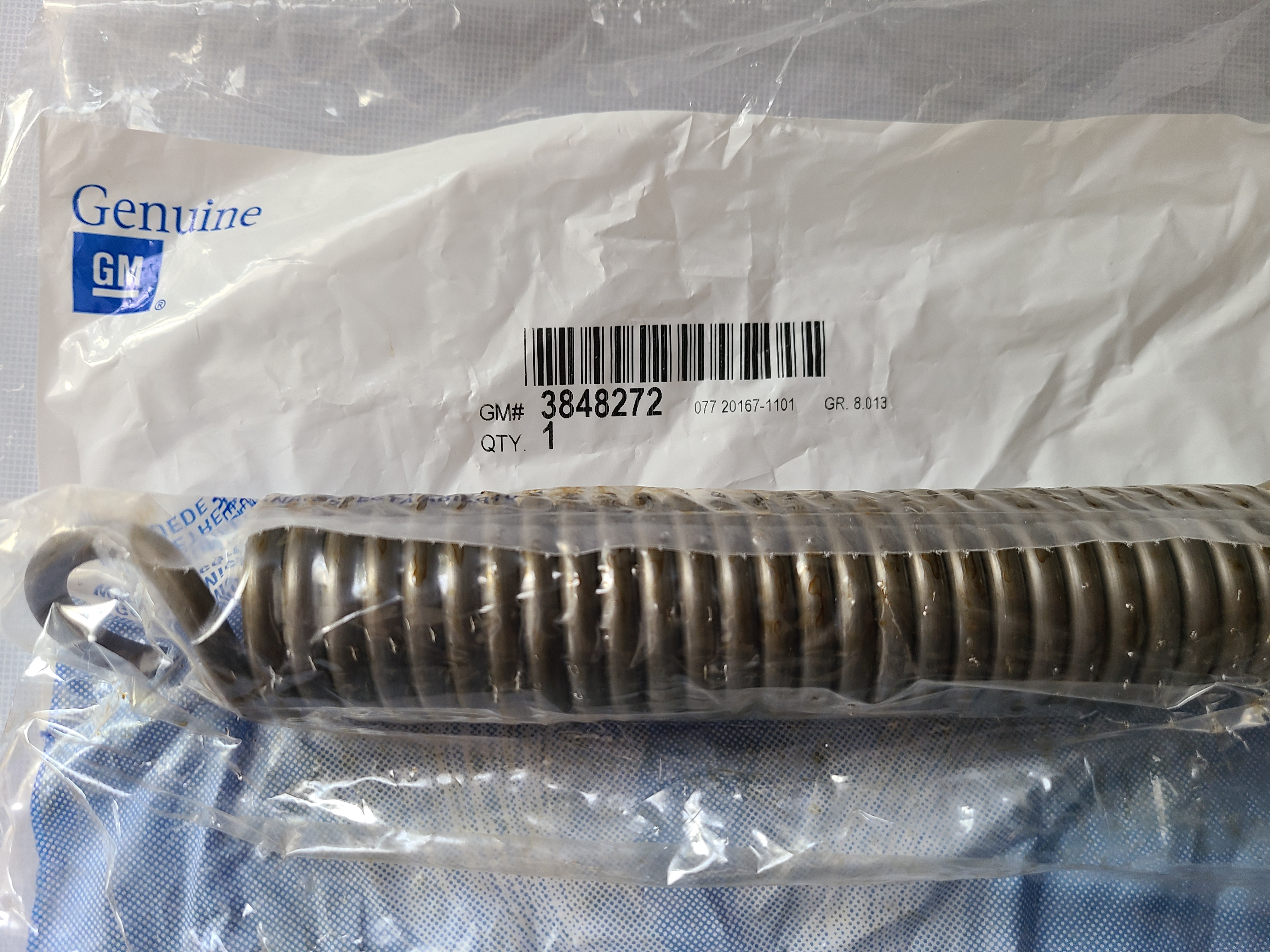

GM still makes hood springs that are a specific part for our application. They go for about $18 a piece and can be picked up at any GM dealer. The part number is: 3848272.
Yes....those are the ones available through Year One as well.

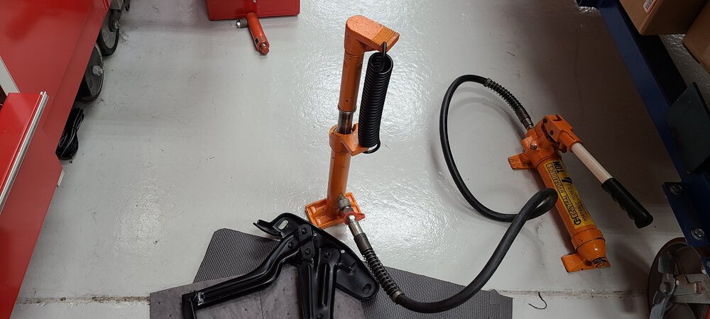

Now do you have any tips on installation?
I use a port-a-power to hook on the spring to expand it. This will work both on & off the car. I used to use a J-hook I made up from 1/4" stainless rod, but this seems much easier and safer to me.

i put on a pair of new in the bag gm 3848272 springs still have to use prop rod to keep hood open ?
That's odd. I put them on my car last year because the originals wouldn't hold it up any more. The new ones work great and even allow me to open it about half way if I want.

I paid 15.50 each from the gm dealership. 27 in stock at gm warehouse.
