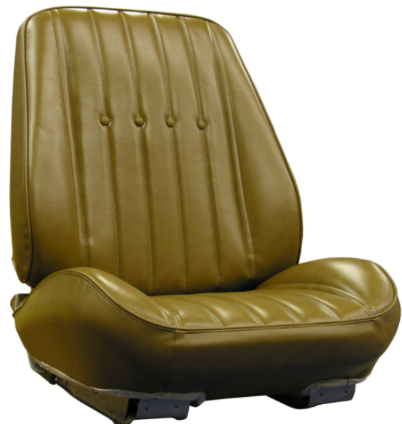

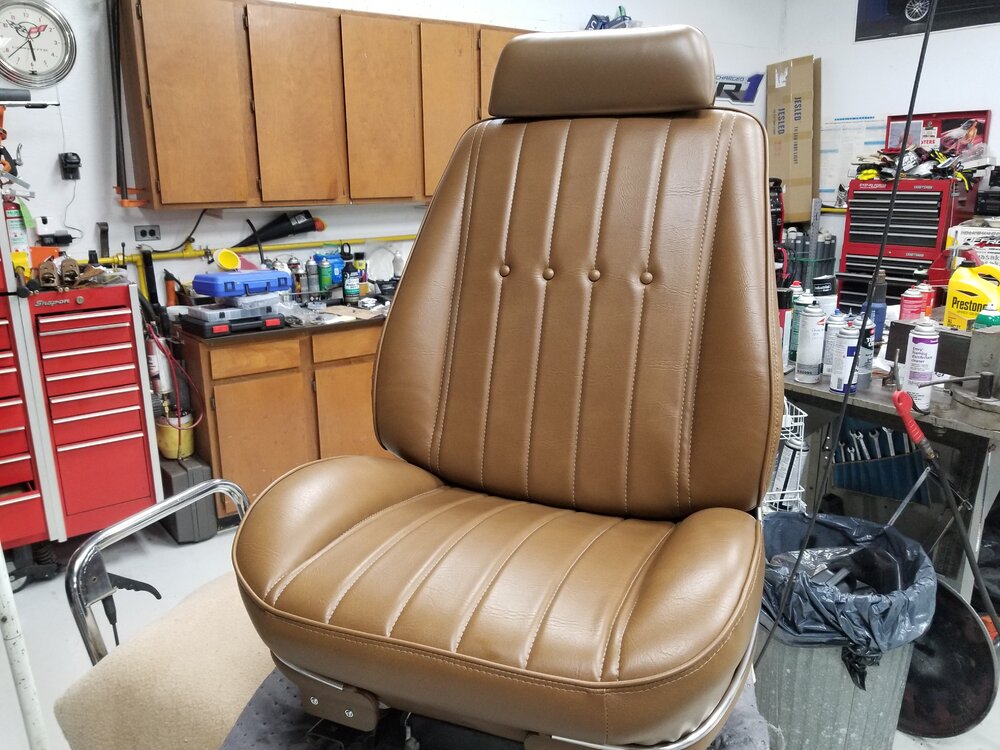

I kind of like the standard buckets with the Legendary rally seat conversion. Not as wrap around as true track ready seats but look somewhat stock and no mods needed except in your case need to add the bucket seat mounts.
Don't buy this color.
What are you trying to say, my Legendary Rally seats are ugly?
Truth be told, not my favorite color either, but black on black wasn't an option this time around, lol. Way more comfortable than the stock ones and like you basically said, unless you're looking for it, barely noticeable to most people.
