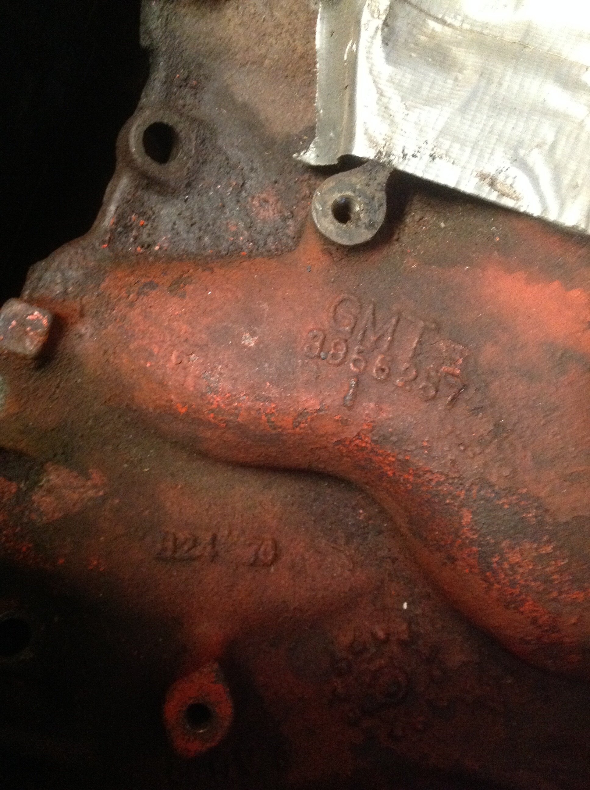

1970mcss Posted January 20 Share Posted January 20 It should be plug and play if you have a stock manifold. This is a picture of the part number of my stock manifold. The choke pull off screws to the manifold. The choke is manual. 1 Quote Link to comment Share on other sites More sharing options...

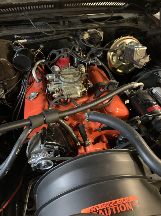

MC1of80 Posted January 20 Share Posted January 20 Here is a pic of the original rebuilt carb on "Barn Find" my 71 402 car. You can see the new choke thermostat mounted to the factory intake. I hope this helps. 1 Quote Link to comment Share on other sites More sharing options...

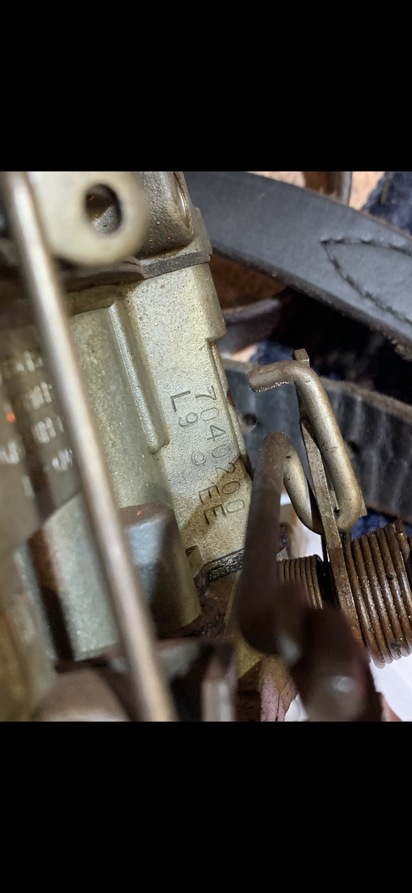

John S Posted January 20 Share Posted January 20 1 hour ago, sendo said: what should the date code be? and is this just plug and play? think my manifold is stock, what about the choke? thanks, sorry for all the questions My earlier post for carburetor number was incorrect. My number is 7040203. 70 is prefix code, 4 is year (1970 to 75), 0 is year (1970), 2 is model (Quadrajet 4BBL), 0 is division (0,1,2,) Chevrolet division, 3 is transmission, odd #s manual transmission, even #s automatic transmission. Here is picture of carb# and date code J9 September 1969. DB is a Broadcast (customer) code. Quote Link to comment Share on other sites More sharing options...
sendo Posted January 20 Author Share Posted January 20 14 minutes ago, John S said: My earlier post for carburetor number was incorrect. My number is 7040203. 70 is prefix code, 4 is year (1970 to 75), 0 is year (1970), 2 is model (Quadrajet 4BBL), 0 is division (0,1,2,) Chevrolet division, 3 is transmission, odd #s manual transmission, even #s automatic transmission. Here is picture of carb# and date code J9 September 1969. DB is a Broadcast (customer) code. so your carb date is sept 1969 what is your car built date? Quote Link to comment Share on other sites More sharing options...
John S Posted January 20 Share Posted January 20 58 minutes ago, sendo said: so your carb date is sept 1969 what is your car built date? Third week of November 1969. The carburetor is not the original carburetor for the car, it is however, close enough for me to date correct, and code correct. The carburetor came off of a 1970 Chevelle with a 350 and 4 speed. The carburetor on the car when I bought it was Rochester Quadra jet from a 1969 truck, I still have it. I try not to be too fussy about that stuff I simply got lucky when I found the carburetor. 1 Quote Link to comment Share on other sites More sharing options...

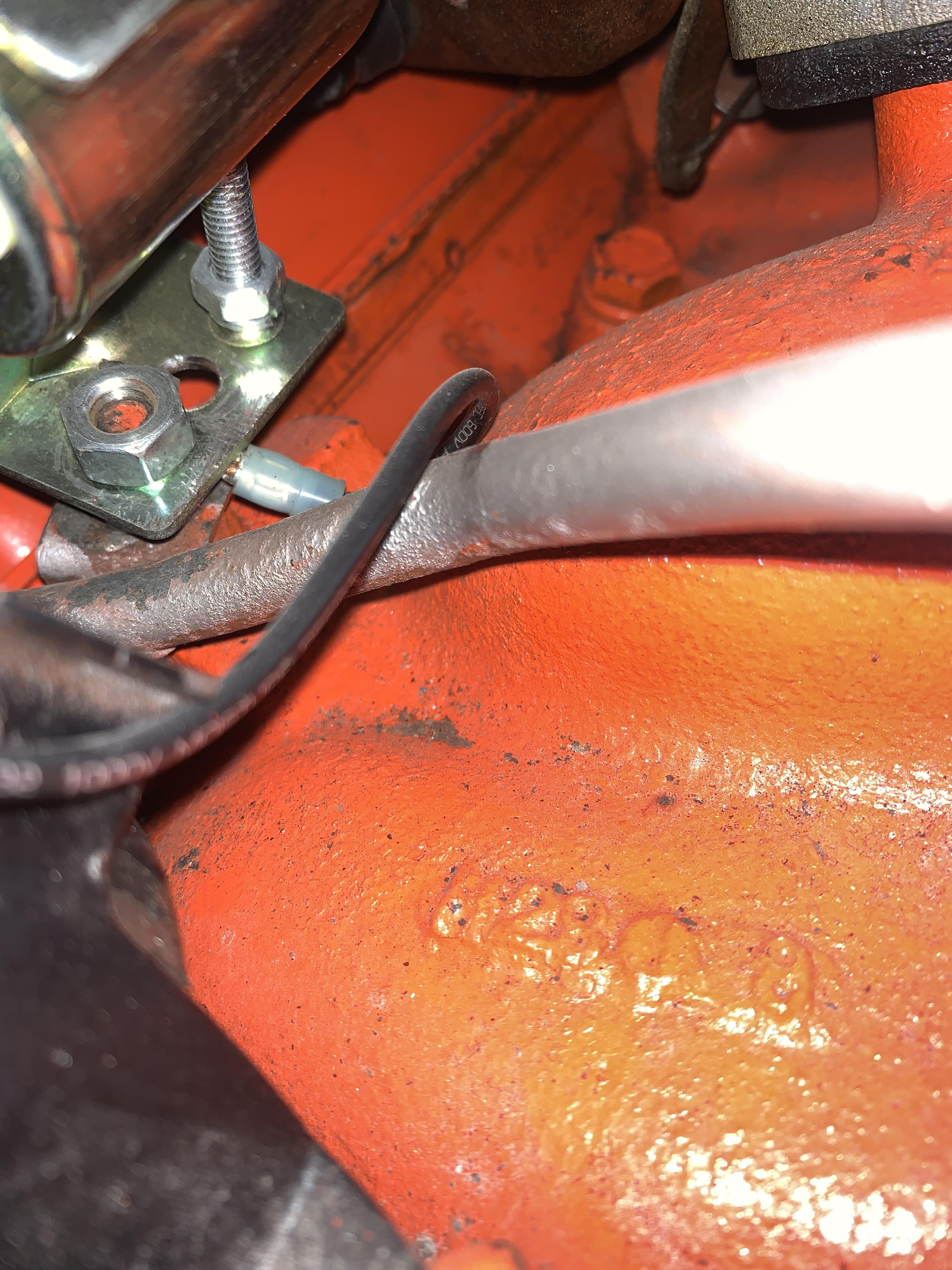

sendo Posted January 21 Author Share Posted January 21 2 hours ago, John S said: Engine code T1106CNJ Tonawanda November 6 is this the number in the front of the engine? mines was machined off, i found these in the back is there anywhere else to look? Quote Link to comment Share on other sites More sharing options...
John S Posted January 21 Share Posted January 21 10 minutes ago, sendo said: is this the number in the front of the engine? mines was machined off, i found these in the back is there anywhere else to look? I think on a big block there is a partial Vin number stamped by the oil filter I could be wrong I’m sure some knowledgeable big block guys would know for sure. Quote Link to comment Share on other sites More sharing options...
sendo Posted January 21 Author Share Posted January 21 yes saw that one, was looking for engine build date Quote Link to comment Share on other sites More sharing options...
MC1of80 Posted January 21 Share Posted January 21 When your 454 was rebuilt the surface was "decked" and the original vin and engine code were removed. A 512 block, the last 3 in the block part number, would have been used in 1970 for a 454. You can look for the head(s) casting date and part number under the valvecovers. Also the intake casting date if you feel they are original to the car. Quote Link to comment Share on other sites More sharing options...
