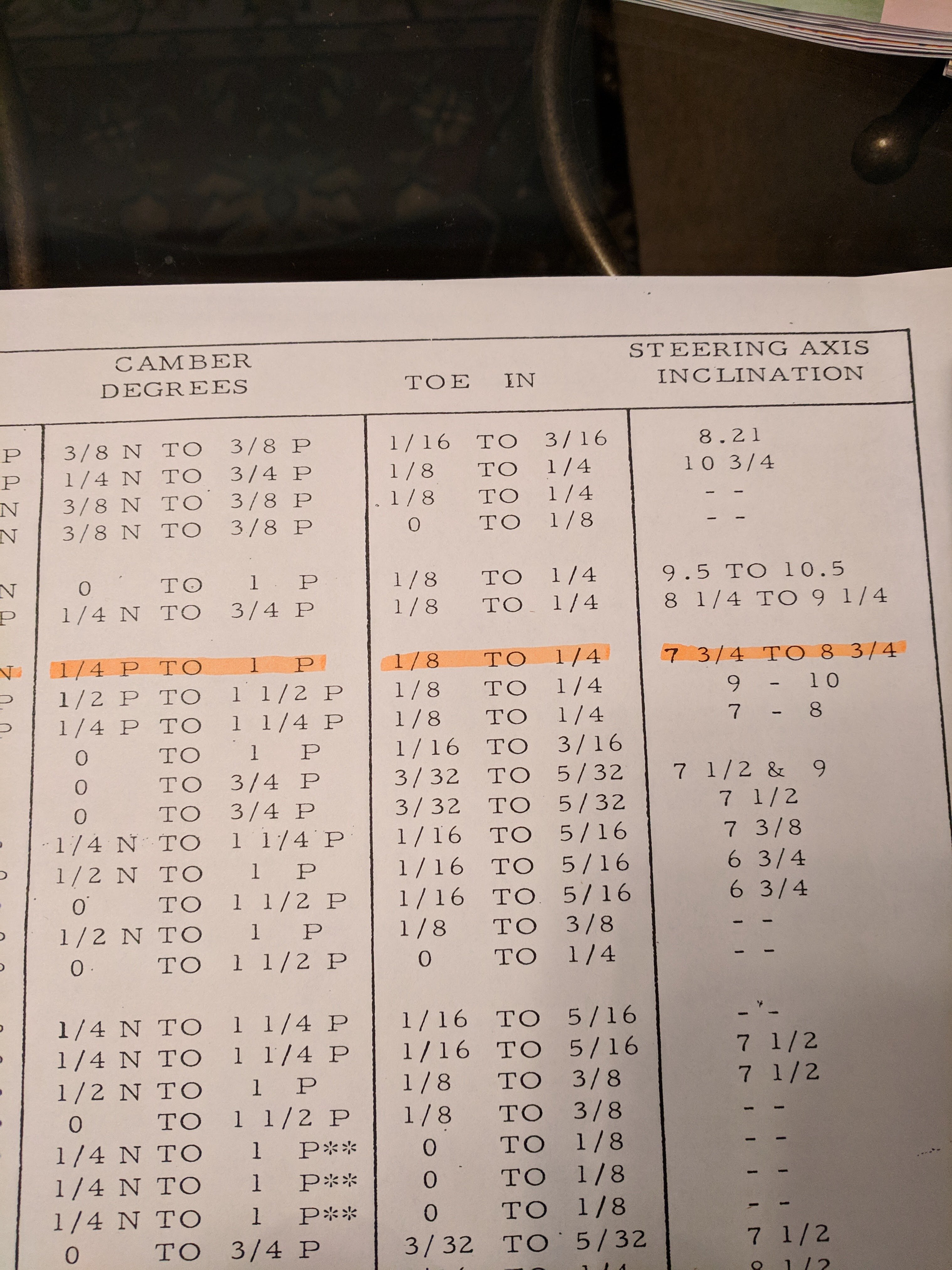

MC1of80 Posted January 15, 2022 Share Posted January 15, 2022 Paul, I hope this helps. Quote Link to comment Share on other sites More sharing options...
Crom Cruach Posted January 16, 2022 Author Share Posted January 16, 2022 Awesome, thanks Thomas negative caster isn’t that unusual? 1 Quote Link to comment Share on other sites More sharing options...

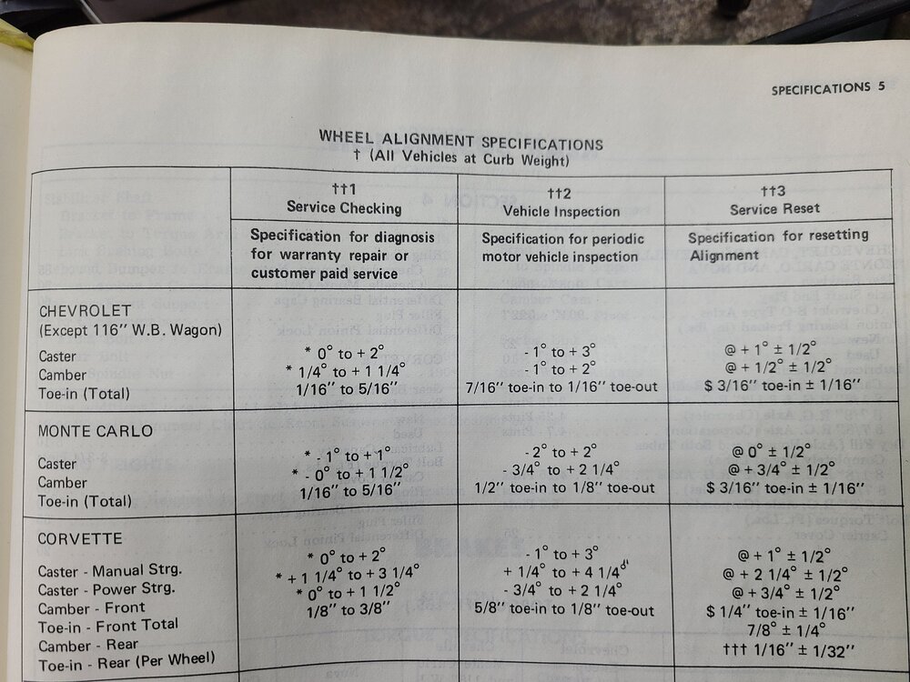

jft69z Posted January 17, 2022 Share Posted January 17, 2022 Just to confuse you more, this is from the 72 factory service manual. I'm guessing it's not too different from a 71. There were some footnotes at the bottom of the page that may be helpful too. Quote Link to comment Share on other sites More sharing options...
Crom Cruach Posted January 17, 2022 Author Share Posted January 17, 2022 That’s great Joe, thanks. In summary, for a ‘72, the Specification for resetting Alignment is: Caster 0° (± 1/2°) Camber + 3/4° (± 1/2°) Toe-in 3/16" toe-in (± 1/16") *CASTER and CAMBER must not vary more than ½° side to side: *Toe setting must always be made after caster and camber Quote Link to comment Share on other sites More sharing options...
jft69z Posted January 17, 2022 Share Posted January 17, 2022 Yep, that's what I'd use, the 'Service Reset' numbers. Quote Link to comment Share on other sites More sharing options...
