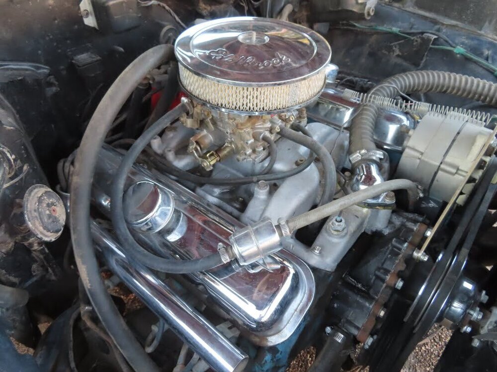

JP_AstroMan Posted February 21, 2022 Author Posted February 21, 2022 You make a good argument, 420. So you think that light green on dark green was a good combo? There is definitely surface rust at the top of the windshield. Probably need to yank it and the rear. Well, on a positive I also recently removed the original headliner that a mouse destroyed. Looks like replacing it will be easy with the windows out. So check this out folks- I got WAGON FEVER and just bought a 1969 Pontiac Lemans wagon today. Mega fixer upper but will be a blast. I love these cars with wide tires all around, lowered a little, just a total future hotrod. Coming all the way from Tucson. Has a 400 in it that I will pull and add HP to. 3 Quote
MC1of80 Posted February 21, 2022 Posted February 21, 2022 Cool wagon! We know Pontiacs also!! Very well! Lol My son has a 69 GTO- 400 4spd convertible that used to be Kevin's. Has a lemans bumper on it now. 2 Quote
