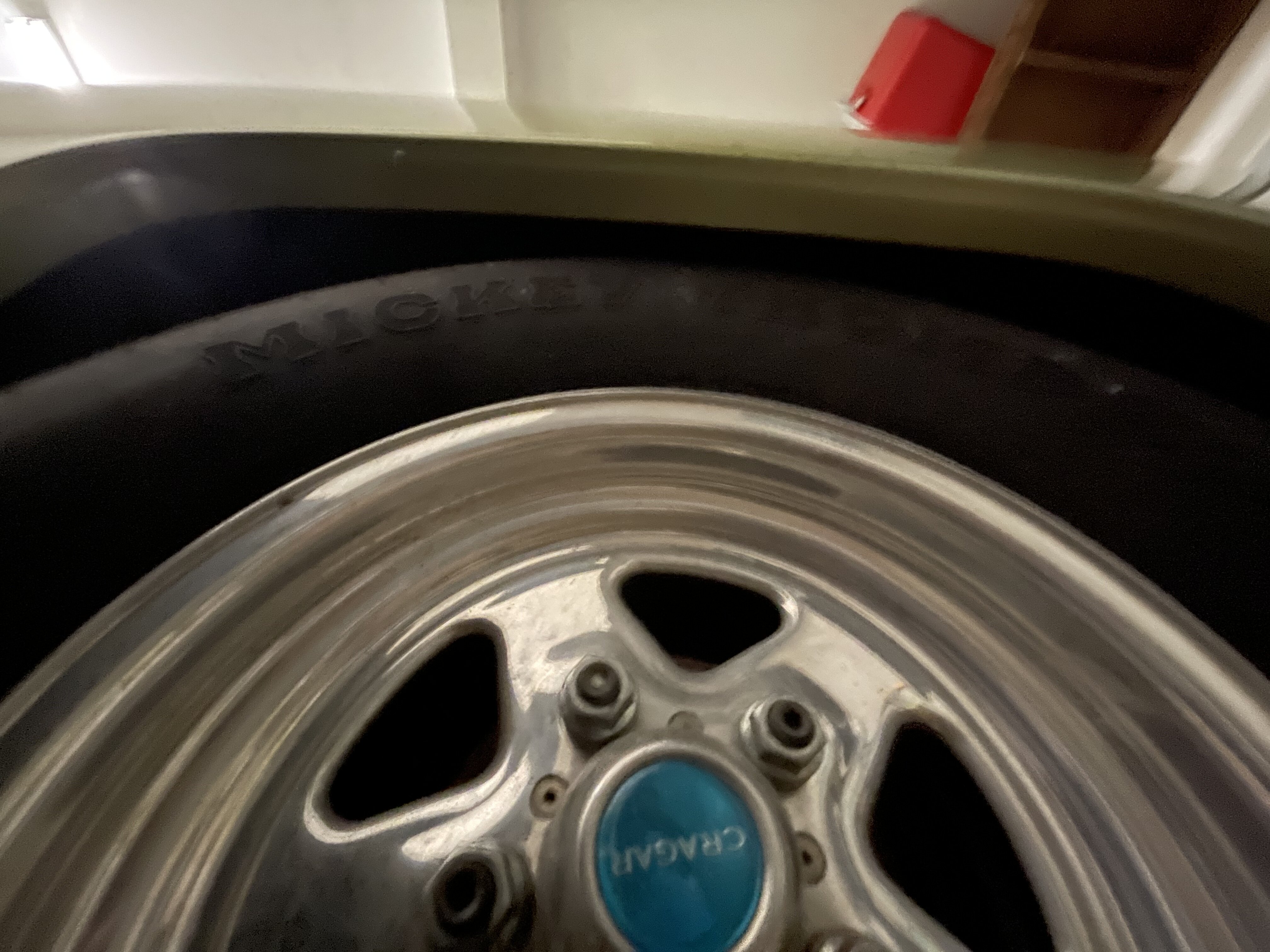

They should fit no problem. That’s the exact set up I have on my car. They are cragar 15x8 4.5 backspace with Mickey Thompson e/t streets in 275/60r15. Didn’t even have to trim the inner lip. The inner side of the tire has about an inch of clearance or more , it’s not even close.
