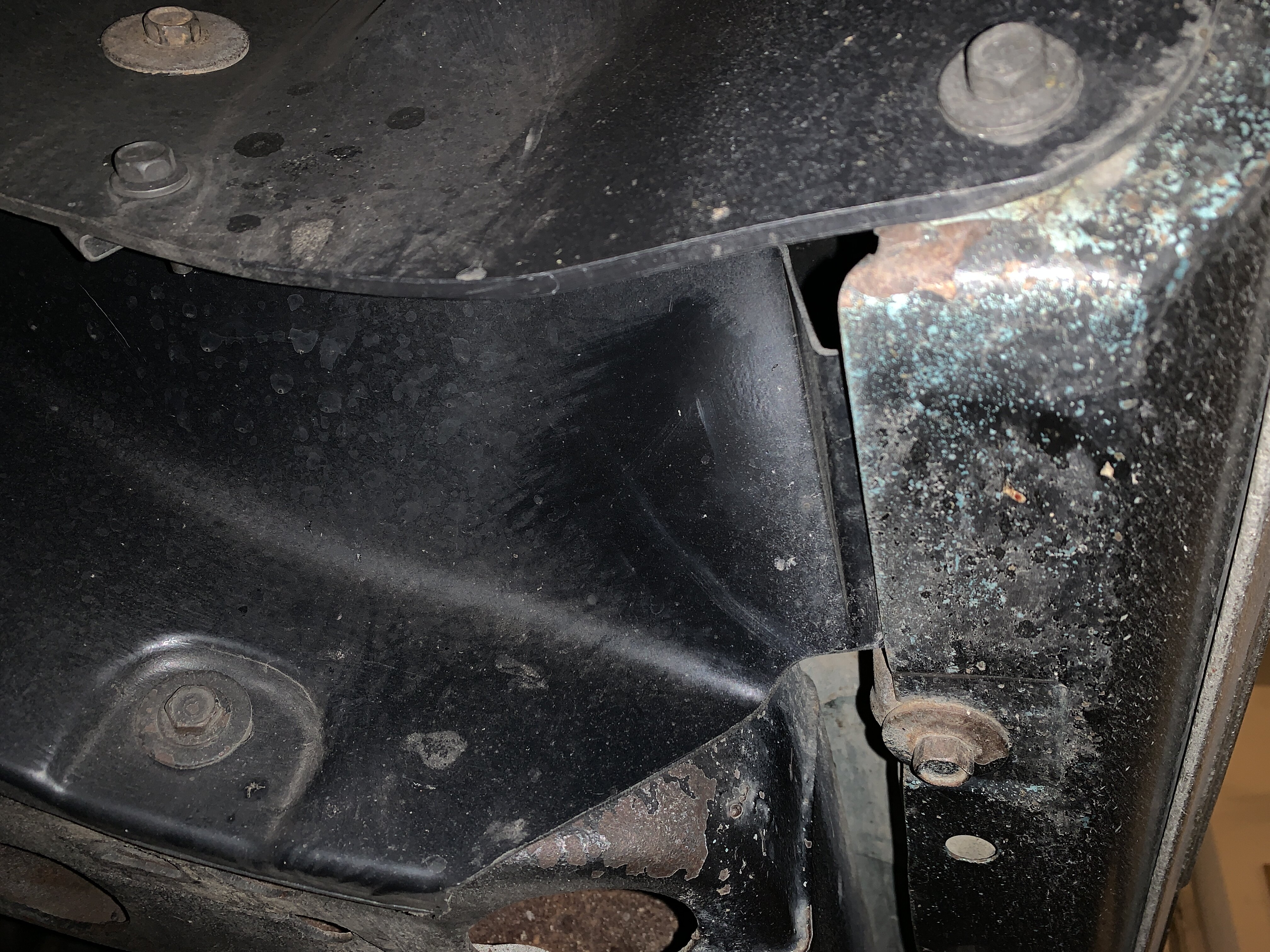

The other problem today was went to install the lower fender shields from the parts place and they do not fit very well, afraid they will break if I bolt them in as they are. Do you heat them to reshape or slot the holes?

As for the lower fender shields, do you have any photos ? Not sure what you're trying to fit together...
