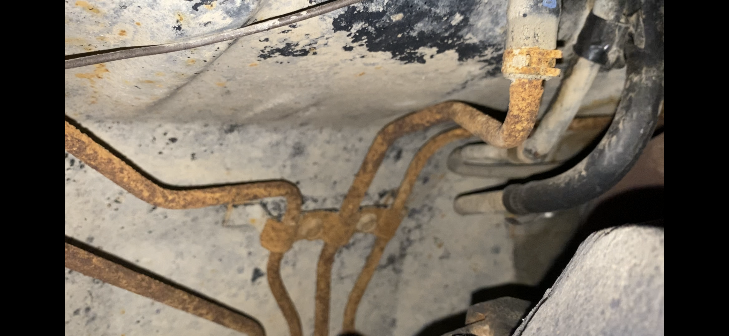

Ok lads, based on Stangeba’s (very useful) diagram, those three hoses are metal, and are the same three I see in this photo…
so the two rubber hoses (in my first photo) go to the pump, and return from condenser, is that right? Could explain my intermittent stuttering engine issue if the corroded one is to the pump.
Could explain it but as ugly as they are, if they are not leaking they are still doing their job. My bet is that you could probably eliminate ( I wouldn’t) the vapor chamber and it would run no different. I’m not sure on that but as long as you’re still venting to the vapor canister under the hood you would be good. Like I said I wouldn’t do it but I’m sure people have.

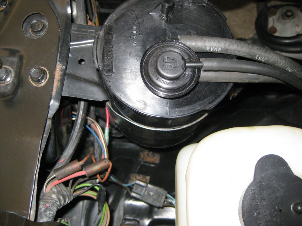

Yes, I still have it! The vacuum diaphragm (round thing on top) did have a leak so I bought a replacement charcoal canister with a new diaphragm. I think the large hose comes from the rear tank area, the small hose on top acts as an on / off switch allowing the fumes stored in this canister to be sucked into the running engine via the hose just below it.IMG_0644.thumb.JPG.0314371bf8a0c9b6468c5a4790284531.JPG

What vapor canister under the hood.....lol.
Where them two empty core support holes are. If I did mine like you did that would have ended up in the basement somewhere. Useless garbage.
