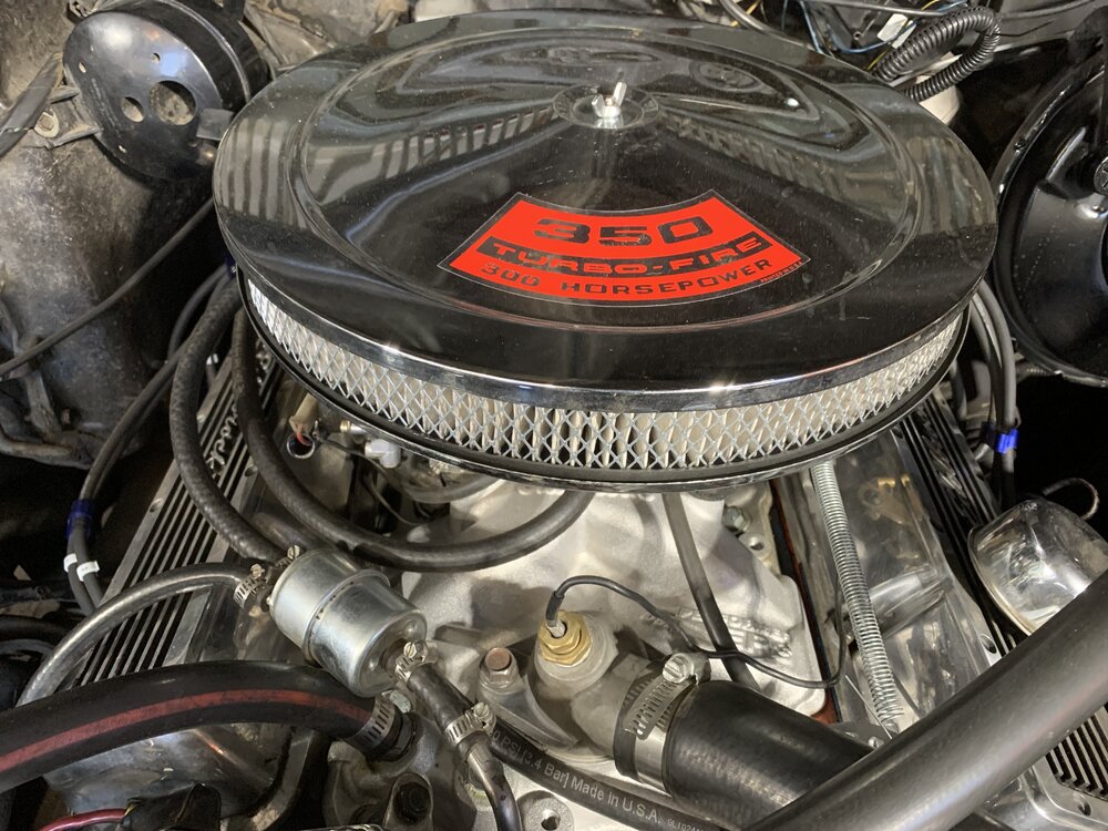

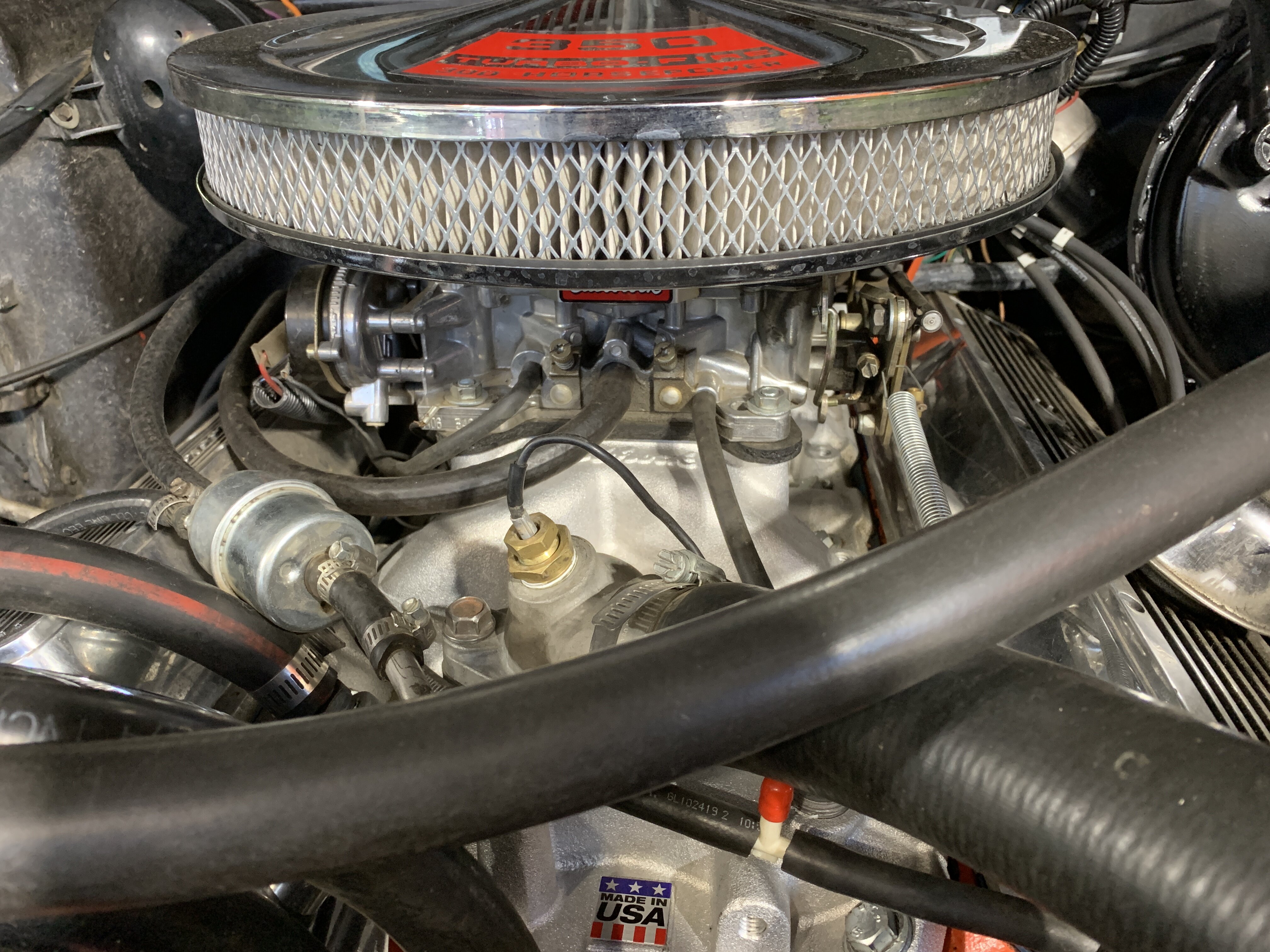

I did not go with the roller lifters. I purchased the top engine kit. It came with the cam, timing chains and gears, cylinder heads complete, air gap intake manifold and gaskets. I went with that just because everything is matched so there is no guess work. The only variable I am slightly concerned with is the height of the air cleaner after installation. That air gap is higher than I thought it would be. I still don't think its going to be an issue but I haven't made any rear measurements yet. Of course nothing is torn down yet either. I appreciate the input. I am trying to have the car ready for a show in June and I overbooked my time like a dummy.

I was using the Edlebrock performer and switched over to the Edlebrock EPS squarebore and the thicker gasket. Height was an issue,, but a thinner air filter solved my problem.. You can also lower the filter by changing the lower plate that fits over the carb. I puchased mine from a local performance store..

I have an RPM air gap, 1 inch spacer, Holley 950hp and stock air cleaner (Camaro style on my big block and NO hood clearance issues.
I had a 350 with performer (no rpm made yet, lol) 4" spacer, Holley 600 and 3" air filter with dropped base under the hood of my 1st Monte Carlo. Back in 86'. Lol

Because the Edelbrock carb has a different configuration than the Q jet, you'll have to watch for clearances under the air cleaner as well. I wound up buying a custom made base..... But a 1/2" spacer works too. A 2"-2 1/2" element is as big as you can go with the filter.

Luckily, I had no clearance problem with the drop plate under the air filter… I'm using an HEI distributer and it clears with a half inch to spare.   With the MSD ignition, clearance was really wide, but I had to move the coil. Didn't care for the MSD ignition anyway…

I was looking at the specs for the height of the two intakes. The old one and the new air gap looks to be about an inch difference. I don't have any clearance concerns now. I do have a inch spacer between the carb on the intake. I will imagine I won't need that anymore anyhow. I appreciate all the feed back. I am always impressed by the information that is out there. I would rather hear from someone that has been there, done that.
