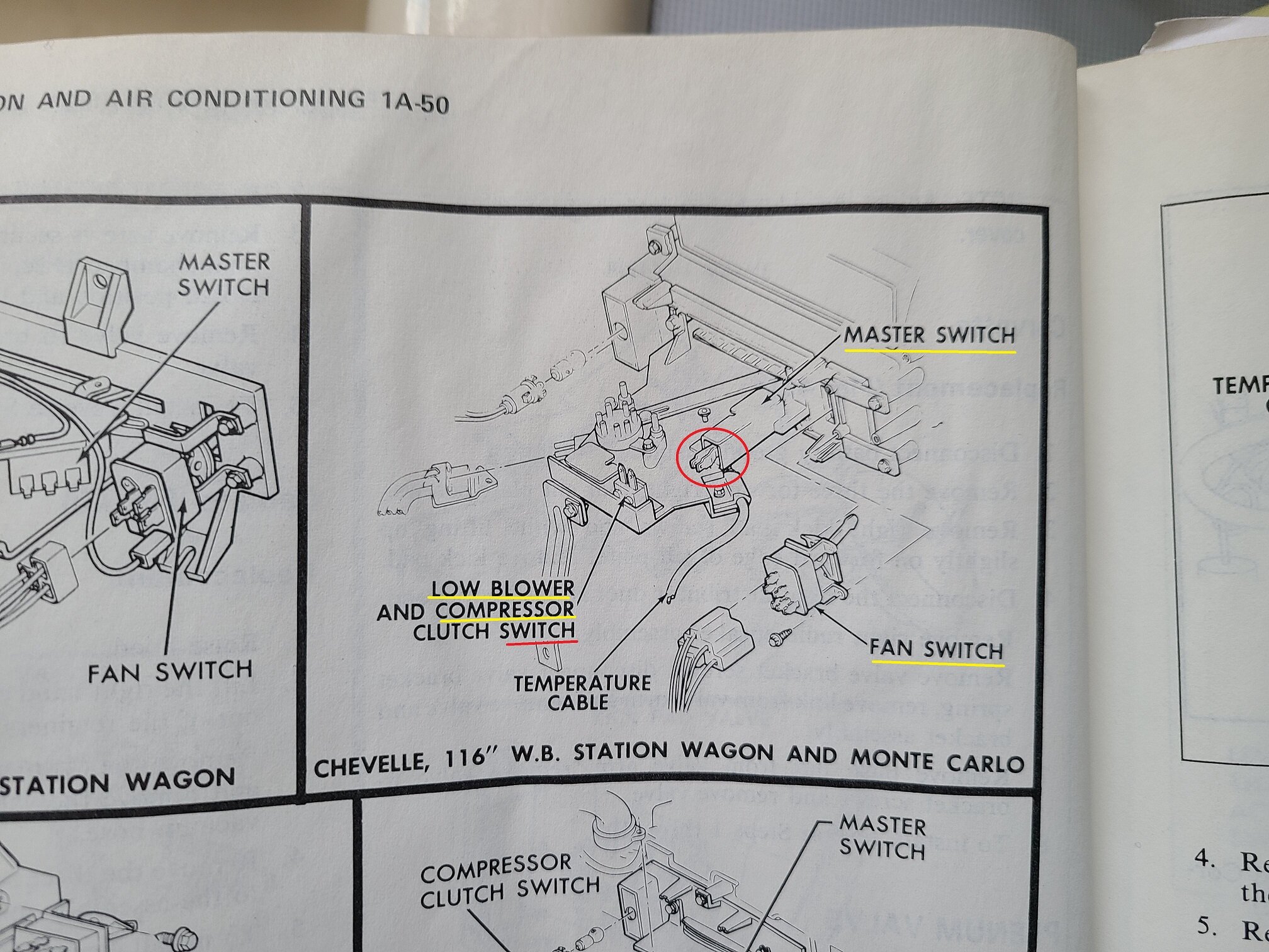

jft69z Posted July 4, 2022 Share Posted July 4, 2022 Something could be drawing excess current to be catching fire like that (compressor clutch or blower motor), dirty contacts/connections on the switches & old wires with high resistance could possibly cause heat (smoke) too. Check to make sure proper sized fuses are installed as well. Here are a couple of pics of the factory manual regarding HVAC. Disregard some of the highlights, they were from a problem someone else had. Quote Link to comment Share on other sites More sharing options...

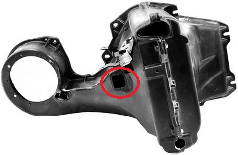

D.E Posted July 25, 2022 Author Share Posted July 25, 2022 where is the resistor that goes to the blower motor and to the fan switch.Got the switch last week will start to replace burned wires this week.Thanks for help Quote Link to comment Share on other sites More sharing options...
jft69z Posted July 25, 2022 Share Posted July 25, 2022 It's on the evaporator box, under the hood. Location circled in red. Quote Link to comment Share on other sites More sharing options...
D.E Posted July 25, 2022 Author Share Posted July 25, 2022 Thanks I heard that could be a problem with overheating of switch.Will check it out Quote Link to comment Share on other sites More sharing options...

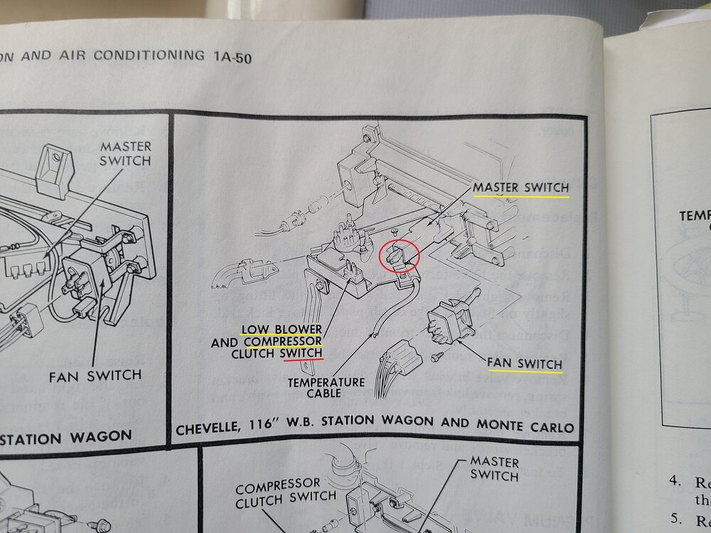

jft69z Posted July 26, 2022 Share Posted July 26, 2022 The brown wire is the power feed from the fuse panel, underlined in yellow on the schematic. Dennis may confirm, as we had this discussion specifically about that brown wire at the time, when I sent that marked up print to him. Quote Link to comment Share on other sites More sharing options...
