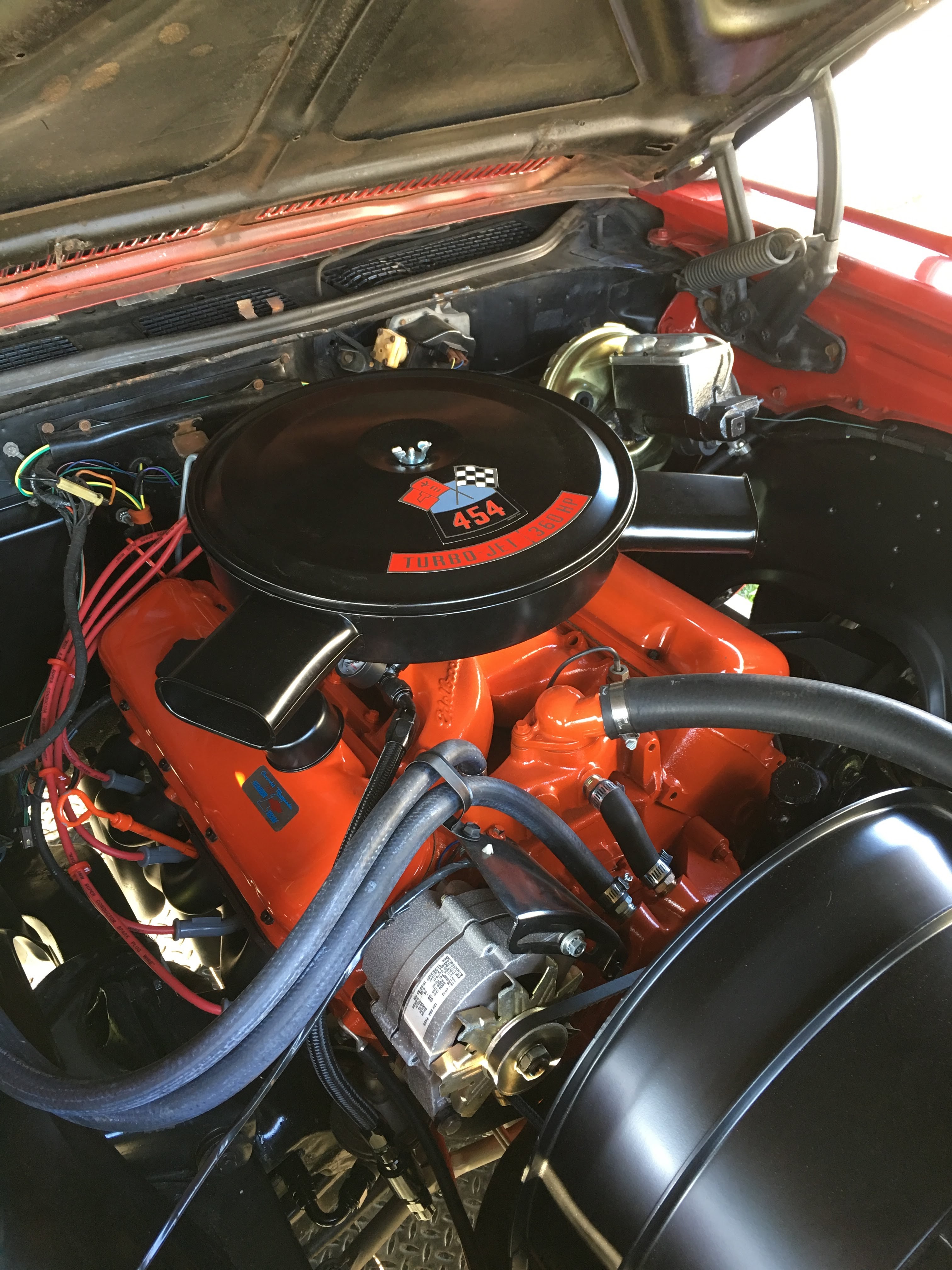

MC1of80 Posted September 3, 2022 Share Posted September 3, 2022 All Monte Carlos 70-71, small and big block had cubic inch and hp rating stickers on their air cleaners. The blue one is of my brothers 71 SS454 and the red one is "Big Red" my 70 SS454. Neither air cleaner is correct for the cars. The one on the blue Monte is actually a fairly uncommon dual snorkel one from a 70 bb Chevelle and the one on Big Red is an aftermarket one for a bb Camaro that fits a Holley carb. The 71 now has the correct 454 air cleaner assy on it. Quote Link to comment Share on other sites More sharing options...
