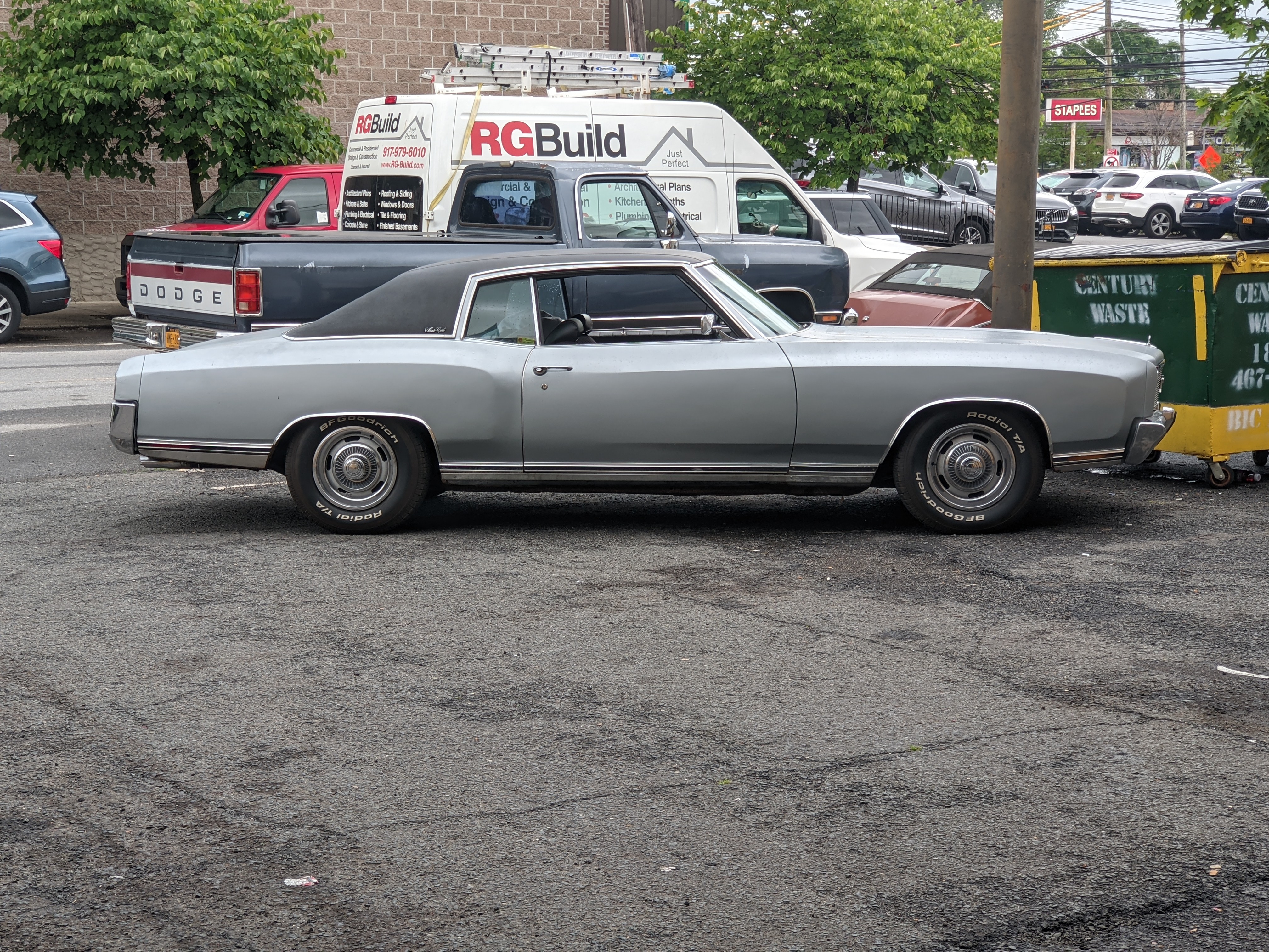

Rob Peters Posted October 14, 2022 Share Posted October 14, 2022 here is a picture from an original Ad of a 71 which may show you the rear height... you may be able to judge the height by where the wheel well crosses the wheel and tire. rob Quote Link to comment Share on other sites More sharing options...

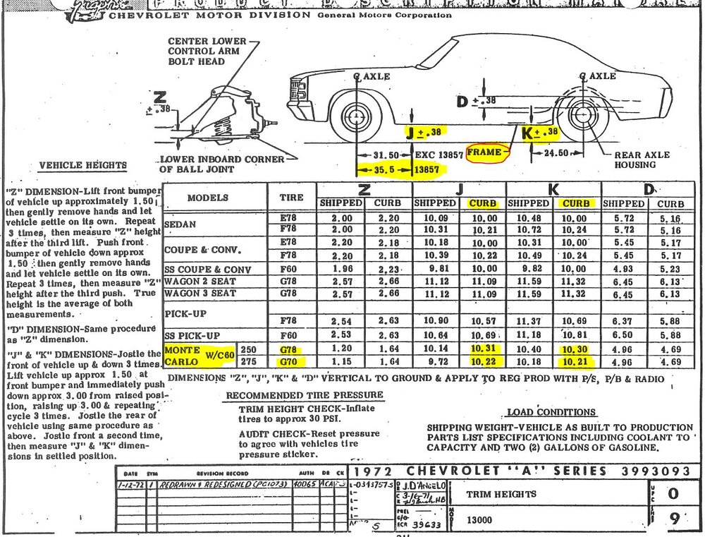

jft69z Posted October 14, 2022 Share Posted October 14, 2022 These pages are from the 1972 Factory Assembly manual. In the picture, 13857 corresponds to a Monte. trim height.pdf Quote Link to comment Share on other sites More sharing options...
LS65Speed Posted October 14, 2022 Author Share Posted October 14, 2022 There it is, cold hard numbers. THANKS ! Quote Link to comment Share on other sites More sharing options...
LS65Speed Posted October 14, 2022 Author Share Posted October 14, 2022 1 hour ago, Rob Peters said: here is a picture from an original Ad of a 71 which may show you the rear height... you may be able to judge the height by where the wheel well crosses the wheel and tire. rob Looks like there might be a typo in your link? Post after yours looks like it will give me what I need. Thank you! Quote Link to comment Share on other sites More sharing options...
jft69z Posted October 14, 2022 Share Posted October 14, 2022 18 minutes ago, LS65Speed said: There it is, cold hard numbers. THANKS ! You're welcome. 1 Quote Link to comment Share on other sites More sharing options...
LS65Speed Posted October 14, 2022 Author Share Posted October 14, 2022 20 hours ago, jft69z said: These pages are from the 1972 Factory Assembly manual. In the picture, 13857 corresponds to a Monte. trim height.pdf 1.76 MB · 19 downloads Joe Thanks to you again!  I do however have another question that needs to be answered in order to use the info you provided. Are the numbers quoted in columns "J and "F" measured from the ground to the frame, to the lower rocker panel, to the top of a piece of trim or the bottom of a piece of trim? Might be I am missing something that is right in front of my face. It wouldn't be the first time I did that. Maybe the assy manual has a footnote that is not on what you supplied to me? Maybe the info is right in front of me as I just said! Can you help out with this question? So far I have concluded that the cars sat approximately level bu looking at the numbers on the chart but I can't yet relate the chart to what is sitting in my garage. Ray Quote Link to comment Share on other sites More sharing options...
jft69z Posted October 14, 2022 Share Posted October 14, 2022 1 hour ago, LS65Speed said:    Are the numbers quoted in columns "J and "K" measured from the ground to the frame..., Maybe the assy manual has a footnote that is not on what you supplied to me? Maybe the info is right in front of me as I just said!  There are no other pages that relate to this, just what's shown. I'd use the Frame as the reference point, as circled in red. . Obviously, the tires you have on the car will make a difference, as they address with the 2 separate entries for size. Are all 4 of your tires the same size? Notice they give a fairly wide tolerance of +/- .38" too, that could be nearly an inch when comparing front to rear. (C60 means the car has A/C as well) I didn't check the factory service manuals, I'll look later, after dinner.  Quote Link to comment Share on other sites More sharing options...
LS65Speed Posted October 14, 2022 Author Share Posted October 14, 2022 53 minutes ago, jft69z said: There are no other pages that relate to this, just what's shown. I'd use the Frame as the reference point, as circled in red. . Obviously, the tires you have on the car will make a difference, as they address with the 2 separate entries for size. Are all 4 of your tires the same size? Notice they give a fairly wide tolerance of +/- .38" too, that could be nearly an inch when comparing front to rear. (C60 means the car has A/C as well) I didn't check the factory service manuals, I'll look later, after dinner.  Looking right at it and missed it! Shame on me. Quote Link to comment Share on other sites More sharing options...
jft69z Posted October 14, 2022 Share Posted October 14, 2022 13 minutes ago, LS65Speed said: Looking right at it and missed it! Shame on me. No worries, there's a lot going on in that page. Factory service manual has pretty much the same info & pictures, for the most part. Quote Link to comment Share on other sites More sharing options...

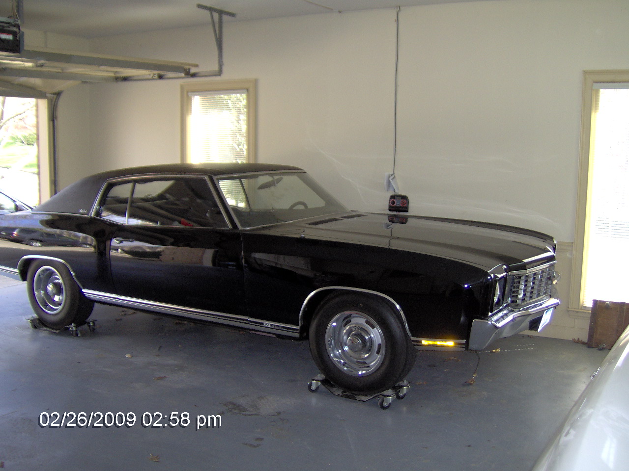

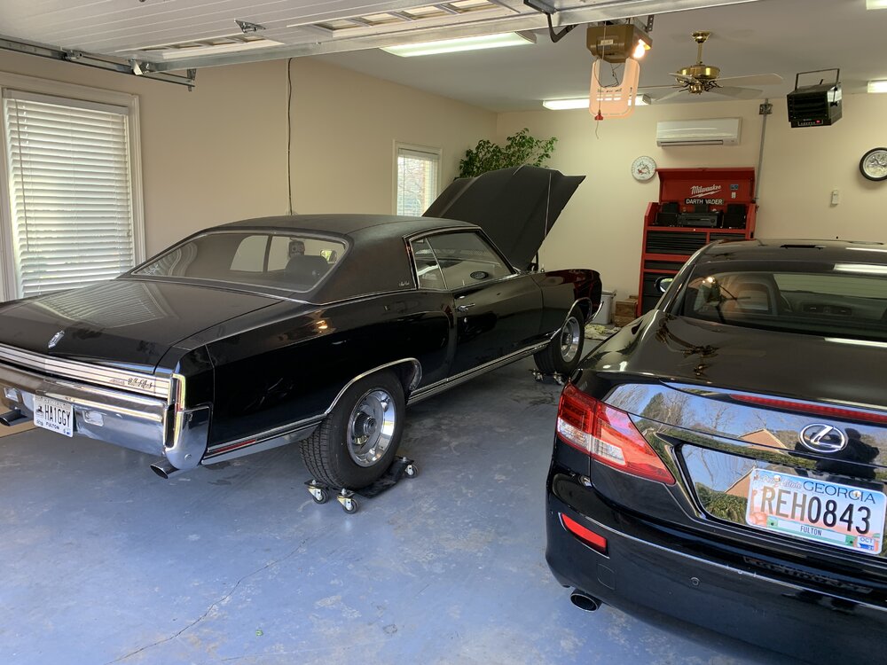

LS65Speed Posted October 15, 2022 Author Share Posted October 15, 2022 9 minutes ago, LS65Speed said: Lemmie check...stand by.  12 minutes ago, jft69z said: Any side pictures of how it sits currently? Not the best full side pics but here are a few. The 9 inch Ford install seemed to push the back up a little, I think because the spring pads might be just a bit higher than the factory rears. That said as I look at these pics I find myself wondering if this set of "push ups"related to the springs is necessary. None of the attached have the 9 inch rear installed. I want to get that trim around the wheel opening a bit further down on the siodewall, Quote Link to comment Share on other sites More sharing options...
LS65Speed Posted October 15, 2022 Author Share Posted October 15, 2022 22 minutes ago, LS65Speed said: Lemmie check...stand by. Should add that the first pic is where i want to get it. Maybe even 1/2 inch lower. Quote Link to comment Share on other sites More sharing options...

MC1of80 Posted October 15, 2022 Share Posted October 15, 2022 2 hours ago, LS65Speed said: That could work, might be a bit lower than I want but knowing a dimension from your car would help me sort this problem out. Would it be too much to ask you to get a measurement ? Whatever works for you as long as I can easily translate what you measure to the same location on my bucket of bolts. If possible the "J" and "F" dimensions on the chart posted above would be great. Do you mean "J" and "K"? I believe so. Quote Link to comment Share on other sites More sharing options...
jft69z Posted October 15, 2022 Share Posted October 15, 2022 3 hours ago, MC1of80 said: Do you mean "J" and "K"? I believe so. I saw that & figured that's what he meant Tom, and put the 'K' in bold on the reply 🙂. Me personally Ray, I think the car sits just fine as is. I wouldn't want to lower the rear at all. Quote Link to comment Share on other sites More sharing options...
cny first gen 71 Posted October 15, 2022 Share Posted October 15, 2022 Personally I like the height of it, maybe put 60s on it instead of the 70s would bring the while thing down just a touch. I have 235-60 on front and 255-60 on the rear 7 inch wheels on front 8 inch on the rear. Of course there aftermarket wheels. Quote Link to comment Share on other sites More sharing options...
LS65Speed Posted October 15, 2022 Author Share Posted October 15, 2022 First of all I like the hood you are running. The height is just right to my eye. Some of that design aftermarket hoods are a bit too prominent when they are taller than yours. Your car appears more or less where mine is now in the rear as I look at the placement of the fender lip molding relative to sidewall of the tire on your car. The first posted pic of my car up above has a more level look than what I am seeing after the 9 inch rear went in. I think my desire to get a bit lower profile comes from the overall profile of the Monte Carlo with the long hood and short deck. The Chevelle hood / deck dimensions work better for me with a slight elevation of the rear on the Chevelle as opposed to the Monte Carlo front / rear dimensions with a slight rear end elevation. Quote Link to comment Share on other sites More sharing options...
