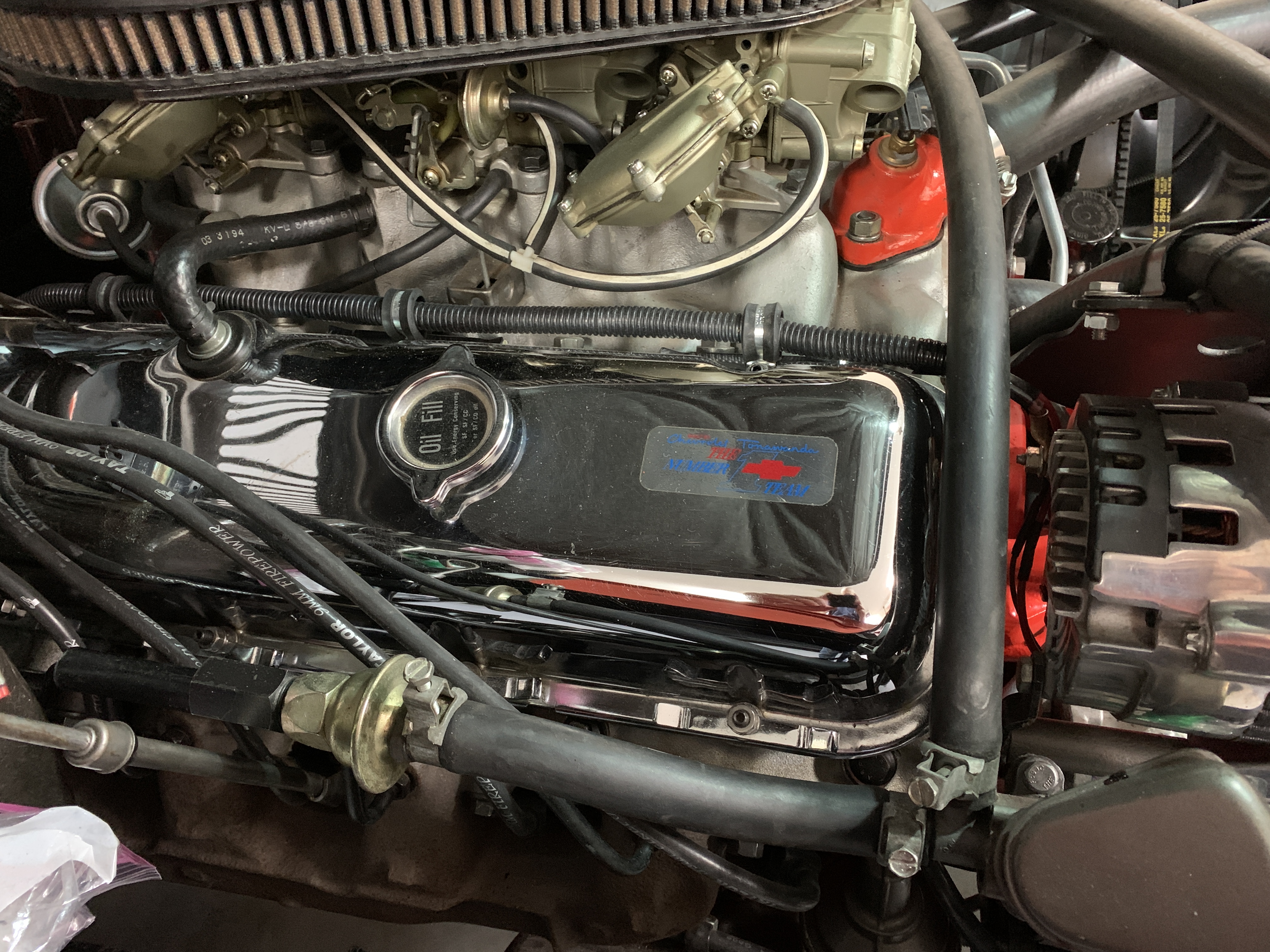

LS65Speed Posted October 15, 2022 Author Share Posted October 15, 2022 9 minutes ago, cny first gen 71 said: That's actually a Factory hood with a 2 in scoop grafted onto it. I have the cc501 cargo coils with 2 inch spacers to get it sitting where I wanted it. It has air shocks on it now but they will be coming off eventually, I only have enough air in them to inflate the bags not to lift the car any more. By the way your car is beautiful. Yes the scoop at two inches looks great grafted onto the stock hood. The 4 (or even more ! ) inch units are just a bit too much for me. That said "to each his own" is what this hobby is supposed to be about. My thoughts on this stuff are nothing more than my personal feelings. Thank you for the compliment on the car, I have done a lot of modifications that you don't see from the outside. My goal is a stock appearing exterior with modifications to build the car GM could have built using era correct off the shelf parts as well as modifications like the 5 Speed that the aftermarket later introduced. A couple of under the skin mods are pictured below...... 1 Quote Link to comment Share on other sites More sharing options...

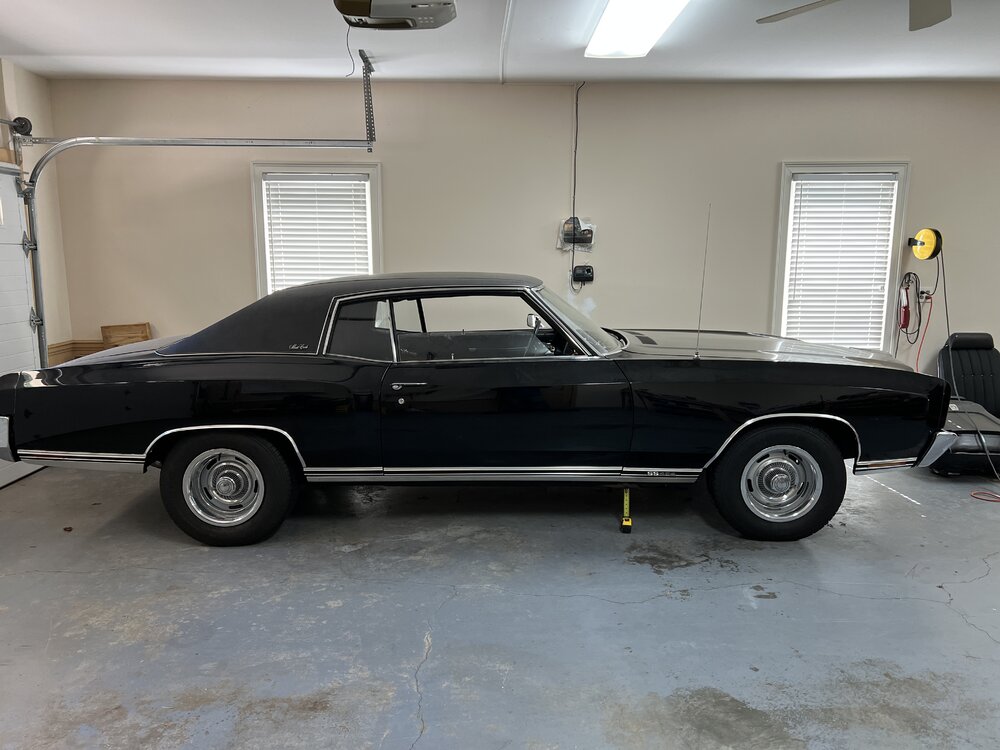

420ponies Posted October 15, 2022 Share Posted October 15, 2022 (edited) Man, nice upgrades . 3x2 bbl corvette big block. I just got done a 427 for my Monte. Yes,Steve did a great job on that hood. I'm trying to get him to do these hood scoops as a retirement gig for extra beer money. He says " I don't have time"..... Really? I can't wait to say " I'm staying home from work today ". Here's a couple of pics of mine. At this moment, same rear coils as Steve mentioned, air shocks with 25 psi ( so they work). The first picture is with worn out stock rear coils, 235/60/15's. The second,275/60/15 drag radials(redline) on 15x8's (5" positive offset). Fronts are 235/60/15's on 7" rims. The deal with those Moog springs, no matter how much stuff is in the trunk, ride level remains the same. Oh,and a smooth ride too. I'm planning on coil overs all around with the same ride height as the 1st picture. Always liked it low as possible. My measurements are from ground to wheelwell lip : front, 24 1/2", rear, 24 1/4" . Hope you can use this information for your Monte. Edited October 15, 2022 by 420ponies Picture 1 Quote Link to comment Share on other sites More sharing options...

MC1of80 Posted October 15, 2022 Share Posted October 15, 2022 Remember the "J" and "K" measurements will be different from car to car because of different tire heights people are using. Quote Link to comment Share on other sites More sharing options...
LS65Speed Posted October 15, 2022 Author Share Posted October 15, 2022 15 minutes ago, MC1of80 said: Remember the "J" and "K" measurements will be different from car to car because of different tire heights people are using. Of course but they are good enough to show how far out of the ballpark I may or may not be. What I did learn just by reading the numbers is that the cars originally were more or less level front to rear. What started me on this wild goose chase was my dislike of the cranked up look for rear ends on Monte Carlos. My goal is more centered on the front to rear numbers for my car and for a stock factory car. If I am a bit higher both front and rear or a bit lower both front and rear when measured against a factory car that is gonna be Ok. 1 Quote Link to comment Share on other sites More sharing options...
