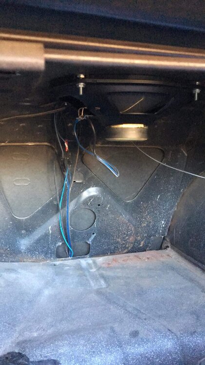

Valina Posted January 18, 2023 Share Posted January 18, 2023 on rear shelf speakers, what color wires go to which speaker, also does the positive or negative.matter. Do they still sell the original dephi type wiring pin, for original plug? Quote Link to comment Share on other sites More sharing options...

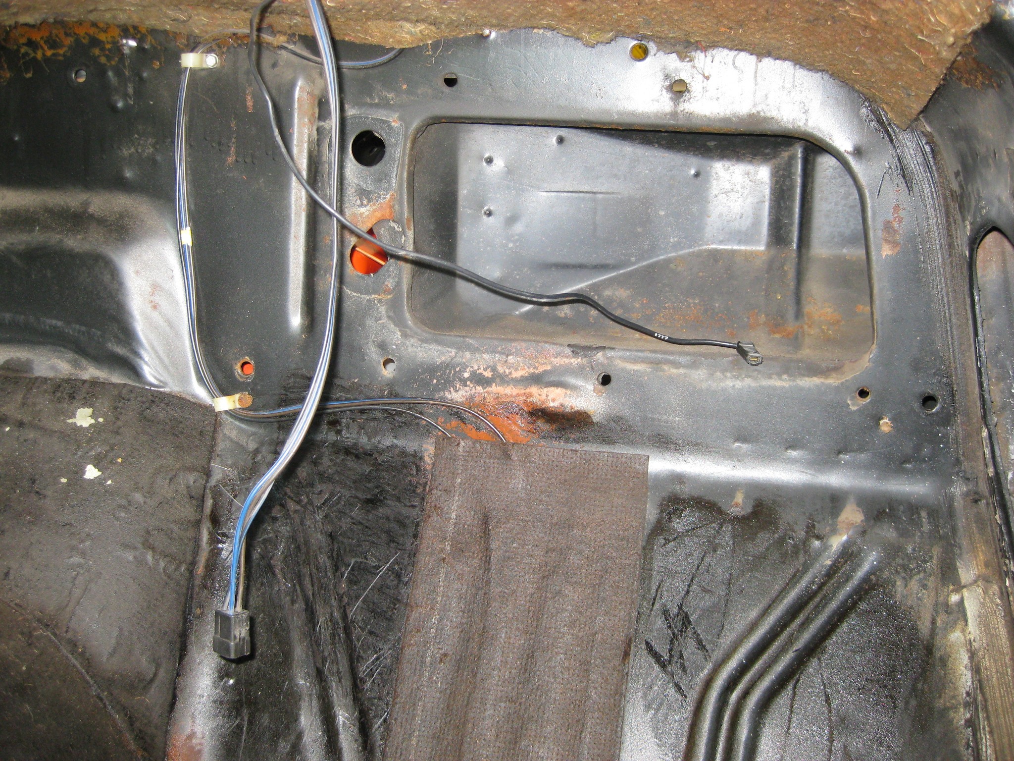

stangeba Posted January 18, 2023 Share Posted January 18, 2023 Rear speaker wiring 1971 The three wire set coming down the fire wall through the grommets is for the rear speakers. Three wire you ask? Yes, Left, Right and ground. One more wire that follows these three, is for the electric trunk opener. 4 Quote Link to comment Share on other sites More sharing options...
