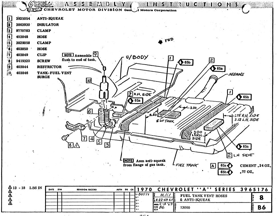

jft69z Posted January 30, 2023 Share Posted January 30, 2023 Here are some diagrams of the fuel tank connections. For your 1972, you'll see 3 lines come from the fuel tank going to the vapor separator, then the 'Vapor Pipe' from the separator going up to the front charcoal canister. If someone capped off the one going up to the front, that would effectively block off those 3 vent lines. Would that cause a condition as you're experiencing, I don't know, doubtful... The 1970 appears to have a standalone vent/surge connection on the right side (item # 10), according to factory diagrams. Unless those vent tubes are plugged, and causing the problem, the only other reasonable suspect can be a restriction further down in the filler neck, which is hard to believe considering that spring you removed should have stopped it.  1972 Fuel Tank:   1970 Fuel Tank:  72 vapor canister lines.pdf 70 fuel tank lines.pdf  2 Quote Link to comment Share on other sites More sharing options...
