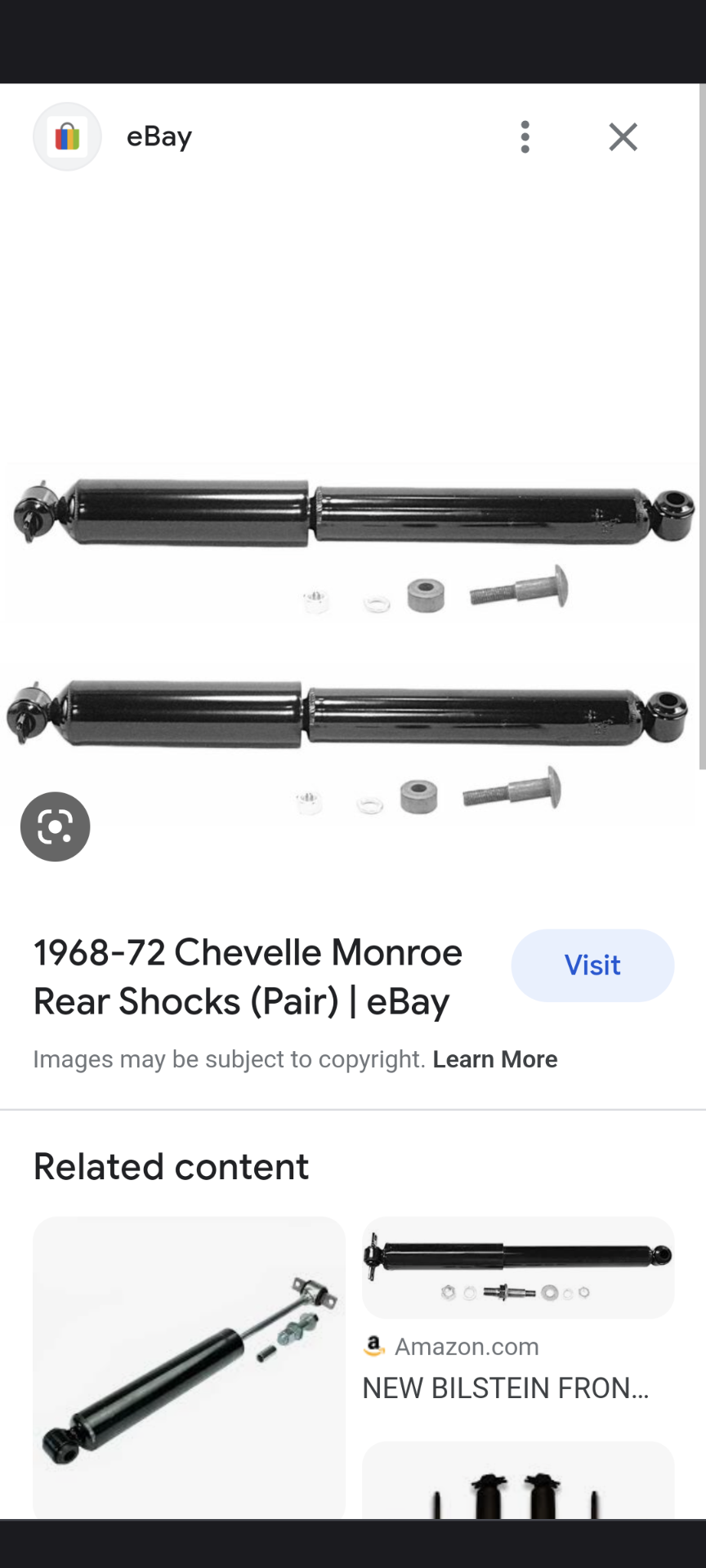

MC1of80 Posted April 3, 2023 Share Posted April 3, 2023 I don't see why you only have an issue with interference. Is it possible? Sure. Maybe for whatever reason Bilstein didn't make the "spacer" wide enough. I have used the other style similar to your lower mounting bolts BUT the spacer and bolt itself were removable like pictured. Quote Link to comment Share on other sites More sharing options...
B-Man Posted April 4, 2023 Author Share Posted April 4, 2023 @MC1of80, those pictures also highlight the problem with the Bilsteins. They don't provide enough of a spacer to prevent the tube from contacting the mounting bracket, and then the stud isn't long enough to (a) go through the mounting bracket and (b) accommodate a nut and a washer. Again, this would all be solved if I could have pressed the Bilstein-provided bushing onto the stud / bolt I removed from my old shocks using my bench vise. I proper press or bench arbor might have allowed me to be successful. Hopefully this will all be solved with the Dorman bolt / stud / bushing assemblies @jft69z, yeah I havent researched the alternative Bilstein part numbers yet. Nor have I actually tried to call them, which is probably the needed approach. I'm focused on solving the problem by other means, hah! Quote Link to comment Share on other sites More sharing options...

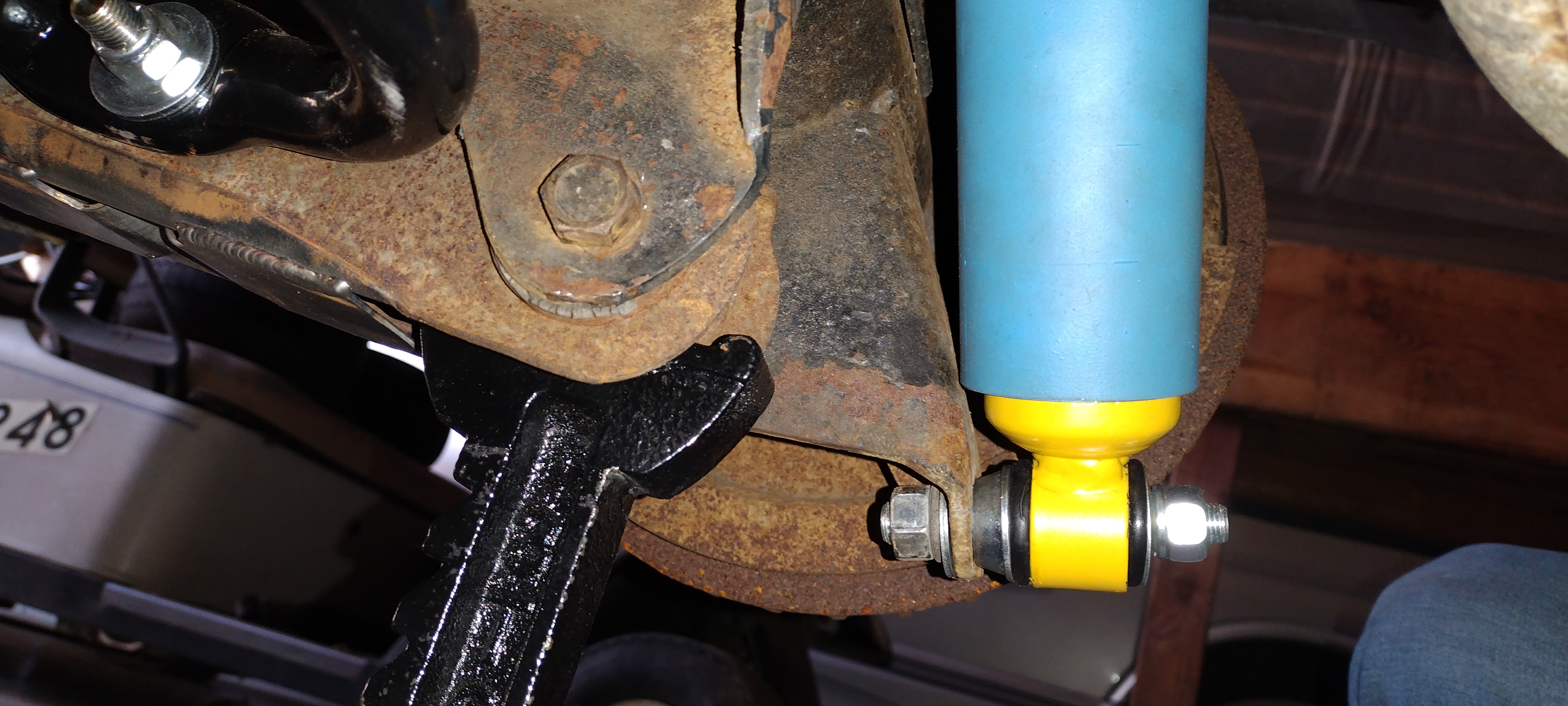

B-Man Posted April 8, 2023 Author Share Posted April 8, 2023 FINALLY got the Bilstein shocks installed. Yay!!! Unbelievable how many hours I have in to what should be a simple job Bottom line - if you buy Bilstein shocks for the rear of your Monte Carlo, be sure you buy the Dorman (or similar) bushing / stud / bolt assemblies. You will have to cut out the bolt / stud that comes with the Bilstein shocks, remove it and the bushing, then install the Dorman assembly, all prior to installing the shocks in your car. Attached is a picture of the final result, as well as 2 pictures showing why the bolt / stud that comes with the Bilstein shocks doesn't work. If you don't see it, just move on - definitely not worth taking up more room on this server with more discussion 2 Quote Link to comment Share on other sites More sharing options...

MC1of80 Posted April 8, 2023 Share Posted April 8, 2023 Yay! You got it. Sweet! Isn't the blue plastic sleeve covering the body of the shock supposed to be removed? Never had or will have Bilstein shocks. Just asking. Quote Link to comment Share on other sites More sharing options...

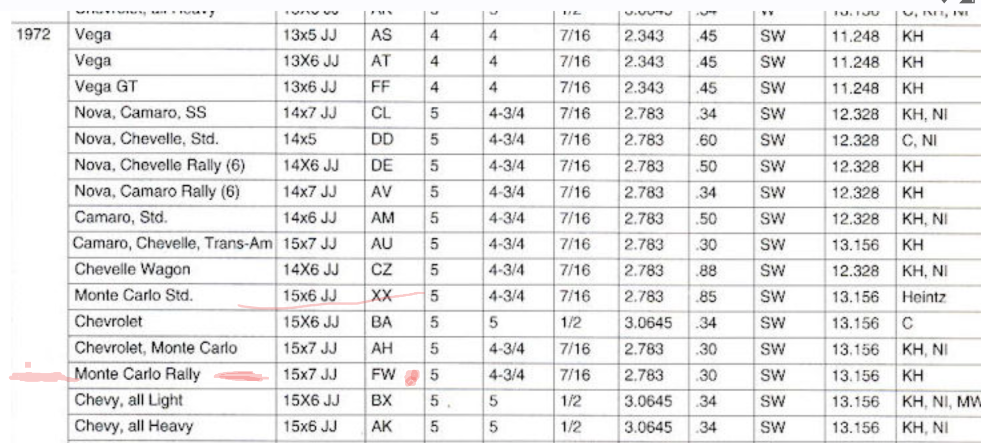

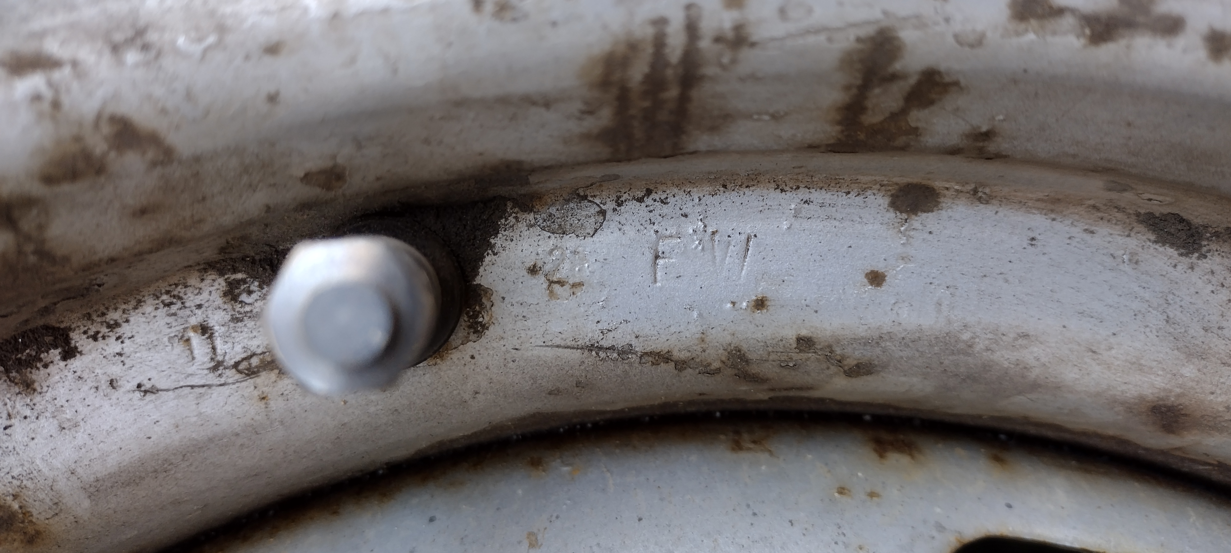

B-Man Posted April 8, 2023 Author Share Posted April 8, 2023 @jft69zand @Blackhawk, I finally finished the rear shocks and was able to turn my attention back to the wheel code / size. I found the FW marking stamp just to the right of the valve stem. For my 72, this means that they are indeed 15x7 Monte Carlo Rally wheels!! Yay. Quote Link to comment Share on other sites More sharing options...

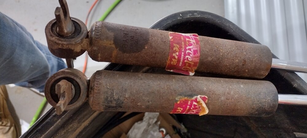

B-Man Posted April 8, 2023 Author Share Posted April 8, 2023 I got the front Bilsteins in without too much of an issue. I had to run down to the auto parts store to grab some new, short 5/16-18 clip nuts for the lower shock bolts. Plan on replacing those while you're at it. Sort of a shame Bilstein doesn't include those to be honest. The old KYB shocks I replaced seem to have some good damping action. But they look like heck! Still glad I replaced them, along with the rears. Only time will tell if the Bilsteins are worth the 3x price tag. Other then some new BF Goodrich Radial TAs per the earlier posts on this thread, that's all for the suspension for now On to the continuing saga of the starter replacement (other thread)!!! 1 Quote Link to comment Share on other sites More sharing options...
