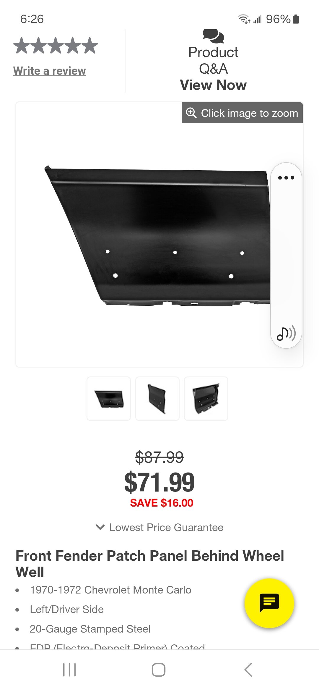

Hey everyone. Trying to get back at the metal work now, and I'm currently working on my fender patches. I got the panels from Leo. I'm sure some people have some experience with them. They aren't perfect but an excellent starting point...
With my grandpa gone now I don't really have a 2nd opinion or set of eyes at the ready. Please let me know what you think, how it's looking, any advice or suggestions. I can take more pics if needed. I think I'm close to be able to tack in place. I know the door edge needs a bit of work.
