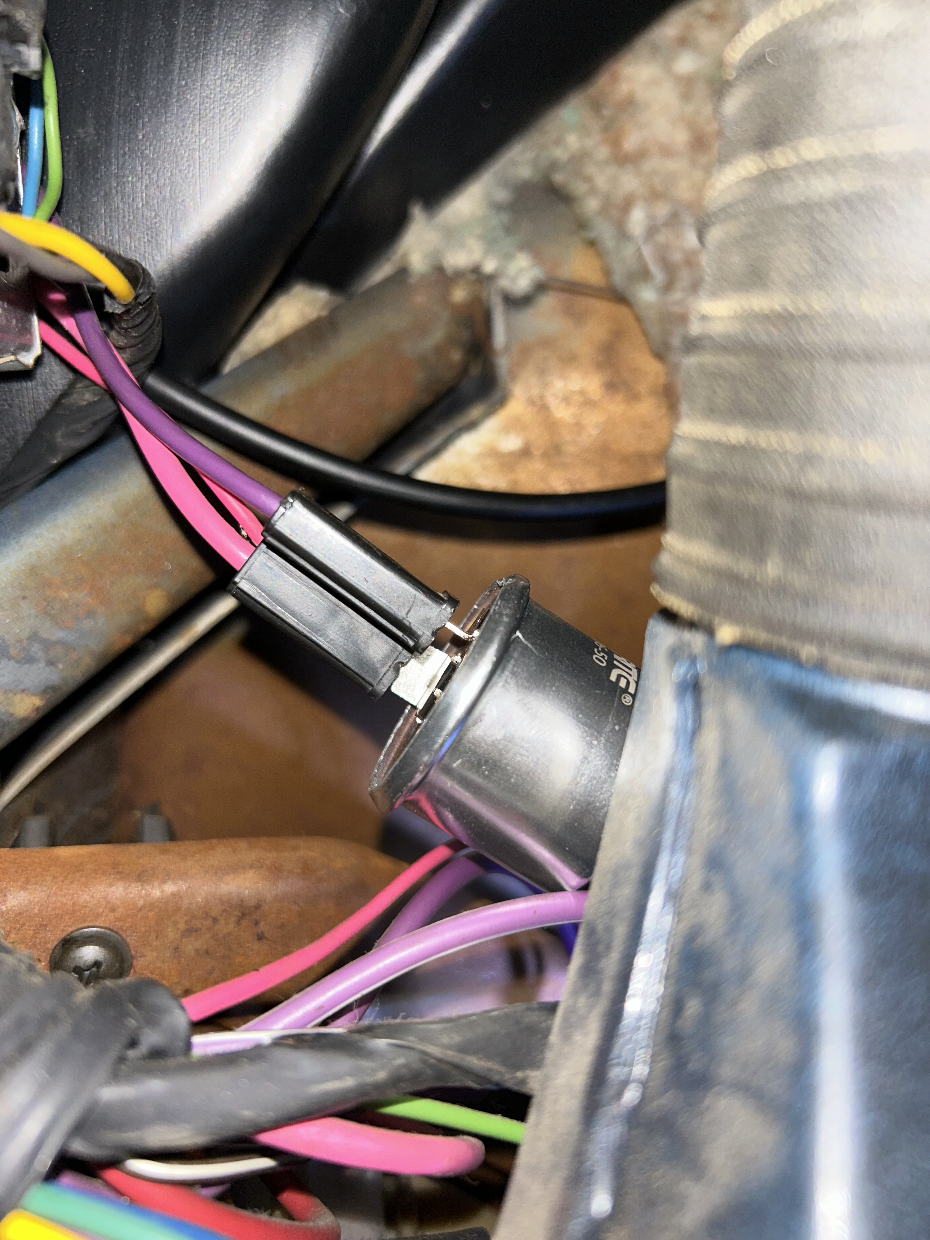

Hendrik_GER Posted July 5 Author Posted July 5 I'm getting desperate right now. 🤣 The switch for the hazard warning lights works correctly again after the replacement, but the hazard warning lights don't work. Does anyone have a tip? I also replaced the relay. No difference. Otherwise, everything works as it should, except for the hazard warning lights, which won't turn on. Quote
cny first gen 71 Posted July 5 Posted July 5 The flasher on the fuse block is for the 4 way flasher did you change that? Quote
Hendrik_GER Posted July 5 Author Posted July 5 I'll check that. 👍😊 It's also the case that now that the Hazard switch is working again, the turning lights don't work when the hazard warning switch is engaged. The Turnus lights only work when I pull out the hazard warning switch. Something is being rewired. I'll check the fuse box. 2 Quote
Scott S. Posted July 5 Posted July 5 Hazards and turn signals don't work at the same time.... The hazards cancel the turn signal. But that should happen when the knob is pushed in. Sounds backwards to me. ????? Quote
Hendrik_GER Posted July 5 Author Posted July 5 It's crazy. The turn signals only work when the hazard switch is pulled out. If it's pushed in, they no longer work. The hazard lights never work. The previous owner had to change some wiring because the turn signal switch was defective (the hazard switch could no longer be pushed in). Quote
GRAY 70 Monte Carlo Posted July 5 Posted July 5 Here is a wiring diagram I had to zoom in on the hazard system (top left corner)but this will help you do some quick testing. First thing is pull the hazard flasher from fuse block. One side of the two exposed terminals should have 12 volts the key will probably have to be in run position. If you don’t have 12 volts problem is between fuse and that terminal . Second If you do have power to the one terminal then with a dvom do a continuity test from the other terminal the one without any power to the what appears to be the brown wire on the harness side of the plug (top right of wiring diagram)where you just plugged in your new turn signal switch . You should have continuity . Third back to the terminal at the flasher with 12 volt's. That terminal feeds your stop lamp switch ( bottom middle of diagram) so you should have 12 volts there also on the tan wire. I am sure that is the case since you haven’t mentioned any problems with tail lights. Fourth on the stop light switch the white wire you could do a continuity test to the same harness plug where you plugged in your turn signal switch you should have continuity there also. Again I believe you will find that to be ok also. The most likely thing is going to be between flasher and turn signal plug. If not it has to be between turn signal plug and rear end. If needed could send that diagram. Hope this helps good luck 2 1 Quote
