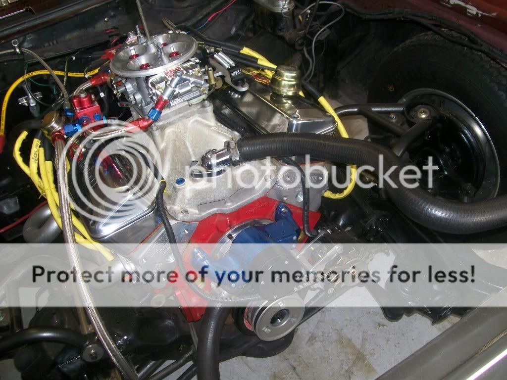

monteman427 Posted August 19, 2011 Share Posted August 19, 2011 here is a pic of mine with the BMR upper and lowers Quote Link to comment Share on other sites More sharing options...
