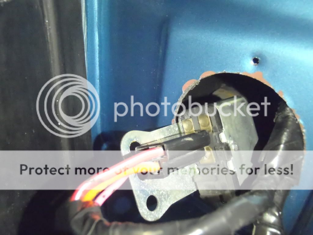

Thankyou all who replied. I will dive into this today.I will check the other circuit and then see if I have power running to the master switch on the door. these windows have had no problems going up or down until now.I know they turned 40 and could use some new grease in them.I'll do this when I get them to work from the master switch and separate switches.again i don't what I'd do without you helping me along the way.

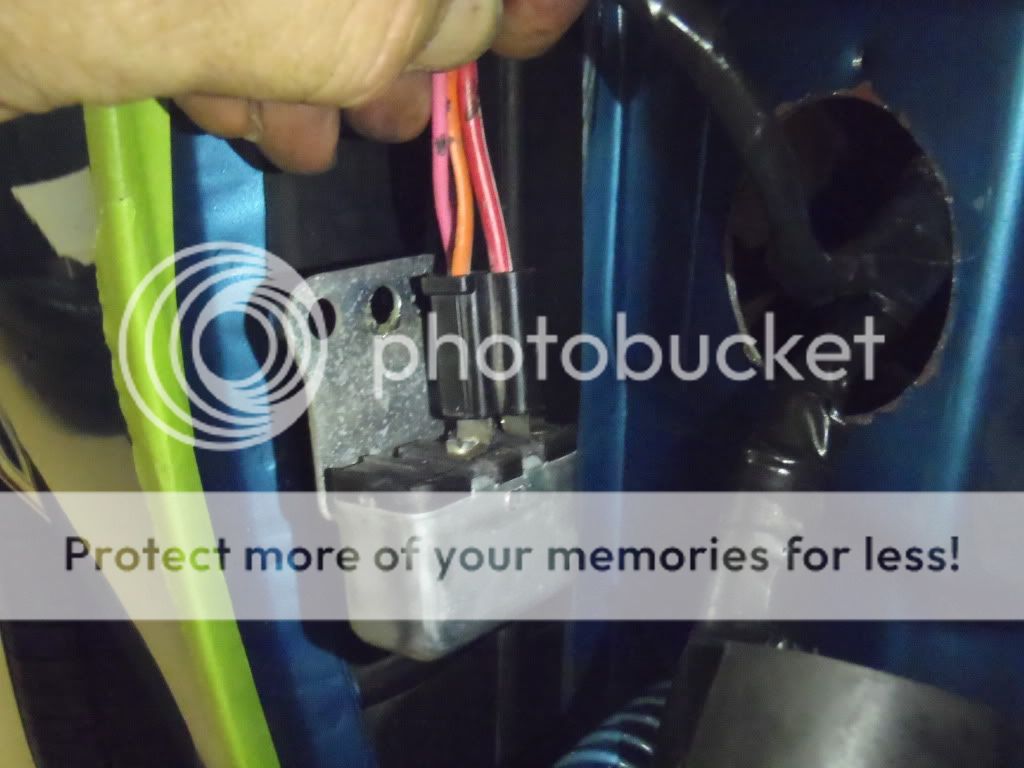

Here's what I found so far.power from 12v-30amp fuse from fuse block,check.power going into window switch relay,tan wire (with black tracer) on top of plug) check. power coming out of relay tan wire (next to red with white tracer) ,check.power to red wire(from relay switch) with white tracer going to master switch,NO POWER.so now trying to figure out why this doesn't have power.I also have power coming out of the 10gage wire with fusible link from horn relay.So, what makes the red wire w/white tracer have power to master switch? I am using a horn relay from a 1970 chevy pickup.has the same wire connector as the window relay,12v type.Any thoughts would be appreciated.
Hi,just to reiterate the last post .the wire next to the red wire (with white tracer is a pink wire,not tan.I've looked through my fisher service manual,(15-6)page, and it states"turn ignition on and with test light check output terminal of relay"(red/white wire).If tester does not light:
a.put test light on ignition relay coil terminal(pink or tan wire).
b.If tester lights,replace ignition relay.
Well,I did that and juice to that wire.so now the ignition relay is bad?I'm going to replace the window switch relay,master window switch(took this apart and the contacts look bad,bad) and also the ignition relay.It has been acting funny, sometimes the gen. light comes on and sometimes you have to move the key for it to light up.maybe that is the problem.But first when I checked the window relay no power going out to the window master switch(red/white wire).I think that was the whole problem why the windows would not work.So couple hundred dollars and maybe I'll have operating windows again! Isn't life grand!!

Sounds like you are making progress on solving your power window issues. Since you will be replacing your power window relay, I assume you are aware of its well-hidden power window location? If it is the same on a '72 as a '70 it is in the lower cowl area behind the driver's side kick panel. I found it nearly impossible to remove that kick panel on my non-factory AC car because the lower Astro Vent grill and housing screws have to be removed first and the park brake assembly is right in the way. However, if you have a factory AC car, it may be a snap.
I actually installed the relay through the hole I cut in the cowl for the accordian grommet. If I hadn't already had the door off, I'm not sure I would have been able to install the relay in the factory location without removing the park brake assembly to gain access to the housing screws. Here's a couple of pics. Good luck replacing yours.

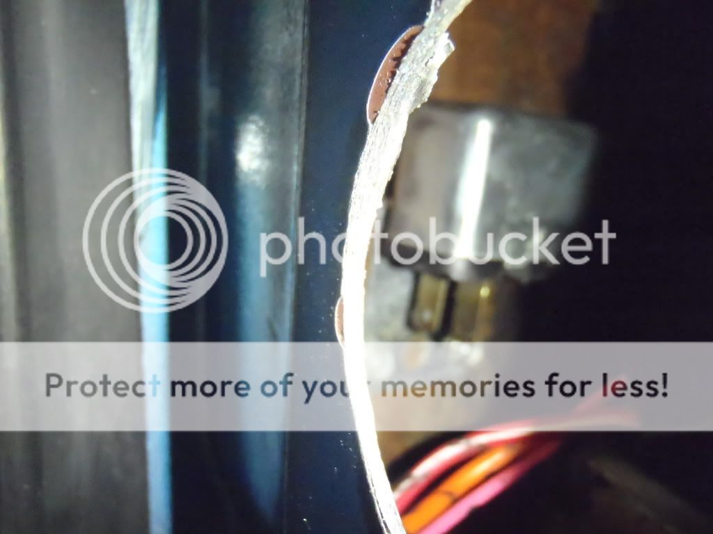

Found the problem, passenger side window, picture in gallery under 420ponies. Can't figure out how to add pic to reply post. Still can't figure out why master switch for passenger switch is opposite of the rest of the switches. All wires look factory taped. Could passenger side master switch wires be switched in wire connector?? Window switch on passenger side is correct. Any ideas?
Glad you found the problem. I would bet your master switch is wired correctly (in the connector) but the wires were somehow crossed before they reach the regulator motor - probably in a earlier incorrect splicing job.

I went back out to look at the wires and I will have to do this (change out the master switch connector wires).I just had too much of trying to pin-point the problem.that wire that is rubbed will be repaired and re-routed out of the way of the window regulator.I cannot see where they might have re-spliced the wires to the window regulator, but I can see why it needs to be changed when I bench tested the window motor,that spring does get some tension on it.Thankyou again for your help in this matter.I always know someone on here will have answer to my questions.Thanks Again!!
