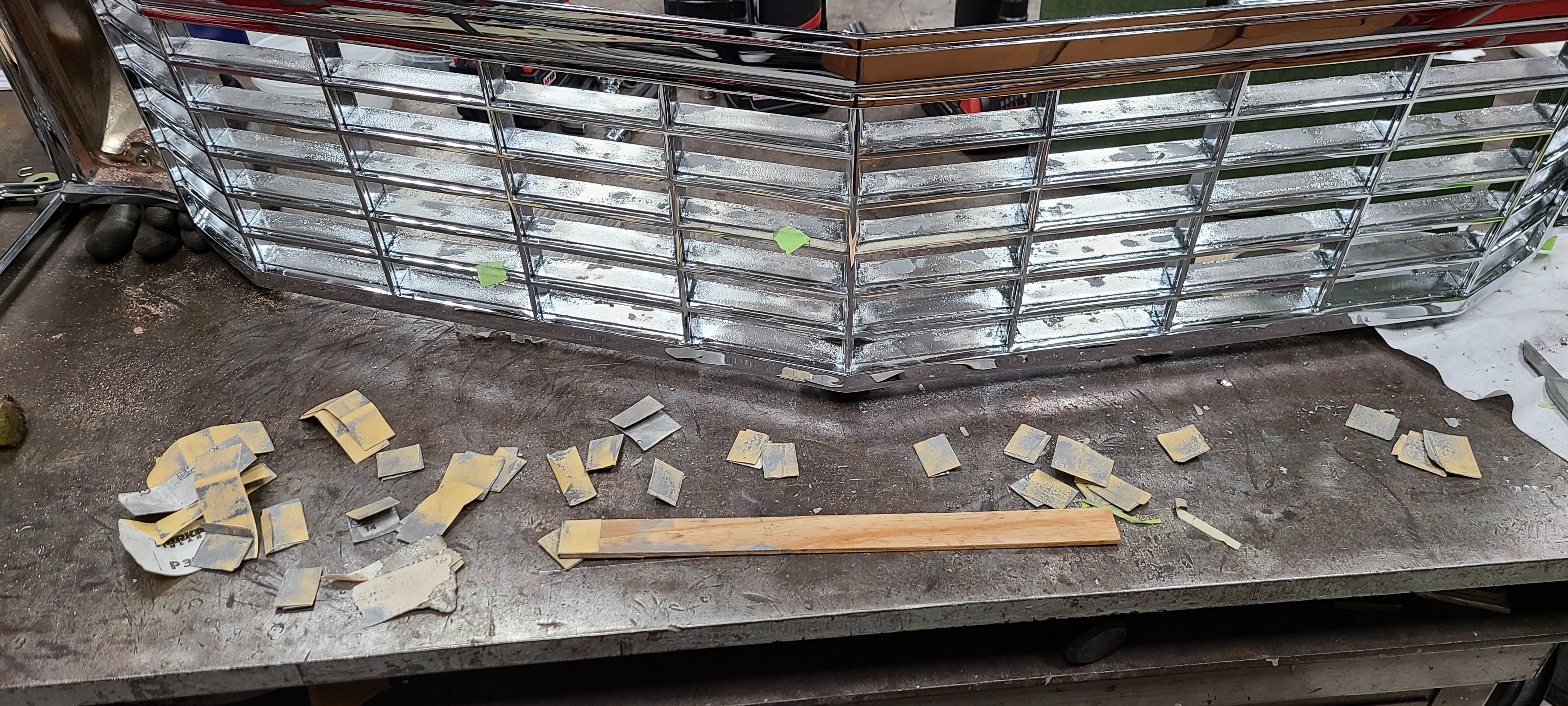

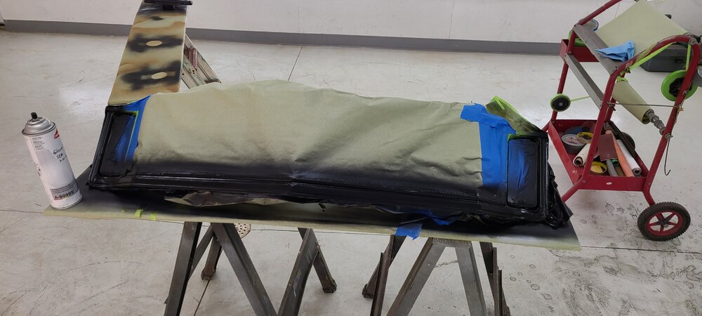

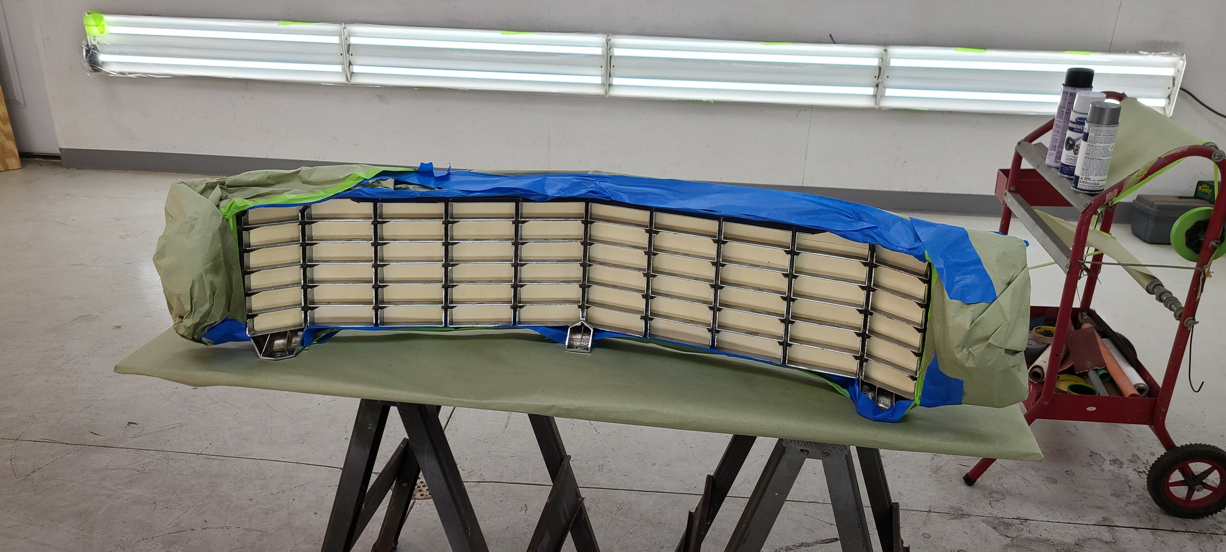

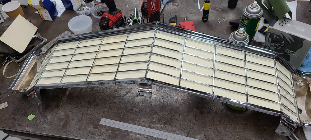

jft69z Posted August 24, 2021 Posted August 24, 2021 15 hours ago, TheBMan said: @jft69z - you did yours yourself??? I had Advanced Custom Chrome in Erie, PA. re-chrome 2 grills for me. Ask for Chris, the owner. 814-899-1233 First I had to repair any pits that just couldn't be done at the chrome shop, used 'All Metal' filler and the paint stick/sand paper as shown to fill the low spots. I then masked off all 60 of the holes to paint the openings argent silver from the back side (used a manila file folder to make the rectangle fillers). Sprayed Satin Clear over the silver too, I think. After that, I masked off the area with the thin lines/around signal lights and painted that with Axalta Trim Black. Yeah, it sucked. I still have the second grill to paint. Turns out that was in much better shape than the first grill (shown), but I acquired it after the first one was already getting done. I just wanted a spare. Eventually, I'll paint that one up & keep the first as the spare. 4 Quote
TheBMan Posted August 24, 2021 Author Posted August 24, 2021 7 hours ago, jft69z said: I had Advanced Custom Chrome in Erie, PA. re-chrome 2 grills for me. Ask for Chris, the owner. 814-899-1233 First I had to repair any pits that just couldn't be done at the chrome shop, used 'All Metal' filler and the paint stick/sand paper as shown to fill the low spots. I then masked off all 60 of the holes to paint the openings argent silver from the back side (used a manila file folder to make the rectangle fillers). Sprayed Satin Clear over the silver too, I think. After that, I masked off the area with the thin lines/around signal lights and painted that with Axalta Trim Black. Yeah, it sucked. I still have the second grill to paint still. Turns out that was in much better shape than the first grill (shown), but I acquired it after the first one was already getting done. I just wanted a spare. Eventually, I'll paint that one up & keep the first as the spare. @jft69z This looks great, Joe. Thanks for all the info. I think I'm going to do what you did - have someone chrome the grille and then do the detail work myself. I'll call Chris for sure. Thanks, man! Quote

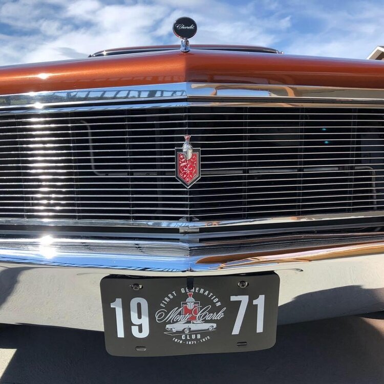

cny first gen 71 Posted August 24, 2021 Posted August 24, 2021 I painted the fins on my grill black. I taped the front up and painted from the back, that's just the way I wanted it. 1 Quote
Dtret Posted August 24, 2021 Posted August 24, 2021 38 minutes ago, cny first gen 71 said: I painted the fins on my grill black. I taped the front up and painted from the back, that's just the way I wanted it. I like the black, it matches 1 Quote

cny first gen 71 Posted August 25, 2021 Posted August 25, 2021 3 hours ago, Dtret said: I like the black, it matches Yea I like the black better too, it just kinda flows better with the color of the car. I cleaned the fins up as best I could but the silver just didn't pop for me. Quote
