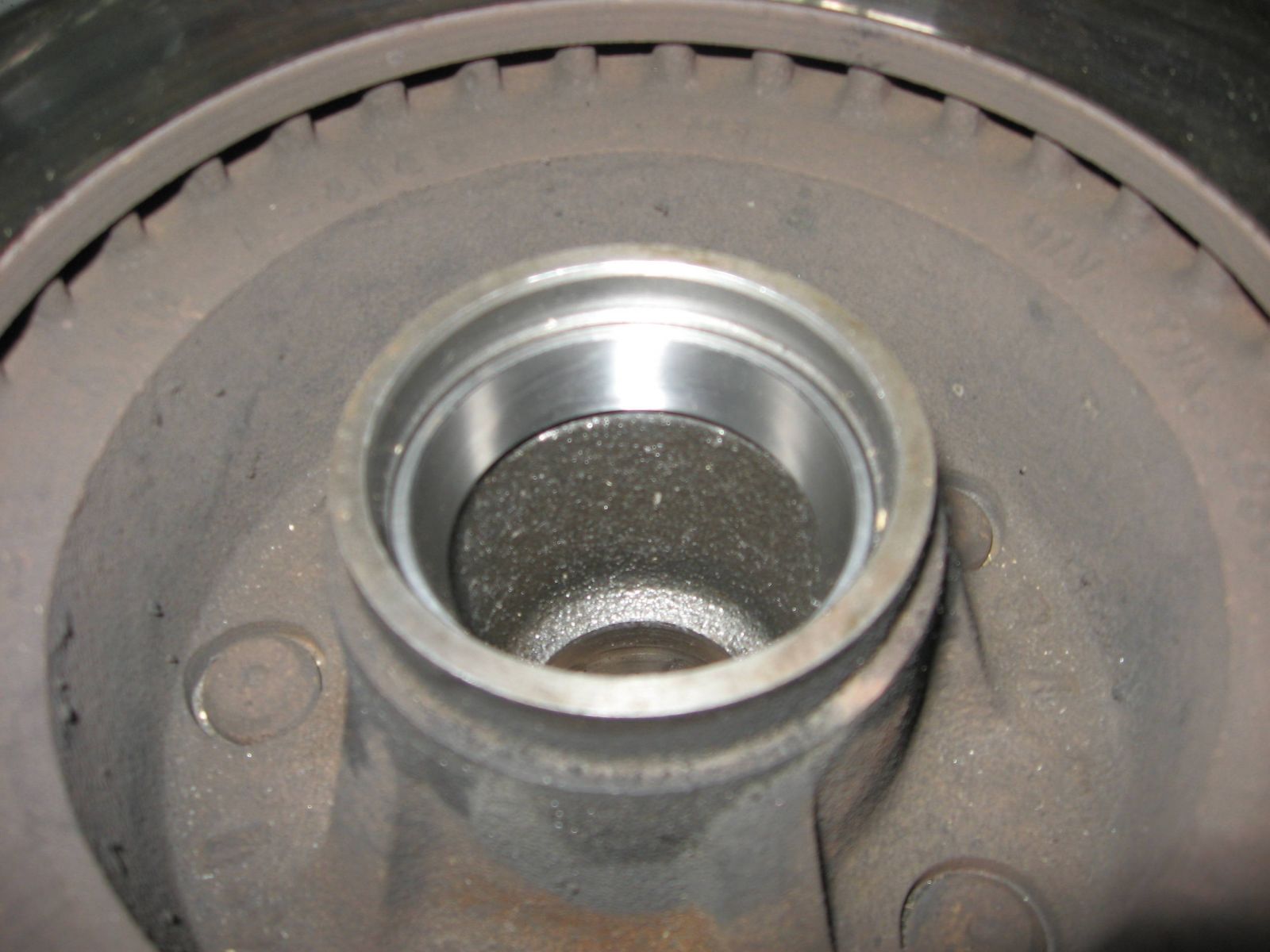

Installing the inner race. I tapped it in using a piece of wood until it was flush with the rotor. I then used the old race to tap in the new one a little further. I made sure not to go too far or the old race will be stuck in the rotor with the new one. I have a tool to pound in the race the rest of the way but it only worked if the race was alrady in a little.
