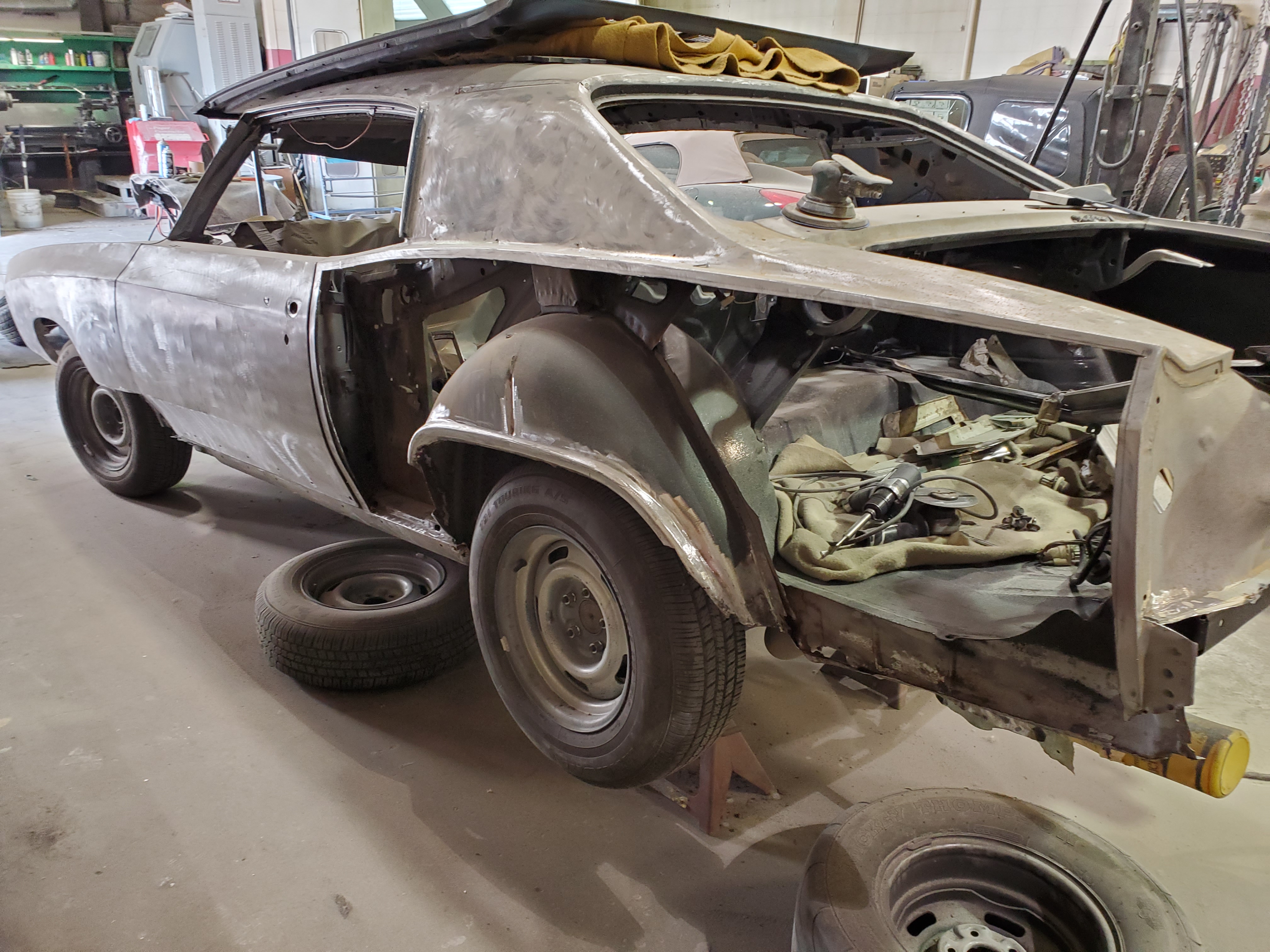

  9. Thanks Aaron. We will do what we can to attend wherever and whenever it happens. A much as I'd like to debut the new Monte at the western meet in Montana, the body shop progress is not going well so may not get it back in time to have it together to drive there. It's been there 4 months and less than half done. They just started on the driver's side. Thanks for the update. I'll keep the room booked until we know for sure what the plan ends up being.
