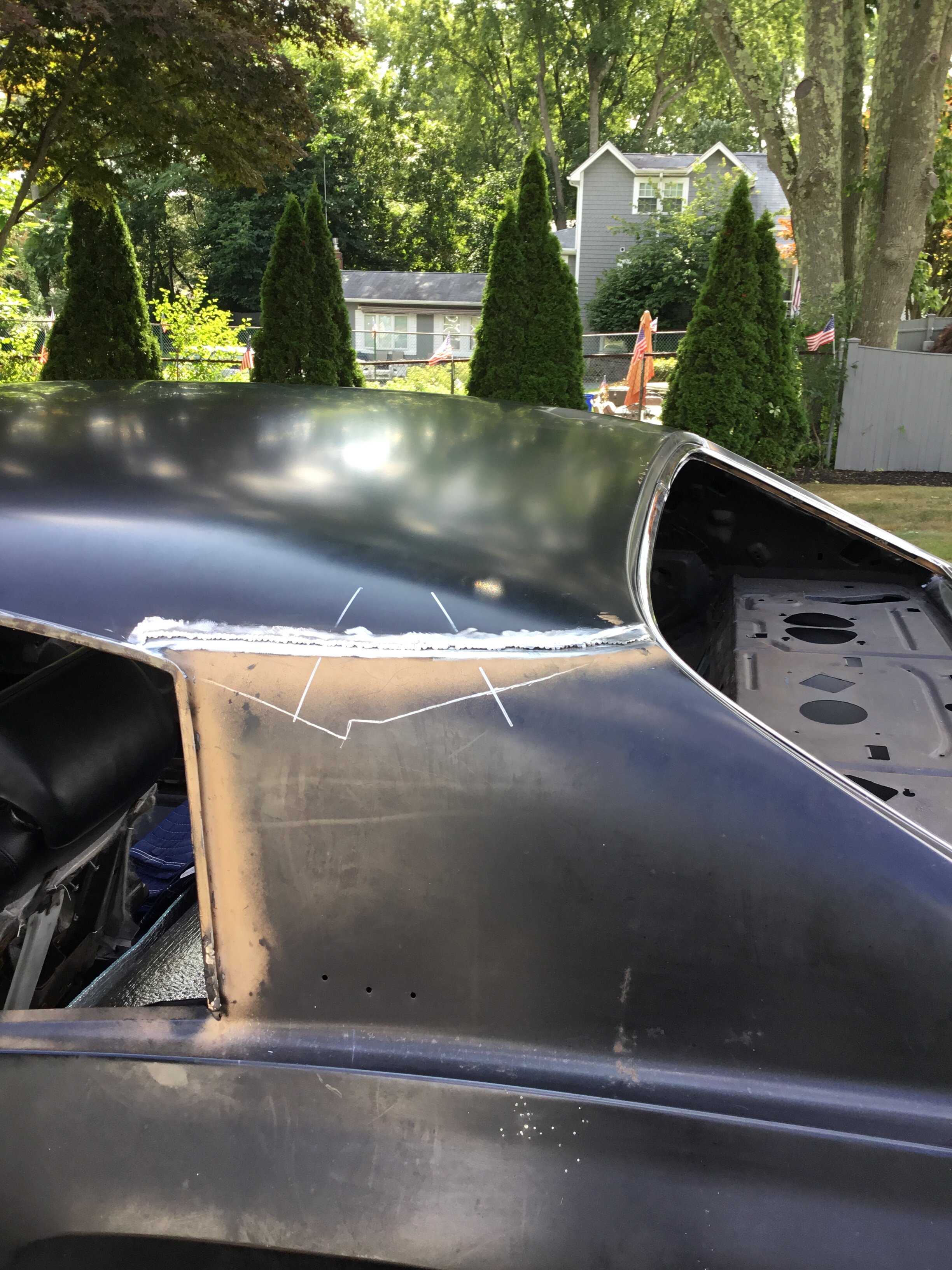

Lou I replaced the roof skin on my 71 a couple of years ago. Beware the roof skin they sell is for a Chevelle that will need to be modified to fit the Monte.The Chevelle roof skins rear quarter to roof seam is lower than the Monte, you will need to cut the extra metal off to make it fit. I used a similar 3M panel epoxy at the drip rail seams to attach the new roof skin. I welded the front and rear window channels, front pillars and rear quarter seams. Here are a couple of pictures of the rear seam modification you will need to make.

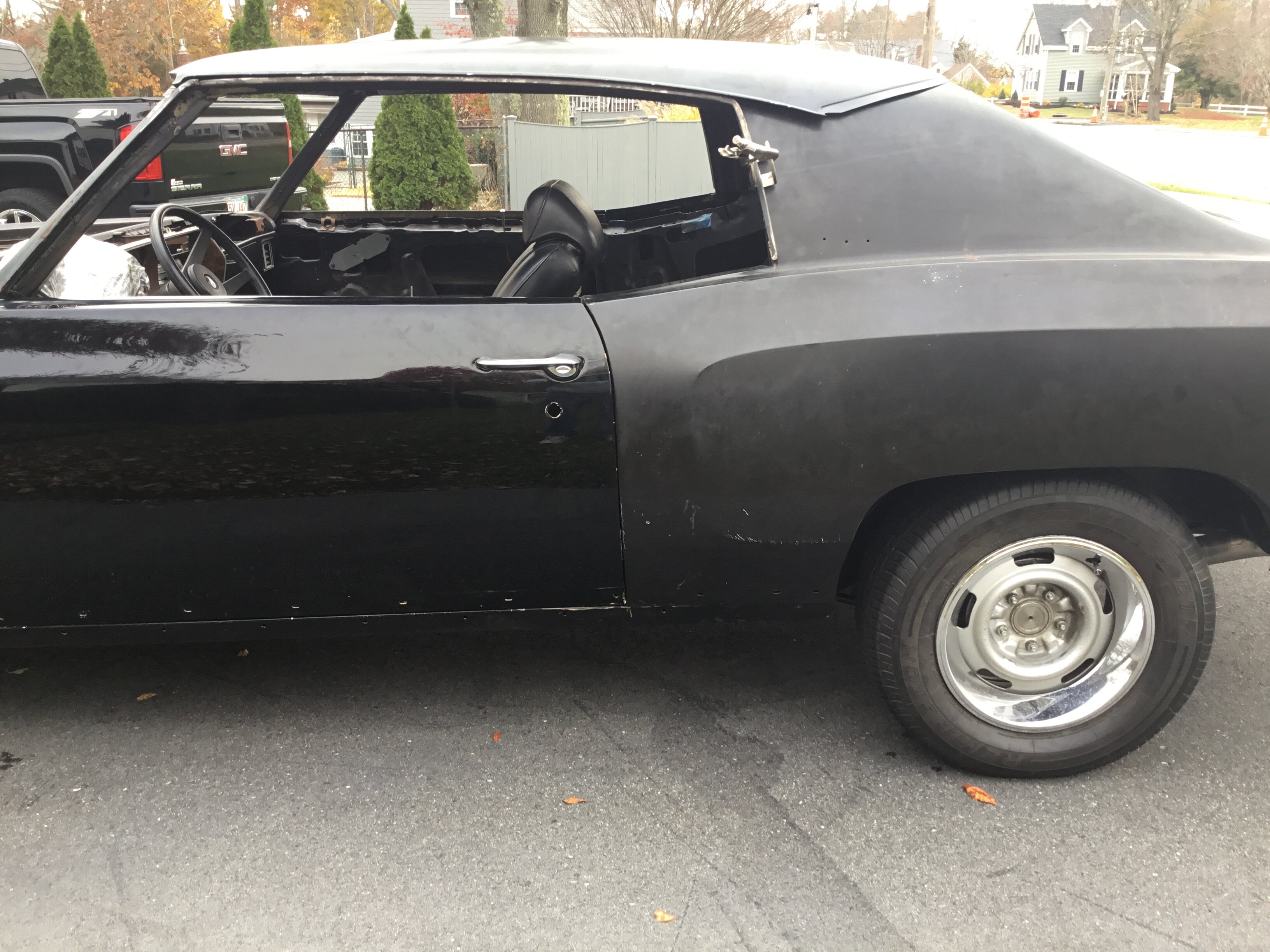

I know it's been a while but this project turned out to be bigger than I thought it was going to be. I ended up replacing both rear quarters with NOS quarters and the roof skin. Now all the rust is gone. I have mocked up the the body with the trim to make sure everything lines up properly and will be sending it out for final body work and paint soon. Here are some pictures I took. Hopefully I will have it back in the spring to put it back together for the final time.
