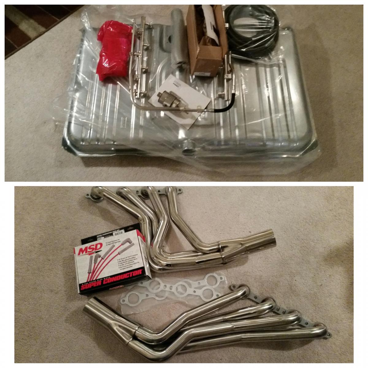

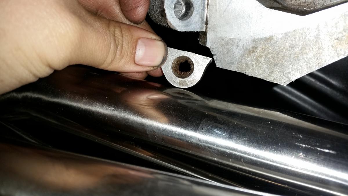

A little updated on my build. I ordered a efi tank from TANKS Inc. Plus their fuel line and fittings kit. I choose to go with the walbro 400 pump for my build. I also got some fbody 98-02 ls1 1 3/4 stainless steel race headers from Speed Engineering. Alot cheaper then buying Abody specific ls swap headers. I installed the headers and the only problem I ran into was needing to cut off a tab/ear off the 4l80e passenger side. If I would've used a 4l60e I'm sure that wouldn't of been a problem. I had no other clearance issue with using fbody headers on the monte.
