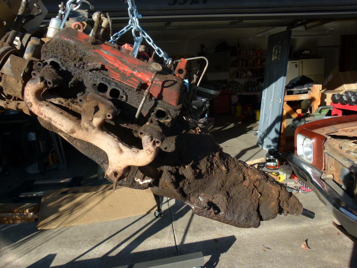

Nothing like this, no. The access holes for the body mounts at the bottom of the firewall above the frame were fairly full of the same stuff, only in a drier condition. -
Droff replied to Canuck's topic in General 70-72 Monte Carlo Forum
I have no idea how it got this bad, the motor is pretty much the same, plenty of it on top of the intake. I only scraped the front part of the transmission and had several pounds of the - whatever it is. -

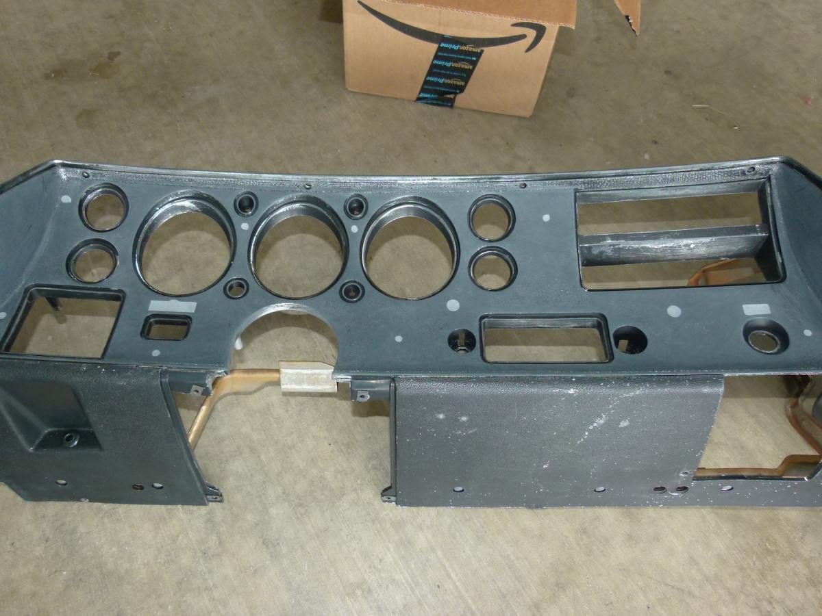

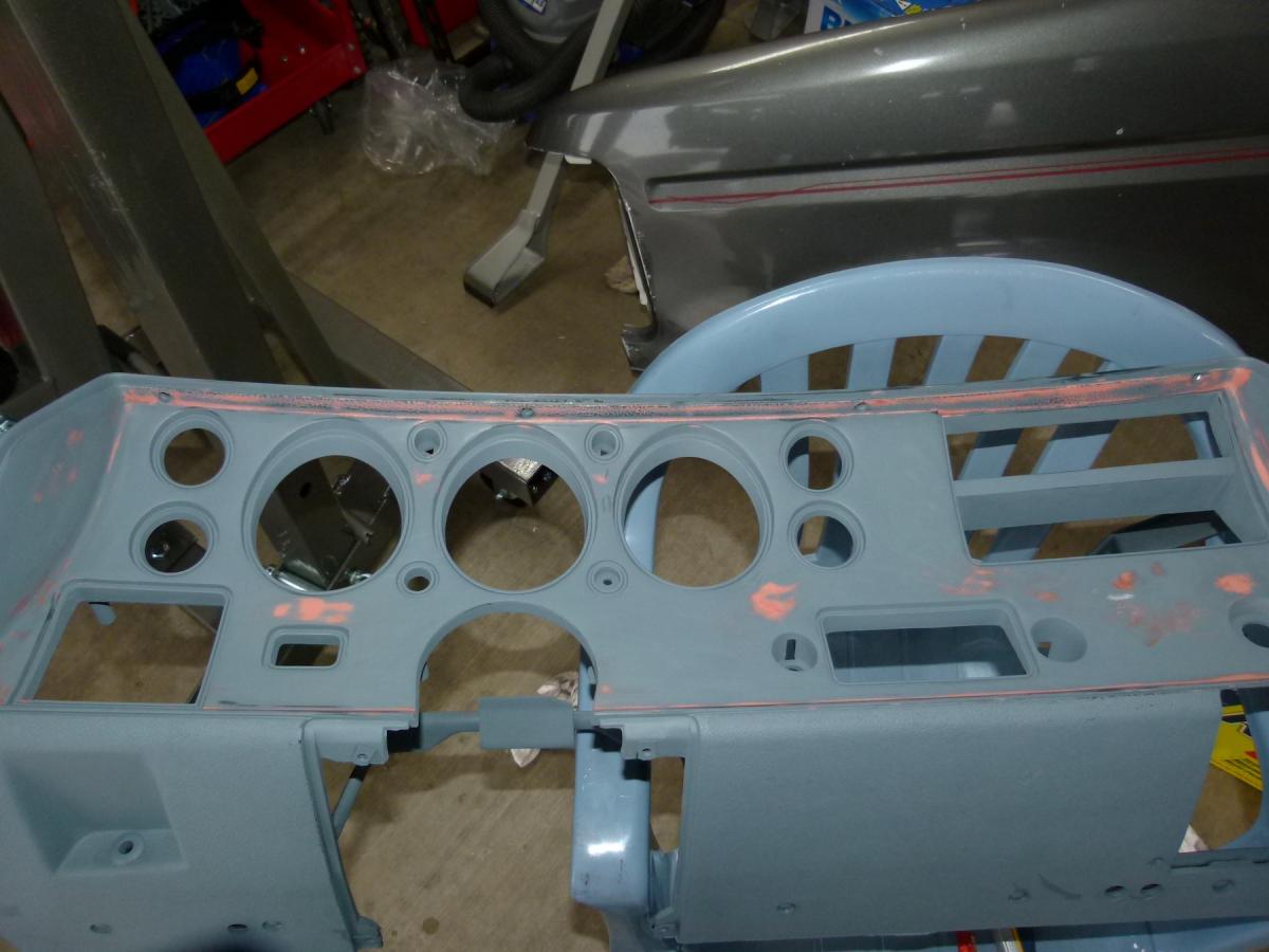

I rattle can'd a coat of primer on it and saw several flaws that weren't there before. I sanded it down and added some bondo in a tube, first time doing any type of filler work for me and this stuff worked out pretty good. Covered whatever was left of the texture and smoothed out the corners. Hit it with some more high grit paper (wet).
I couldn't figure out a good way to get the texture look to the Steelstick material so I smoothed out the whole dash, but just on the gauge side. It looked pretty decent so far but I wasn't able to get things smoothed out in the corners or at the top.

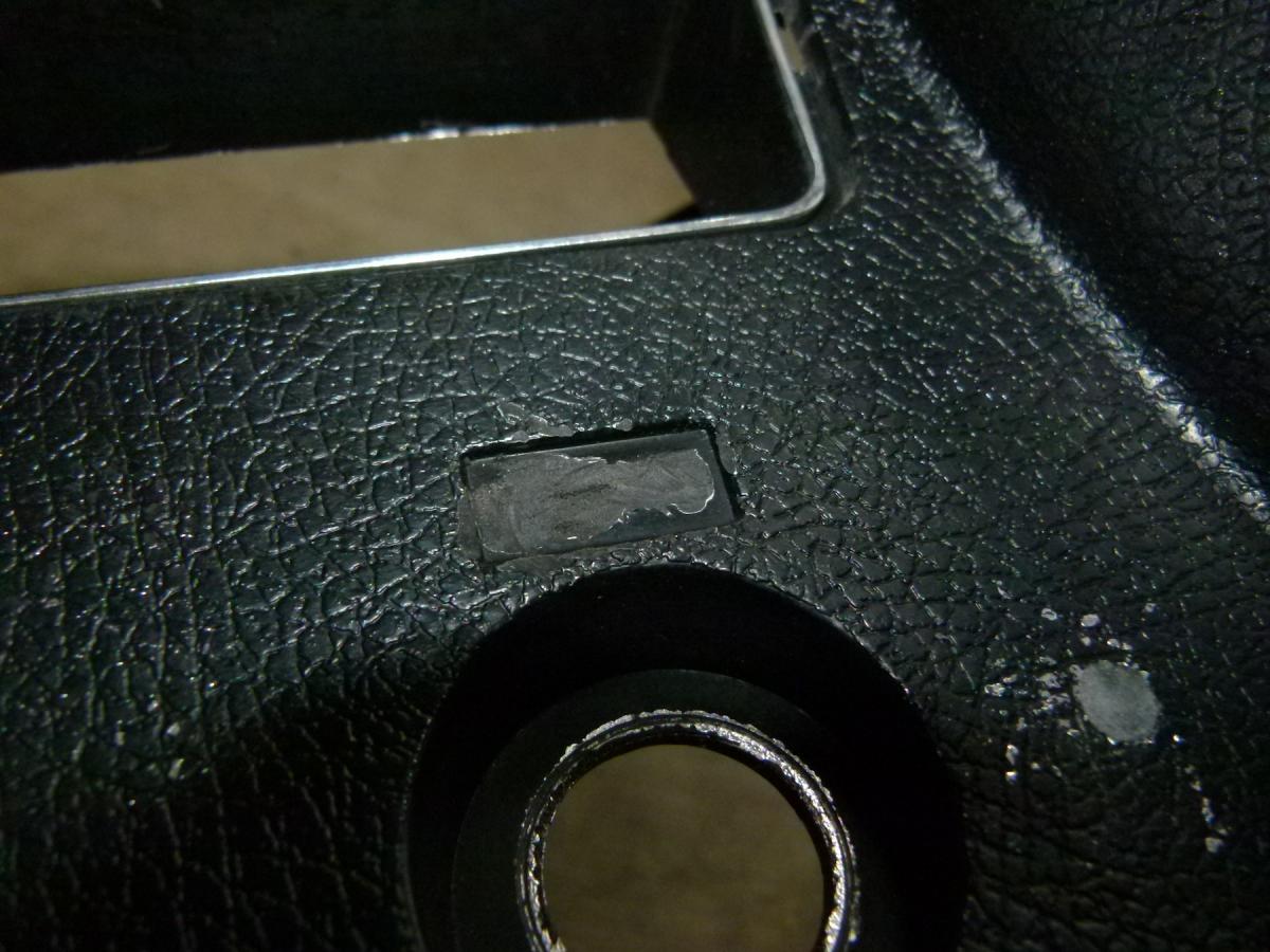

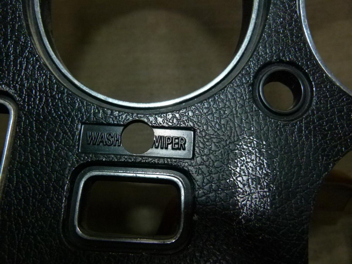

Well, did some work on the dash and went with some JB Weld stuff called Steelstick. It hardens pretty quick and can be cut or sanded, although the longer it sets, the harder it gets. I used a dremel to remove the raised lettering for the wipers and lighter, then filled it in.
