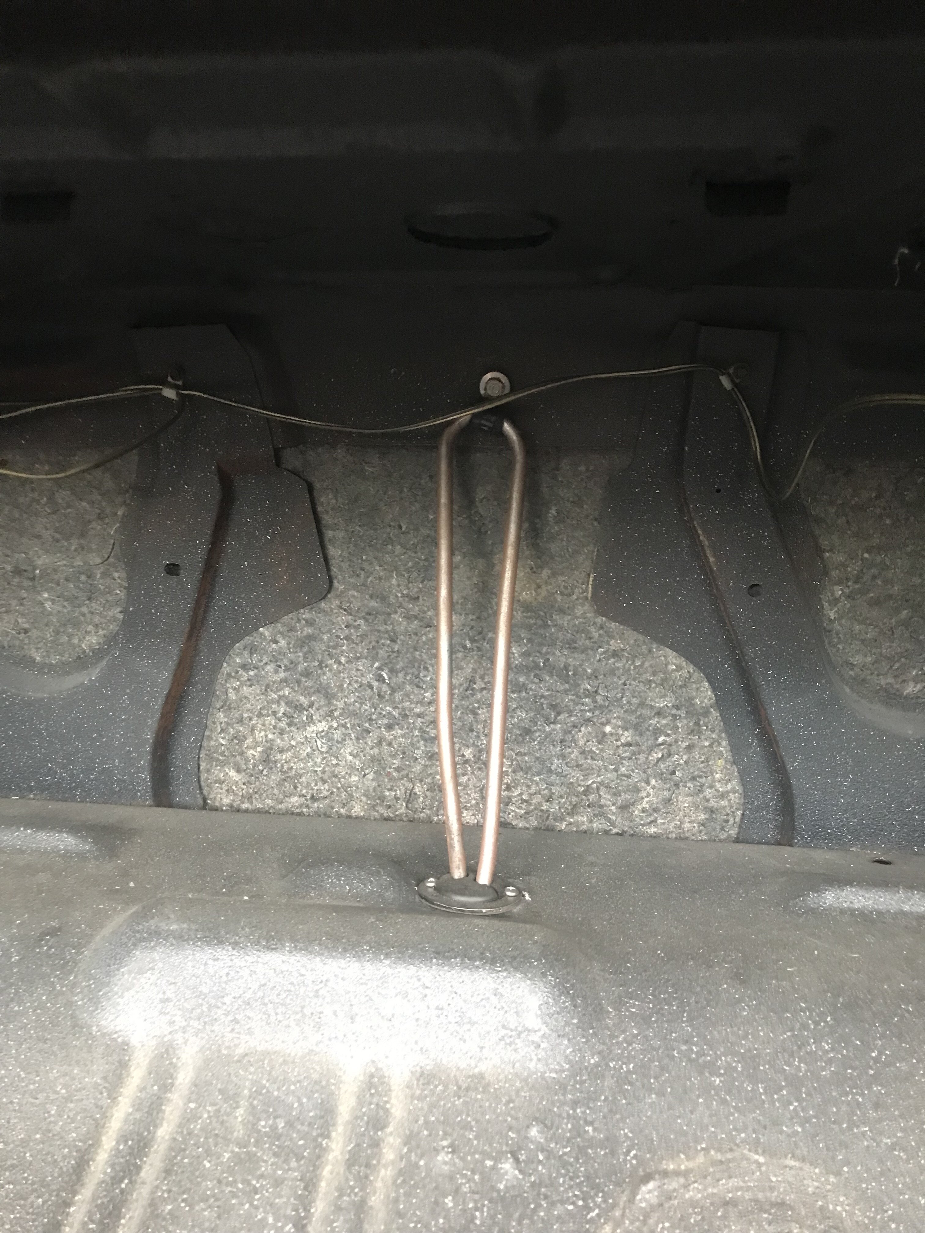

  1. A vented cap won’t vent enough to solve the issue!

  4. Hi all, For years (decades) I have seen many posts and interesting remedies regarding "vapor lock", gas smells when the car is parked in the garage, hard to fill the tank, that big whoosh that happens sometimes when you take the gas cap off... etc. My classic car experience has been mainly with 68 and 70 Camaros and a 70 Monte. These cars all have terrible factory fuel tank venting- if any at all! I drive these cars a lot in all sorts of temperatures. Certainly these issues are more prevalent in the warmer months, but who wants a car they can only drive when it is cold? Here is what I discovered: a gas tank needs a vent- and the bigger the better! A "vented cap" isn't going to do the job. It will spew fuel if you have a car that "leaves hard" (ask me how I know 😉) and it is often difficult to fill the tank without it spitting up the fill pipe. I haven't seen anyone really address this- they talk about venting but I've seen some questionable attempts. "Tanks" has maybe the closest diagram but it is important to get the vent well above the fill neck. This is hard to do on these cars- unless you run the vent pipe through the trunk. (NOT into the trunk!) Some makes (Pontiac and Mopar) made various attempts at this in the 60s but they used really small pipe. The photo is the vent pipe in my 68 Camaro. (It has an Aeromotive tank with a vent in the top of the tank.) This is a 3/8" hard line that runs from the tank, through the trunk floor, and then back to open atmosphere under the car (and I wish the line was 1/2" actually). The important thing to remember is that a big vent will NOT let fuel vapors out of the tank! I have seen people say their hot rod makes their garage smell like gas. It isn't vapor leaking through the lines... What is happening is that the tank gets pressurized and pushes fumes out. If a tank is properly vented- and this is important- it will not push fumes out! The vapors will stay right where they are in the tank if the tank pressure is the same as atmospheric pressure. And my theory on "vapor lock": when the tank becomes pressurized, it will push fuel up the line, through the needle and seats, and flood out the engine. OR if the tank goes into vacuum, it won't allow fuel to flow up the line. Yes, electric fuel pumps can overcome some of this vacuum / pressure, but it is really hard on the pump. A nice mechanical pump and a well vented tank gets the job done. Next time your tank "whooshes" when you open the cap, or you don't want to drive it because it might "vapor lock", or the wife is complaining she smells gas in the garage- take a hard look at how well your tank is vented!

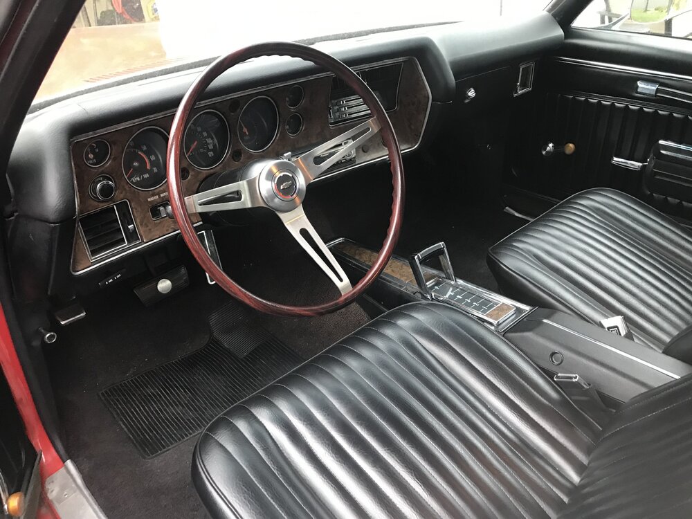

  17. As the owner of 1970 with a black interior, I always get blown away that they made other colors. Has anyone created a "Show us your non-black interior" thread? I could drool over the other colors for a long time! I especially geek on the all of the many little pieces they had to make in the the different color plastics.
  18. THAT is awesome! Now I'm wondering if I could use the factory insert emblem to do that. Gorgeous interior! (Love the factory non-AC heater controls! ;))
