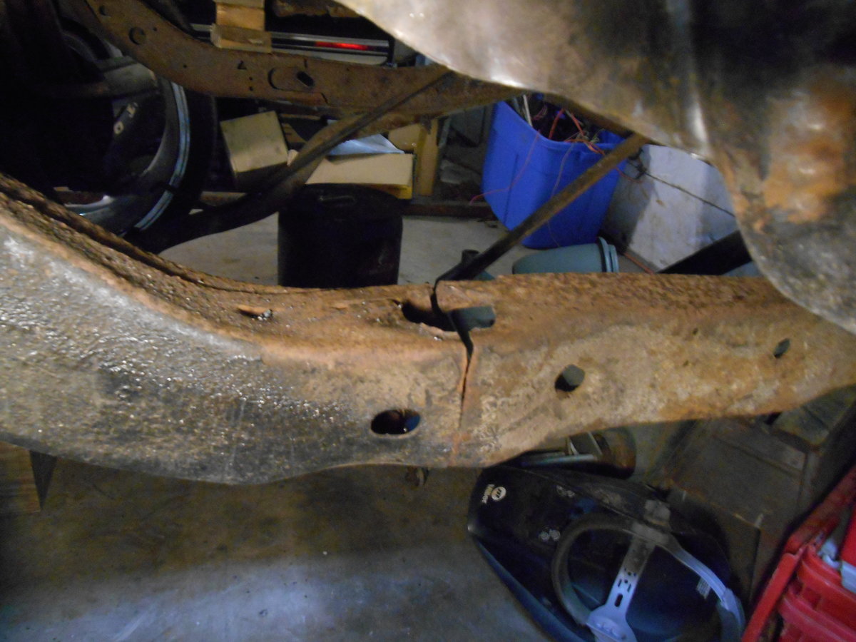

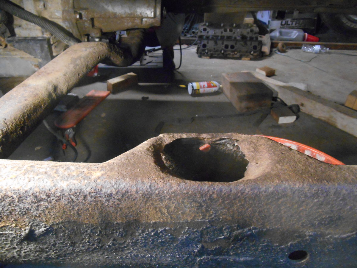

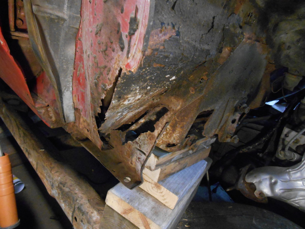

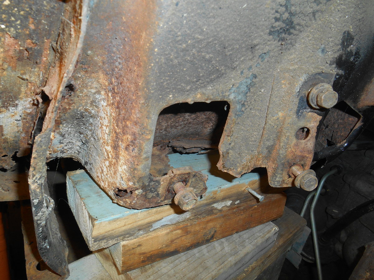

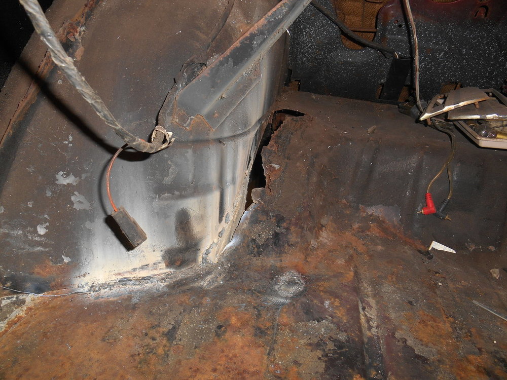

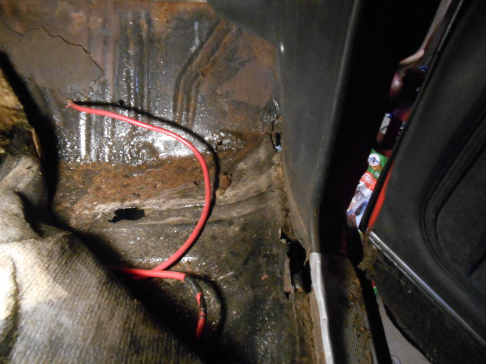

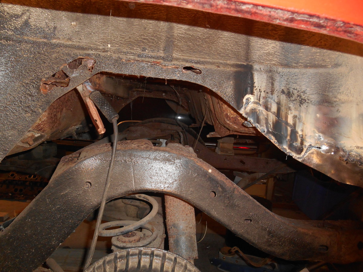

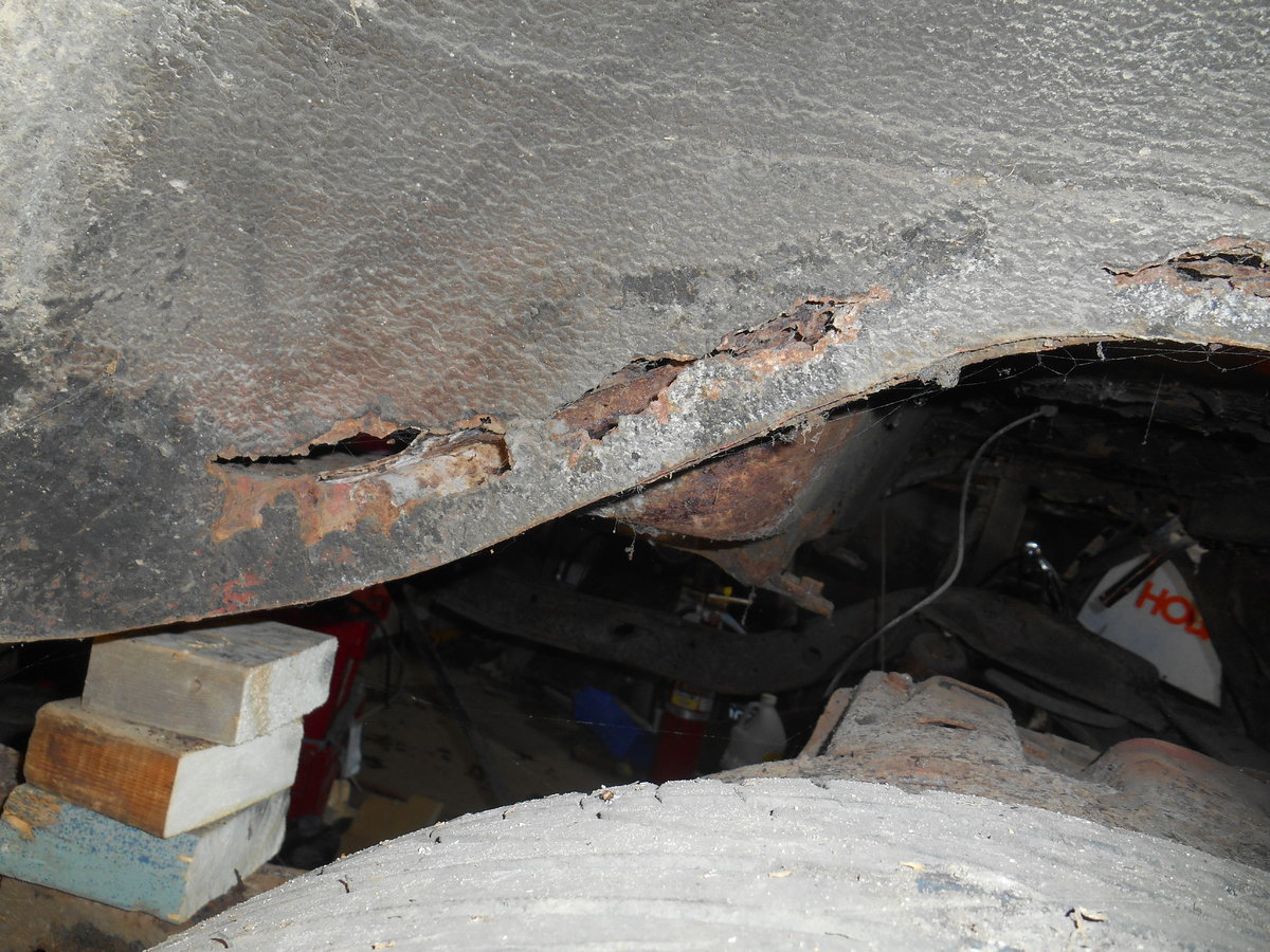

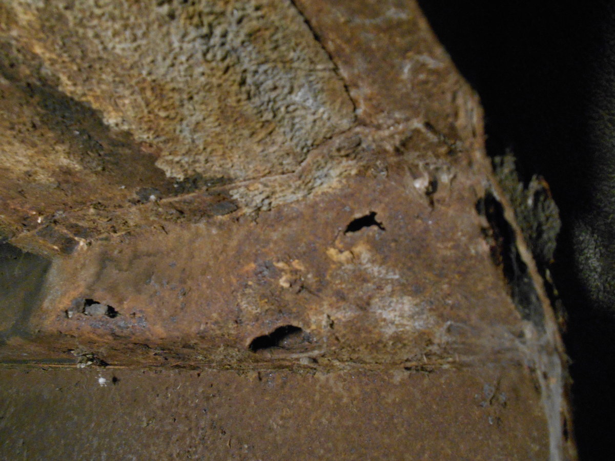

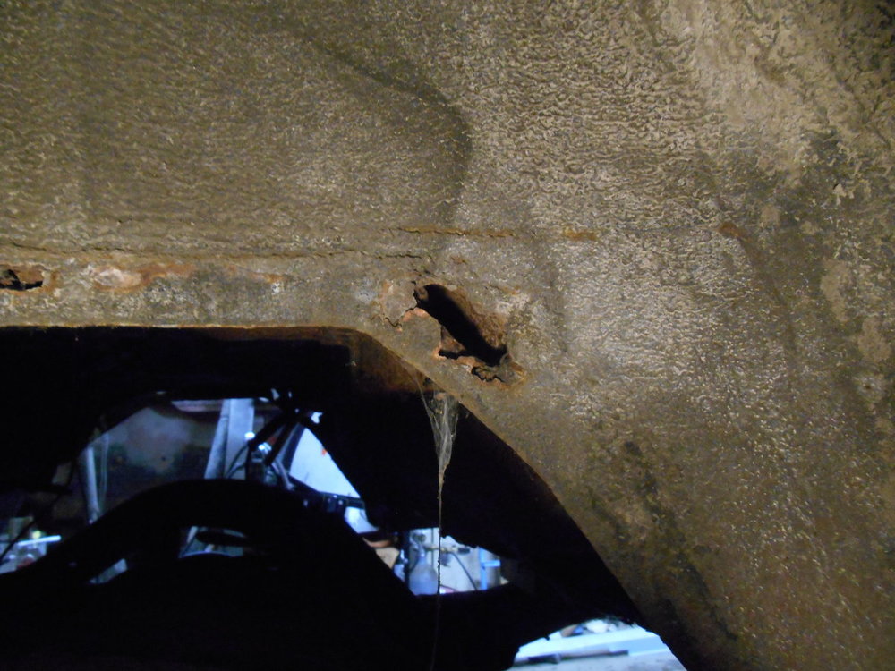

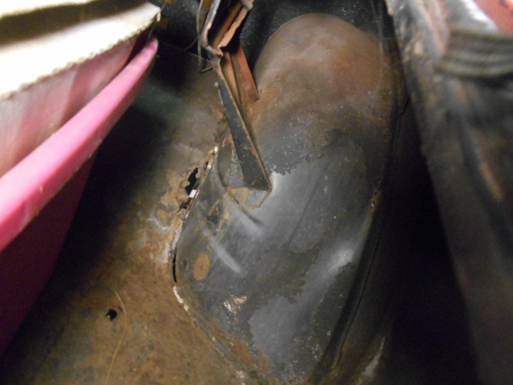

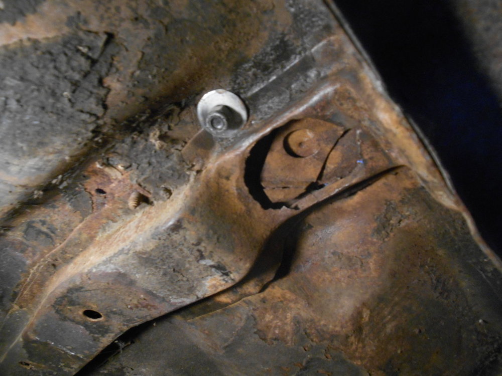

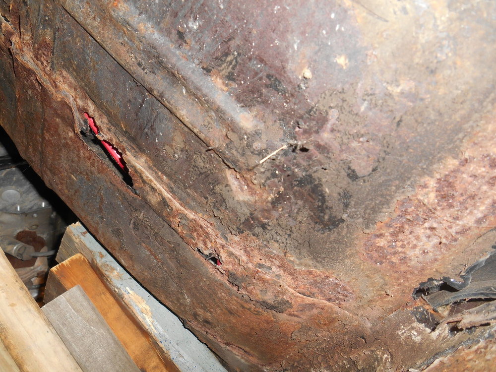

  1. I was just gonna do a motor swap on my 1970 monte carlo, when i realized that the body mounts and frame needed repair, so I pulled the body off and started rebuilding the rusted out sections of the body. I don't have the room to have the body and frame separate/next to each other so i have to just have the body lifted off the frame on blocks. I am using a flux core welder. it's kinda a big task trying to fix the rust, with not much solid metal to weld too, but it's coming along , the driver side floor pan i grinded out the rust and made plugs and patch panels out of a left over rocker panel i had laying around. the actual body mounts i haven't figured out yet , I don't see much for sale for body mount repair panels, so i guess i gotta build my own, the trunk pan wasn't attached to the wheel well and i didn't think i was gonna be able to line it up, but i found a spot that the metal was close where it was rusted/broken and was able to line it up and start patching and welding it there , I don't plan on making a perfect show car, but don't wanna do a hack-job ether, I would like to drive the car next summer (not worried about a paint job or anything like that) here are some pictures of where its at as of today. ,
