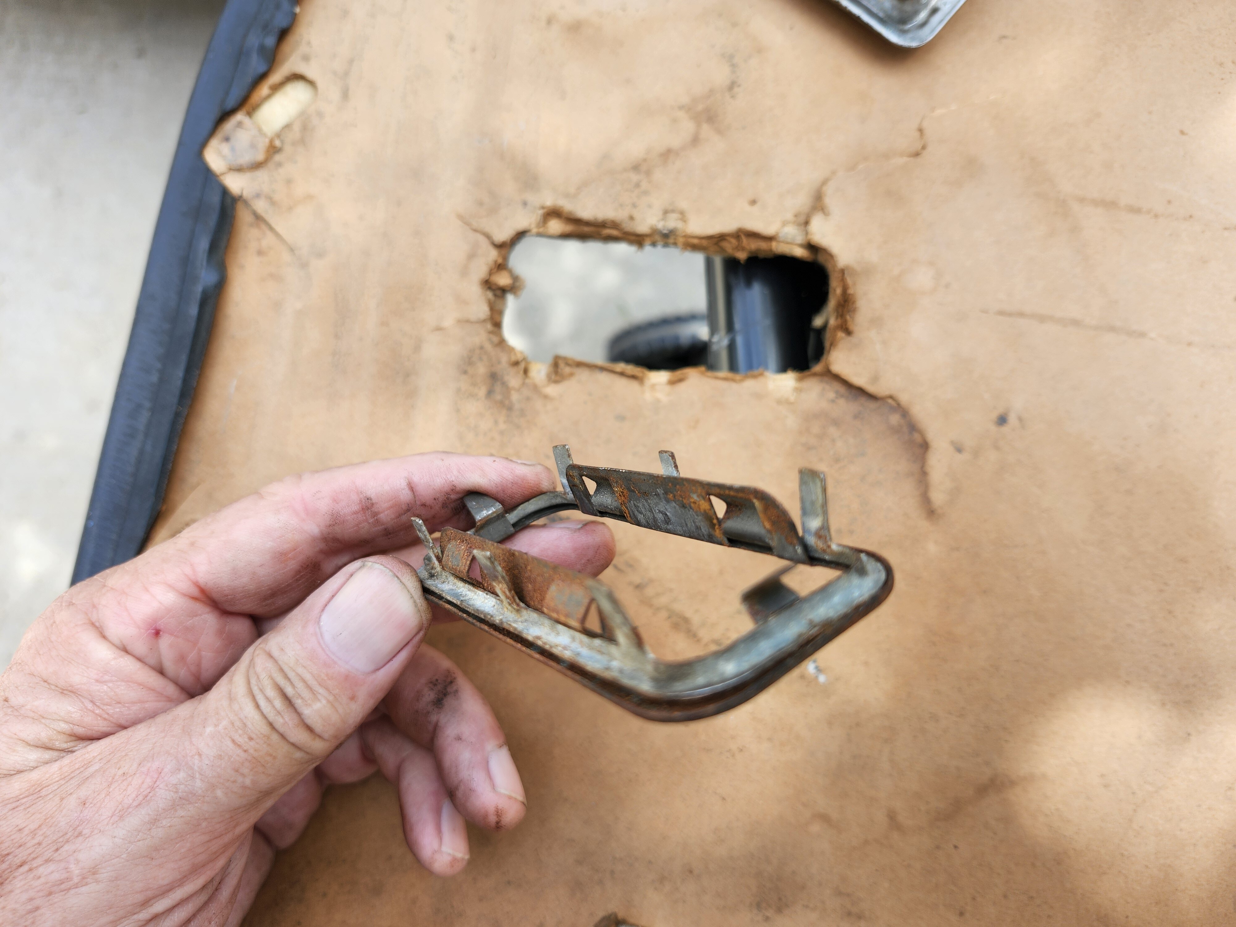

AHHHHH, hmmm. I was able to get the board to kinda snap in, but the fitment is not firm enough. I'm sure it will rattle off. But what you put me onto is that harness ends in that black plug, and that plugs into the back of the bakelite that is part of the switch assembly. I thought the bakelight was part of the harness. THAT i can work with. Might just super glue it back together. When i wiggled it out the bakelite came away from the outer switches, probably loose for a while since my windows were sporadic at times. Thank you Joe. -

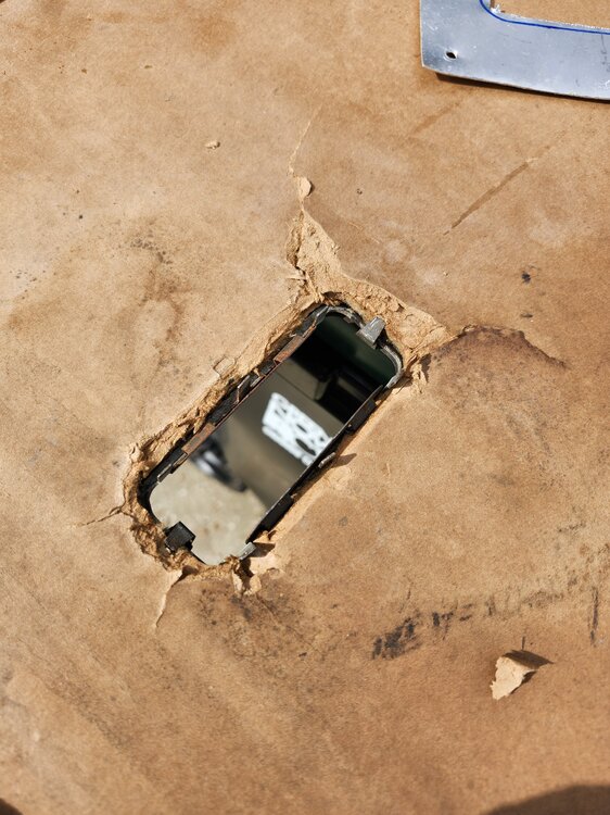

So i went a little further down the rabbit hole LOL. Having a hard time understanding the assembly. Tell me if i am wrong, but it looks to me like the bakelite board that holds the contacts and harness will nest into the rocker switch assembly. But i dont see anything that would keep it in there. So this clip in the attached picture must be doing that. I have the chassis service manual but could find nothing on this. It looks like i should push the harness thru the door hole, assemble the switch with this clip, and then press the whole assembly back into the door ring that i backed with that plate. It doesnt seem all that substantial. So i am wondering if a part is missing? I did find a round hard piece of plastic in the bottom of the door but that turned out to be where the window settles at the bottom of the door. Nothing else in there. I thought i paid close attention to taking it apart, but since it was already wonky I might not know an important step here. Does anyone have a diagram or procedure for installing this switch into the panel? Thank you. -
So I pulled the door panel off to see what the issue was. Looks like the panel board that the door material is mounted to was just old and coming apart. The cover material was in great shape so I didnt want to remove it all. I found some .025" thick aluminum (in the junk pile I never throw anything away) and cut a new backer plate for the switch. She sits in there solid as a rock. I would have used a different metal if i had any around. The aluminum is soft but in that thickness it works well and it works well. And its easy to cut with a sabre saw. Also, had to drill some holes and screw the plate down between two pieces of wood so I could get the saw around. I used the "sleeve" that the switch pushes into (last pic) as a template and just traced around it. Then drew the same shape again inside so i could get the tightest fit possible in the old panel.
