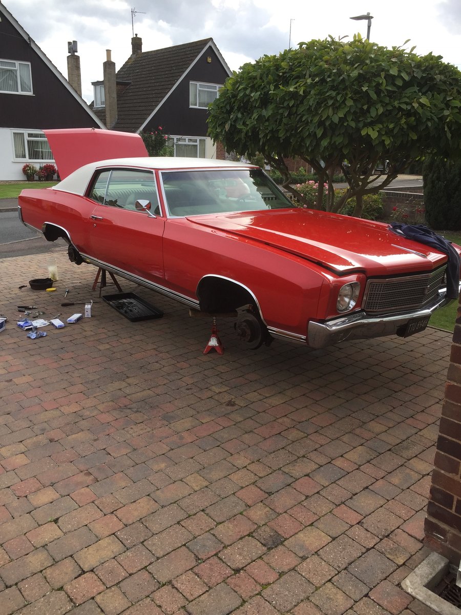

  2. Thanks for the advice guys, so if I’m going to do the top bushes as well I guess I’m better off loosening one side at a time to gain a bit of extra access and keep the axle stable. I’ll post some pics of how it goes as soon as I can get in the garage.
  3. On the floor with axle stands and a trolley jack. Not sure how ‘compressed’ the rear springs are in situ, don’t want them flying out if I try to lower the axle a bit to improve access to top bushes. Can’t seem to find any step by step info anywhere 🤔
