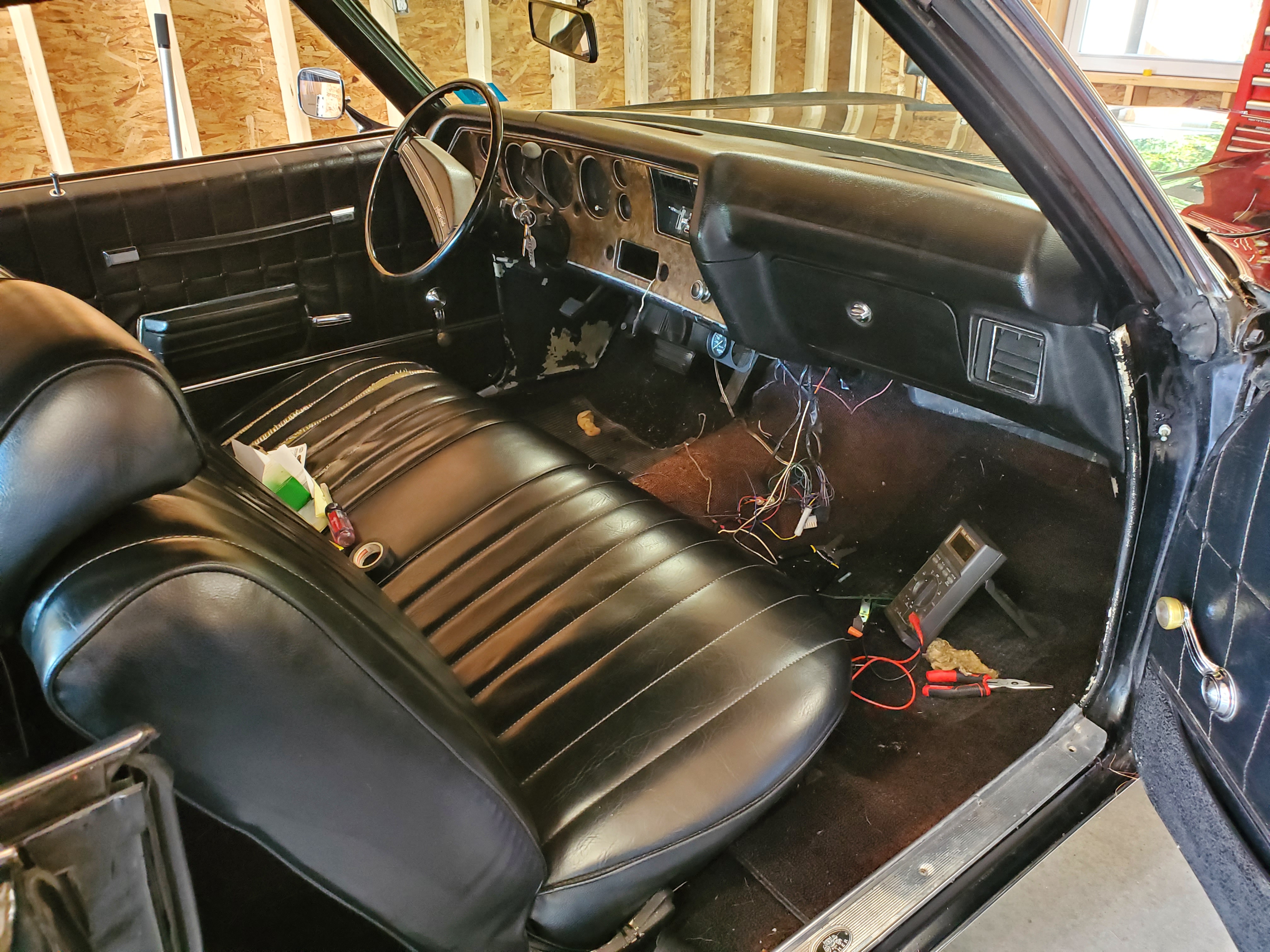

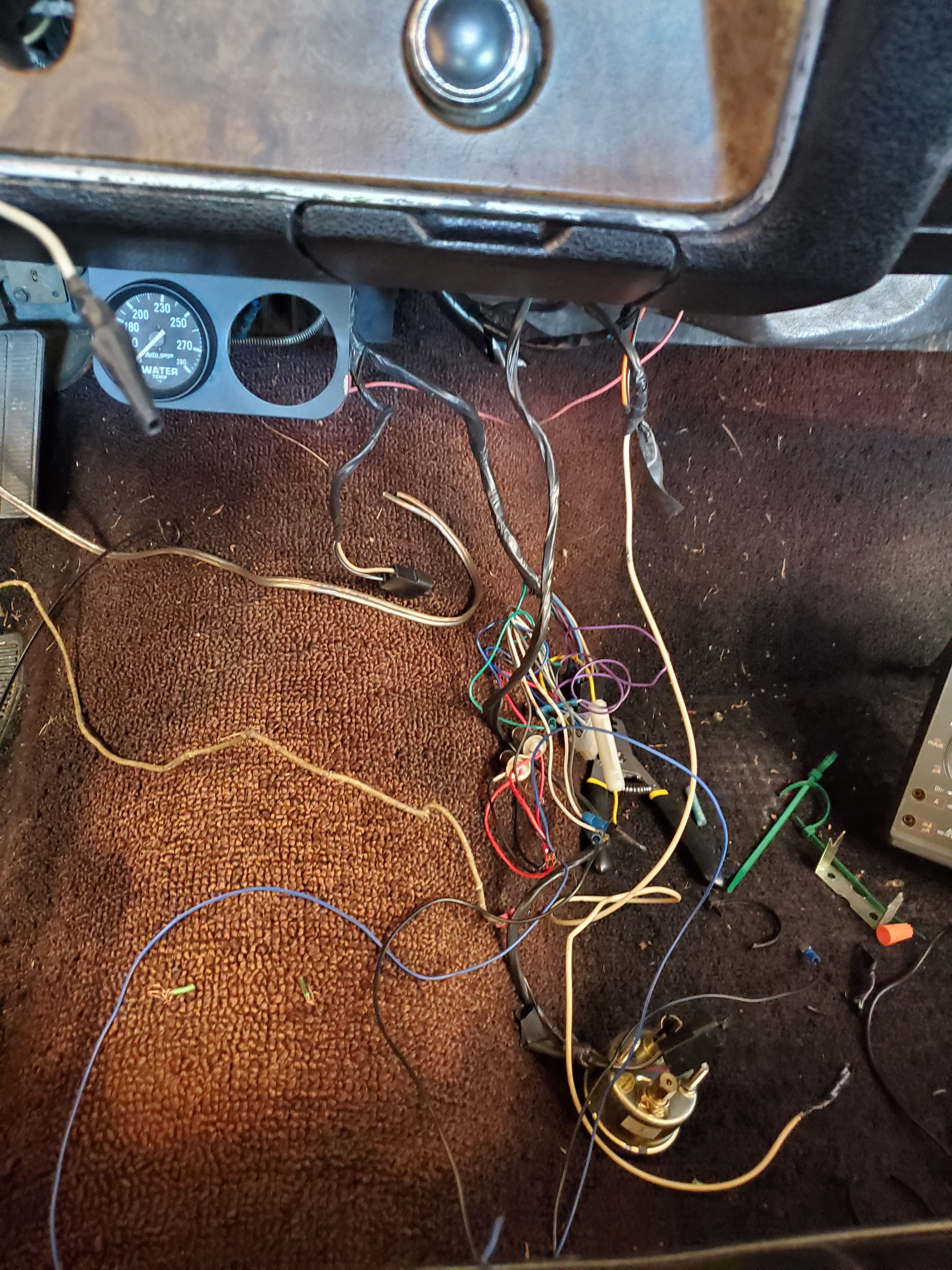

  1. Well, it's all sorted now. I picked up a cheapie multimeter at Advance Auto along with a bunch of new fuses. Blew out the fuse panel, popped in the new fuses and everything is as I thought it should be. Reconnected everything, one at a time and it remained open between BATT and ground the whole time. Checked the draw between the positive cable and the positive terminal and got nothing. Hooked the battery back up and all is right with the world. Maybe there was some crud in the fuse panel? Or maybe it was just a gremlin.. 🤔 Thanks for responding and checking your cars. This was driving me nuts and may again in the future, but at least it's working now.
  2. That's the rub, since I haven't re-installed the battery, I'm not sure if I have a problem at all. I disconnected the bulkhead connector and was able to isolate the issue I'm seeing to something under the dash. The odd thing is, even with all the fuses removed, and no battery in the car, I am still seeing continuity between the BATT teminal on the fuse block and ground. My old Fluke gave up the ghost a couple of months ago so I'll have to run out and grab a new meter and see what the resistance is.
  3. Maybe I'm overthinking this, but it's been a while since I've done extensive wiring on a 50 year old car, so bear with me... I just finished wiring in my Dakota Dash and while double checking everything prior to hooking up the battery and testing, I was checking for grounds and found the BAT terminal on the fuse block has a dead short to ground. Poking around, most of the other terminals did as well. I read between the positive and negative cables and there was continuity there. Disconnected the bulhead connector and pos to neg was now open, still dead short inside the car at the fuse block. Disconnected the D/D from the fuse block and those are now open, the grounds to the D/D are good. The only other modification was to remove the AC wiring since I put in a Vintage Air system. The wiring is straight forward with one wire going to the battery and another to the IGN terminal on the fuse block, a gouple of grounds and a heater control valve, which is under the hood. I disconnected one thing at a time (lighter, courtesy lamps, glove box lamp and anything else I could think of on a constant power circuit and no changes. Any suggestions? This is giving me a headache. Update: Tried the old test light trick (disconnected battery then put a light between the + battery cable and + battery terminal). Test light was bright as all get out, then realized the headlight switch was on(oops). Test light dimmed significantly after shoving it in. Pulled the fuses one at a time and it made no difference whatsoever. Seems something is pulling current in the car associated with that BATT circuit, but not anything fused. The question remains though, should there be continuity, at all, beween the BATT terminal on the fuse block and ground? I'm hesitant to connect the battery until I get this sorted. Any advice would be greatly appreciated.

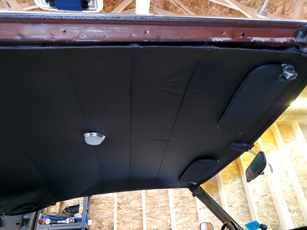

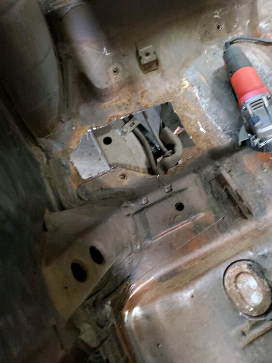

  10. Had a chance to start mocking in the seats, shifter and console. I'm still waiting for the drivers seat and a few odds and ends but overall, pretty pleased with the the way it's looking Got started on the headliner also. First time I've installed one and I'm pleased with the results so far. I'm still needing a few parts to finish, namely the new seat belts, sail panels and the window gaskets. Got a hint of the original color and decided to repaint the car next year. The classic copper is just too gorgeous Also, cut out the rusted spots under the rear seat and welded in patches, painted and installed Dynamat. Also, I went ahead and ordered a Dakota Dash (RTX) to replace the stock instruments and a Retro Sound Laguna radio with from and rear speakers. Seems like every time I go out to the car to fiddle around, I find 5-10 other little things to take care of of "while I have it apart". No biggie, summer is a ways off..
