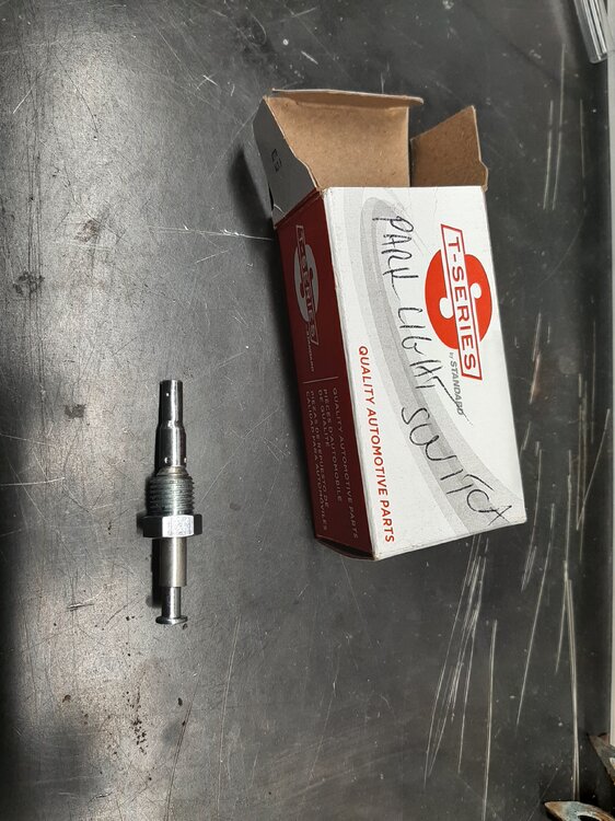

  16. Thanks JFT69Z. Picture and links were very helpfull. I didn't notice the holes by the ratcheting assembly. Did a complete search of everywhere in the shop (I hadn't throw anything away during disassembly) and found the original switch. Many thanks to all for the help.
  17. Thanks for the PN.
  18. Thanks Scott. I agree with you on the assembly. It was on the car when I got it. Everything in that area where it was mounted had a lot of rust and rot, whereas the assembly was in really great shape. So yeah it was most likely replaced at some point. It shouldn't be to hard to make an L shaped bracket to mount it.
  19. Thanks Rob, the picture helps. My setup is a little different so I'll have to MacGyver a bracket to mount the switch.

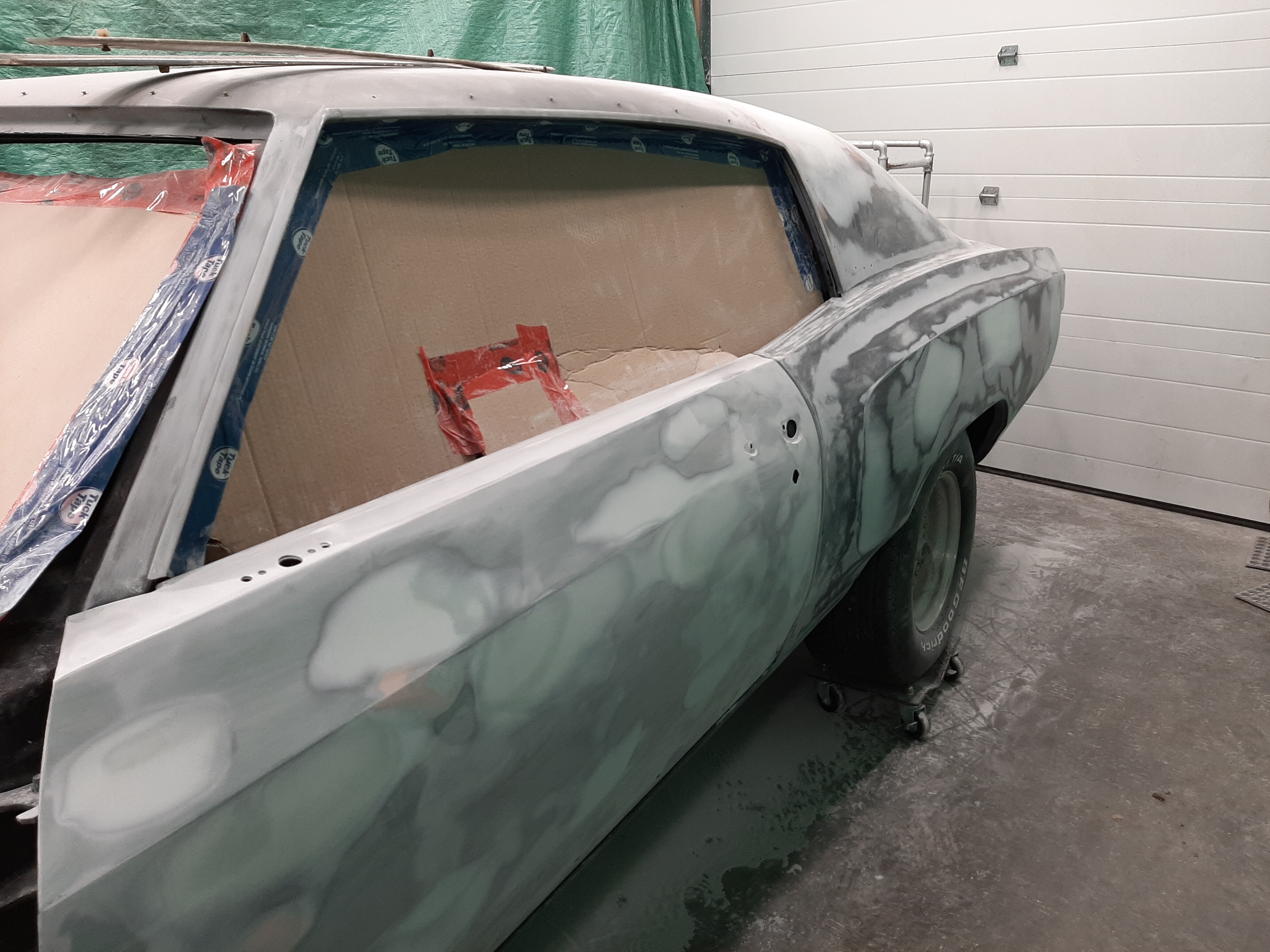

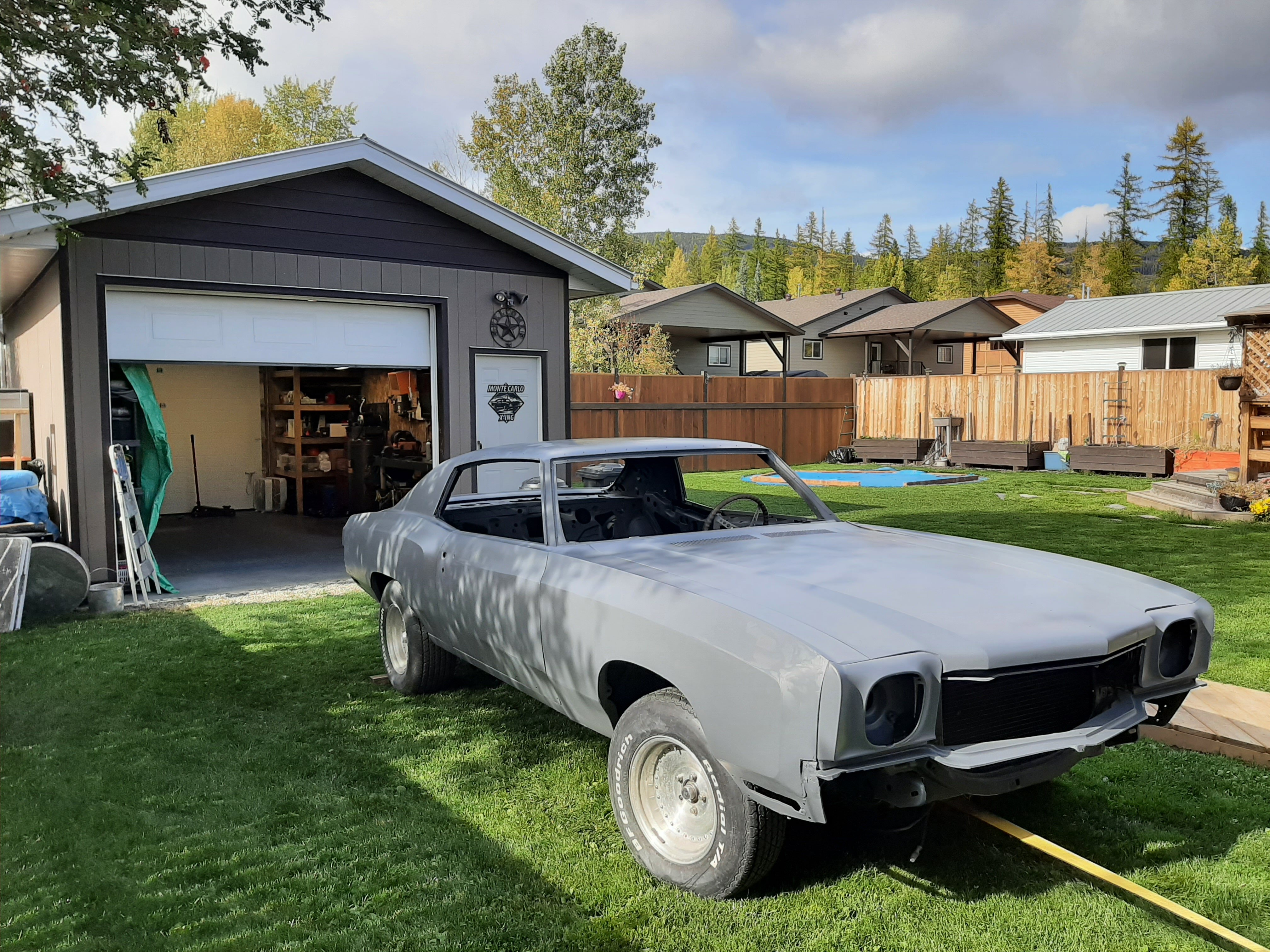

  21. Waited all summer (2021) for the border to open. Fenders and hood had been on BO since Dec 2020. Still waiting for them. Lost a complete summer on the project. So we decided to use the old fenders and try repairing them as best we could. Sand blocked the body after, the results were pretty good. Then I ordered Eastwood Gray Epoxy Direct to Metal primer sealer along with about 4.5k USD in trim, interior and other parts to be shipped to Eureka Montana. Then waited for the US to open its land border for non-essential crossing. The stuff would be there and ready for pickup. Well after they announced another extension to September 21. I couldn't wait anymore, it was starting to be to cold to paint. So I gave it a try, Border Services Officer was understanding of my plight and let me in to get my parts. We managed to get 2 coats of primer on to protect the metal until next spring.
  22. Hey, I'm a little late in submitting this but. We did both full quarters, didn't encounter any fitment issues. Just used a lot of screw before doing any of the spot welding, If you have a plasma cutter it makes removal a lot easier. We also ended up replacing the rear inner/outer wheel wells and both sides inner trunk filler panels.
  23. Yeah it's a step by step process for sure. We'll be taking our time with it. I've kept some of the old sheet metal , ( trunk lid, hood ) for us to test our blocking, preping and painting techniques.
