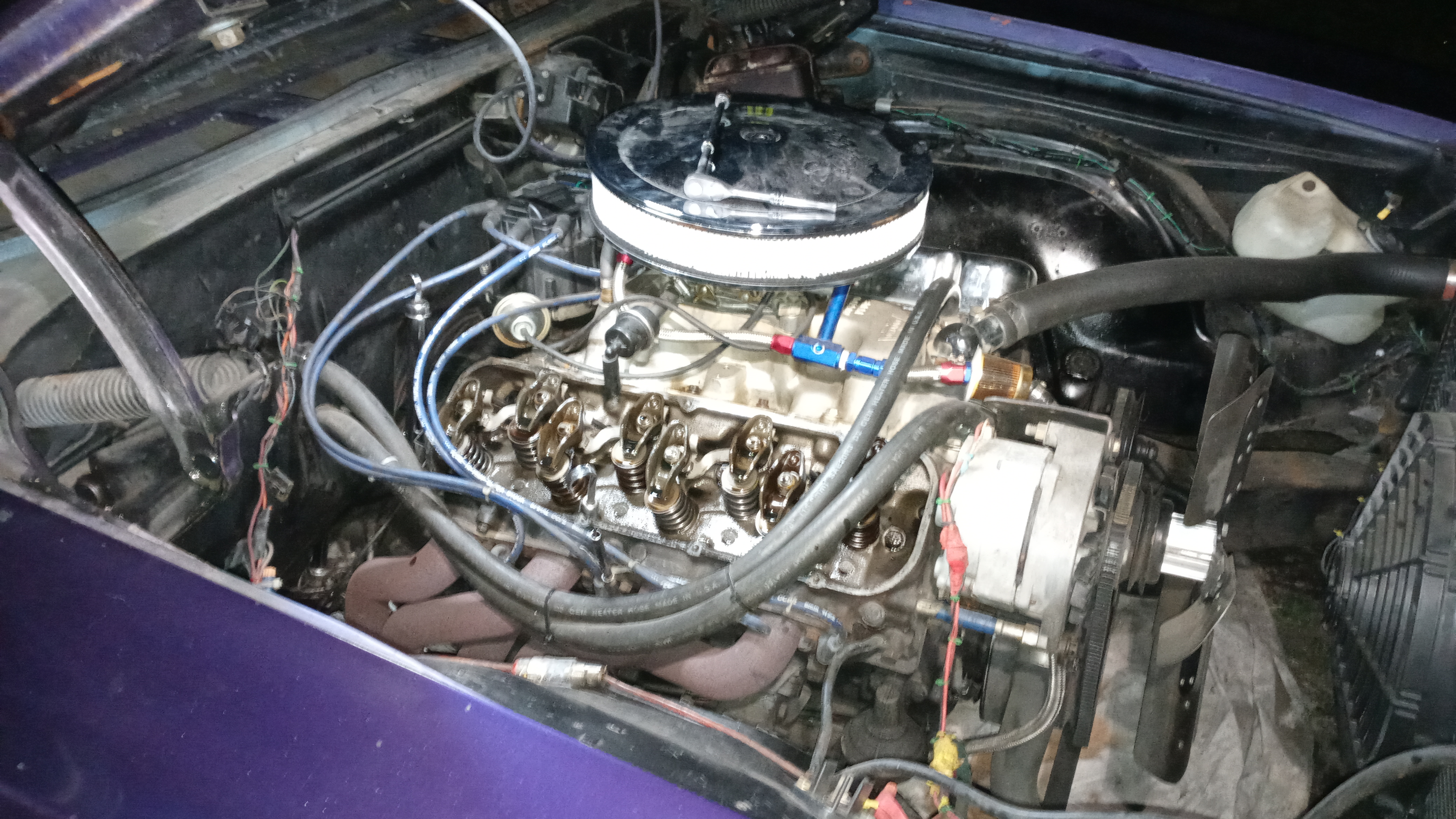

Its a good day guys. Changed the oil to rotella 10-40. All the clacks knocks and rattles went completely away. It had really runny oil in it. Also found out why the new carb didnt feel right. The throttle cable assembly was too far forward not letting the pedal give the throttle full gas. What a couple knuckle head mistakes. Also MC1of80 should get a kick out of this.... The fan you had repeatedly said I should remove before loosing a finger.. In the middle of reading the instructions about tuning the choke I fired it up and watched the paperwork get sucked into the fan and obliterated. I laughed my [censored] off. Tightened a few of the bellhousing bolts. Got rid of the rolling vibrations over 40. Temperature hangs around 220-230ish. 205-215 cruising. Took about 5.5 quarts to get good on the stick. -

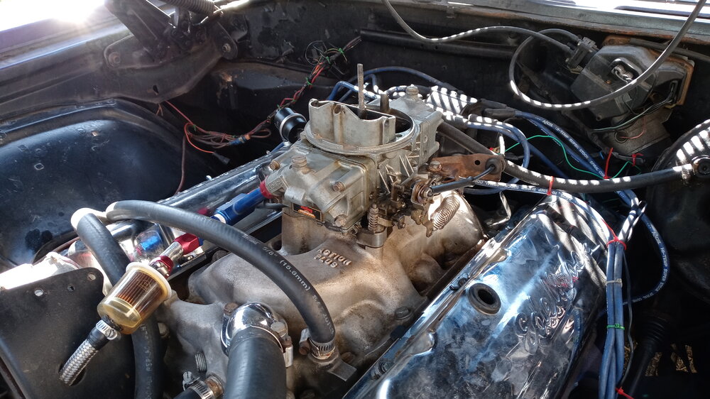

The electric fan is still working. Put a 30 fuse instead of the 25 that was in it and havent had a problem since. The car definitely sounds better starting and idling. Reasoning and idea behind the 670 was to get a proper working carb. Its weird to me the new bigger cfi carb feels like it has less "balls" to say. I Didnt expect it to melt tires or anything but i did expect atleast the same umph as the silicone mess of a carb that was on it. Maybe just needs tuned? Just went to replace thermostat and there wasnt one in it. I put a new one in it with new gasket. Also straitened out a kink in the like 4" water line connecting the waterpump and intake. I bought the stuff for a oil change. No one could tell me at the parts stores exactly how many quarts or specific type. After google I ended up with 10w-30 6 quarts and 1 quart of Lucas stabilizer. Plan on doing the oil tomorrow if that sounds right also connecting my oil pressure gauge since it says the port is above the oil filter. The oil in it now seemed really thin when i adjusted the rockers. Little dirty also. -
Well guys I finally bought a new carb. The old one was a 650cfm. Alot of you guys suggested a 750 or up. Im just a cruiser. I ended up getting a 670cfm Holly. Its gotta be better I am horrible at adjustments and fairly new to Big engines. Once everything was put on it came factory set to 1200rpm idle. Finally got the idle to around 700-800rpm. It runs decent but seems like it lacks a little when driving. Still have a rolling vibration under car anything 45+. Also before the new carb my temp hung around 160-180F. Now its getting up around 200-210. Just bought a new thermostat Im about to put on. Whats average running temp on a 454. Pretty sure its mostly stock except headers,intake and carb. Also special thx to a few of you guys who have really helped throughout the process of getting it running decent. Did rocker arm adjustments while running. Loosen til tic, quiet tick +1/4turn. Now im noticing when it heats up i can hear a couple arms ticking. So ill be trying to quiet those down tomorrow also. Just a update. Thx guys. William

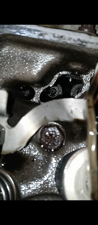

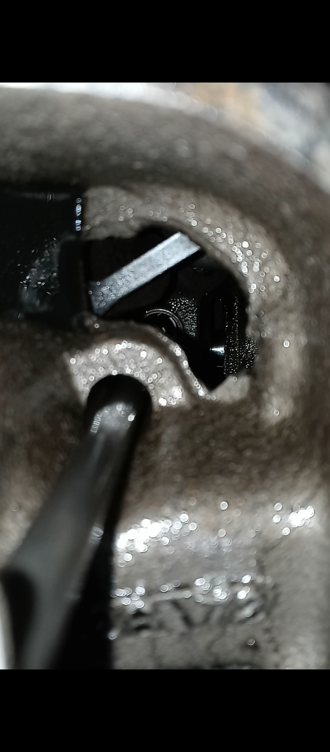

I was expecting to see maybe some shavings of scarring. Maybe even a lil sludge. Nothing. I did notice the harmonic balancer doesnt seem off balance its self but the crank belt pulley has a wobble while running. Power steering pump has a constant faint wine. Electric fan has a inline fuse thats blown. Just wondering what u guys can say about it now that you can atleast see the head. Thx. William. This was a message i apparently nvr sent. When i sent the other 20210127_155559.mp4 -

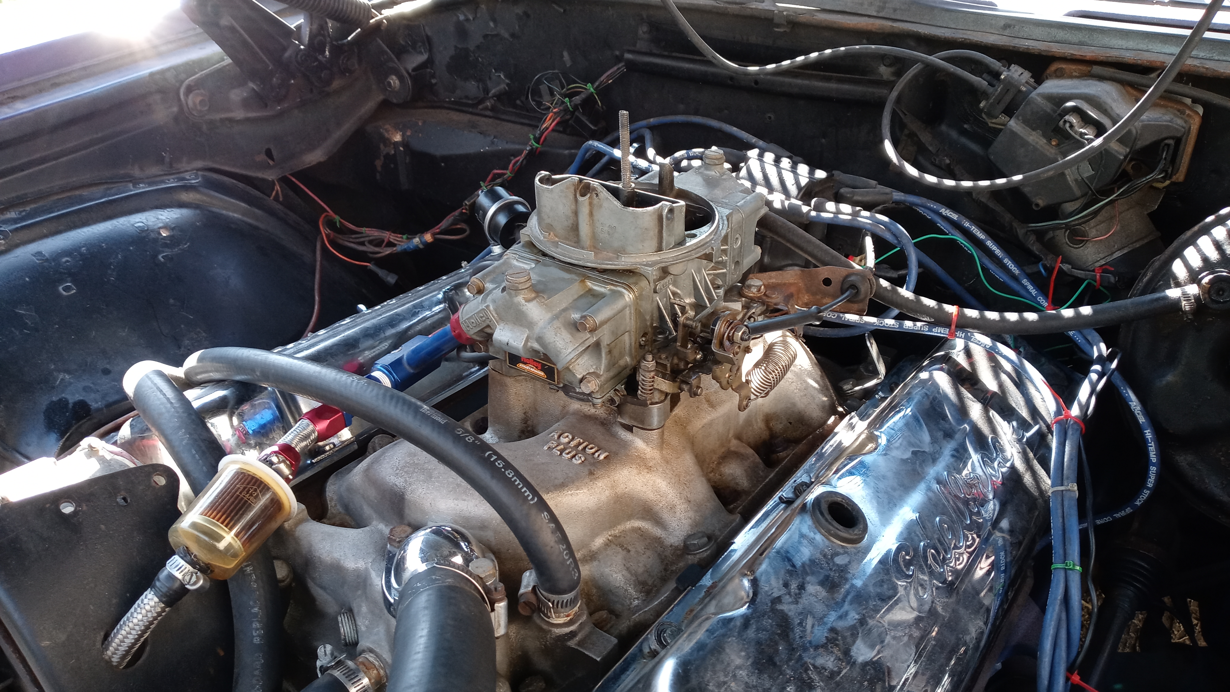

Seeings as my carb has been compromised does it appear I would still have the necessary linkage to hook up a proper Carb such as said one. Im also looking to replace the air filter and inline fuel filter. I dont mind paying a little more for a significant diff in performance. I also care not about fuel efficiency. -

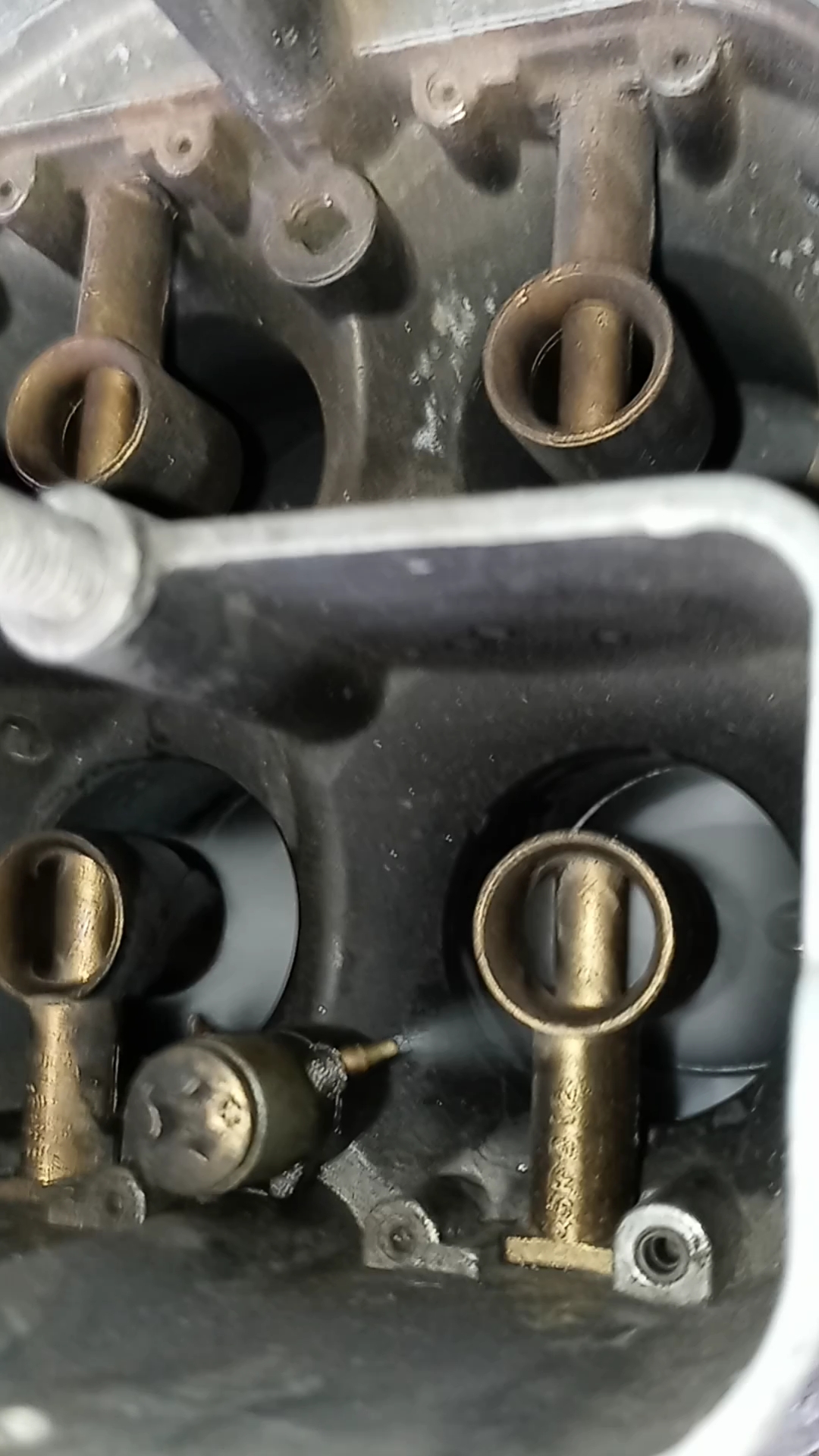

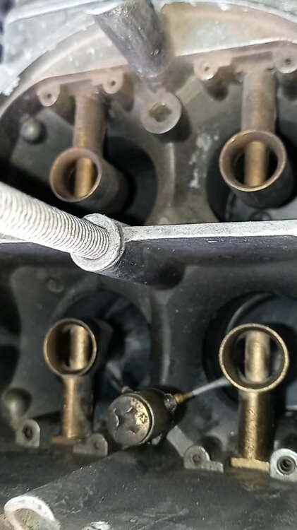

I cant get the videos to load up right😠best I can do right now is some stillshots in carb. Think they sealed off half the carb. It Idles feels like its running HARD, . Like a tractor hard. Like the rocker arms are loud. I gave it a quick Qtr throttle by hand expecting a idle up.. Like a wind up but it was Immediate load high rpm. When I put it in gear it idles down significantly though. Also in the process of cleaning it up. Took a good back of car pic and a interior pic now that i can fit in there. Im 6'1 280lb man. This guy had bolted the bucket seats almost to the dash. I moved the driver seat back to a more comfortable position. The passenger is still way foward. Anyway. Let me know what you guys think. And i cant figure out how to remove the failed videos. Disregard. -
