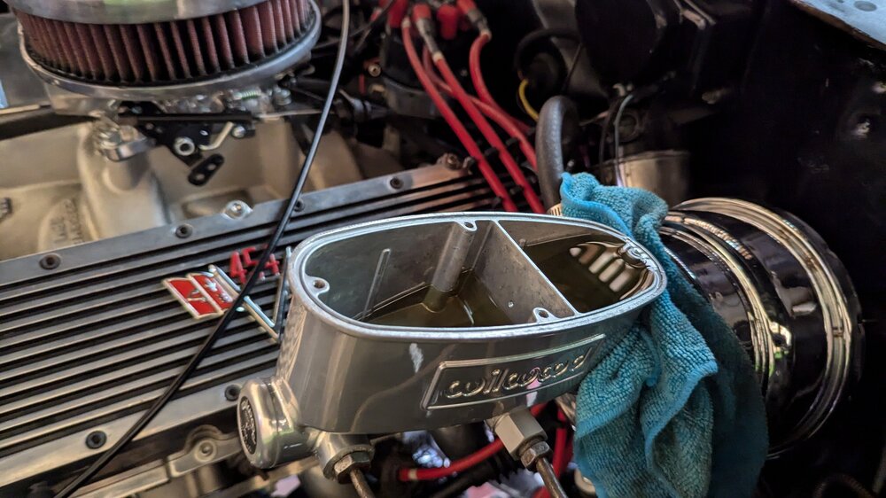

It really is hard to believe they don't think it's angled on Montes. They even called me to tell me that I am "using the wrong booster bracket and to shim it straight or replace it". Even after telling the guy that I verified it with 100% certainty, he didn't believe me. So weird. I just gave up.
For future reference, I don't recommend buying Wilwood Master 260-8555 for our cars...as recommended by Wilwood for my '72 Monte. They also refuse to believe that the Monte or Chevelle came with an angled master from the factory (mind numbing). The correct Wilwood master would have been 261-16962. https://www.summitracing.com/parts/wil-261-16962-bk?srsltid=AfmBOoq_ClTA7PgInH8UFonIOs7Pwi0pcLEDfjh-DiiGC4xZokNQE9of8Bs

So I upgraded my failing master with a Wilwood. As you can see by the photo, this particular Wilwood doesn't handle the angle. It shares fluid from front to back and if I fill the front to proper level, fluid runs out the rear...even with the seal and cover on. So Wilwood is saying that '72 Montes shouldn't have the angled booster/master and I have the wrong booster. I'm fairly certain I removed the original booster and master and it was at the same angle. Right?
