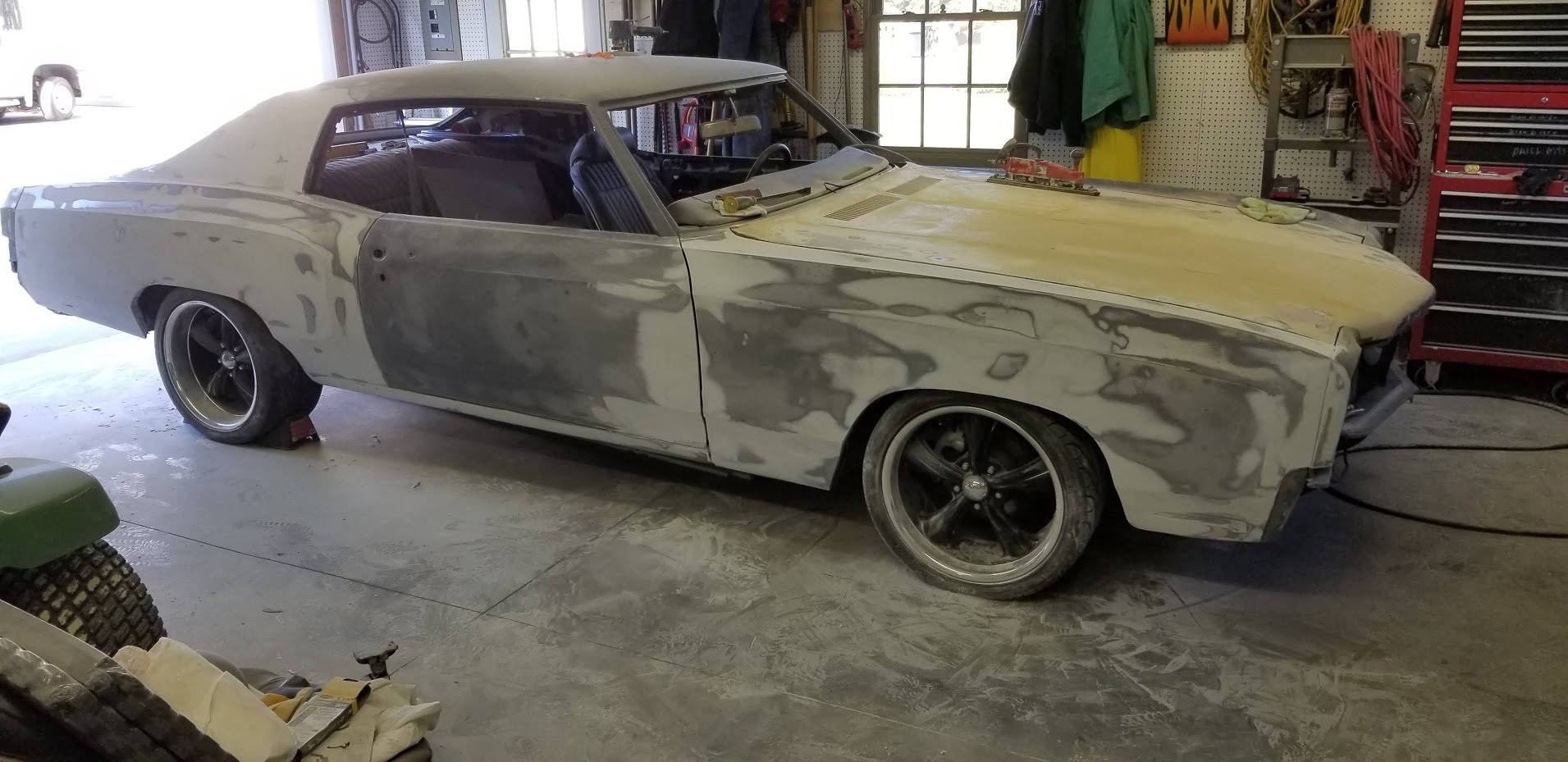

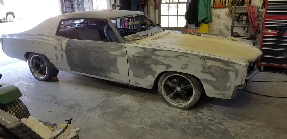

  2. Over the last few days I got the fender and door ready for some polyester primer and replaced some rotted metal on the front of the hood and began sanding it down.
