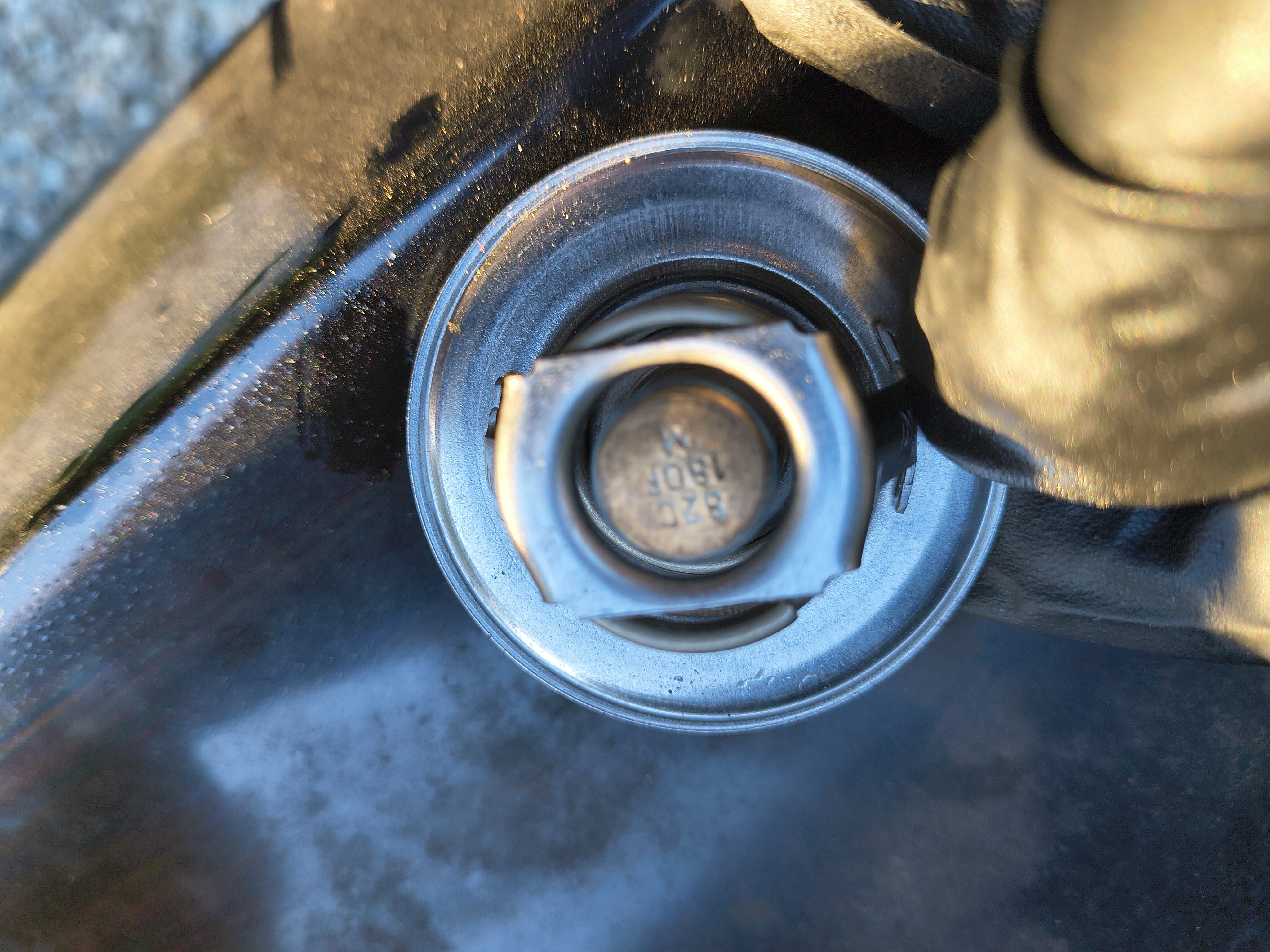

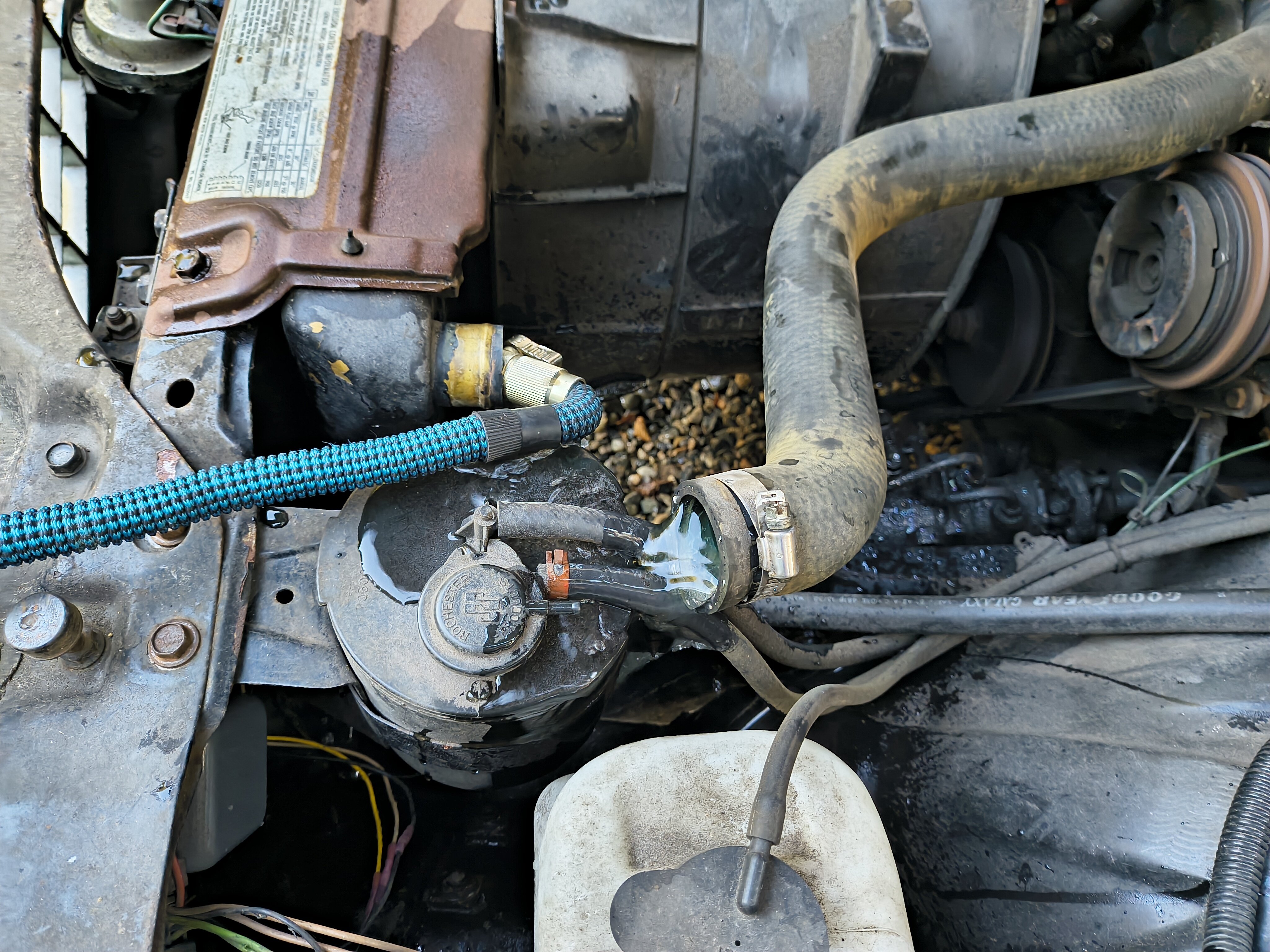

Update on the cooling system inspection: I'm not going to make a separate thread. I don't think this forum needs another dedicated thread on such a simple system. Anyway, - when I pulled the radiator cap off, I could see coolant about halfway down the radiator. So a little low for sure. I know I've filled and burped the system before but it was at least a season ago. - I pulled the lower radiator hose and drained all of the coolant into a bucket - I removed the thermostat housing and discovered that there IS in fact a thermostat in there (yay). It's a 160F unit, which was a bit surprising. - I pulled the thermostat out, replaced the housing / rubber oring gasket, disconnected the upper radiator hose at the radiator and flushed the cooling system. I put the hose into the radiator and let the upper radiator hose spew fresh water onto the ground. I let it run for a while like that for a while, with a few high RPM revs to churn things up - the water looked very clear with absolutely zero signs of corrosion in the system (yay). And the water pump seemed to be pushing an expected volume of water, and increased with RPM. - the upper radiator hose ended up laying against the AC belt / pulley and now needs to be replaced (bummer) - I filled and burped the system with fresh water (no antifreeze) and left the thermostat out. - I took the car for a rip around town and it never got over 180F So no smoking gun here relative to my intermittent high temp issues. I can't imagine the 160F thermostat was doing all that, but I might be mistaken. The coolant being a little low ... maybe My plan from here is to go ahead and put the 180F thermostat in, leave the 100% water for now, fill and burp it, and run it to see if the issue reoccurs. If it doesn't then I will drain the system of straight water, refill with 50/50 coolant and call it a day -

@Rob Petersand @Scott S. I actually don't even know if there is a thermostat even installed to be honest. I bought one, and all of the associated essentials, from an O'Reilly's when I went on the first 2+ hour road trip earlier this summer and saw the temp creep up past 210F. It's still on the shelf. But yeah, one of the first things I will check. While the water pump isn't making any noise, I do question whether it's functioning optimally. Could be anything at this point I suppose. Given how bad the front (and rear) main seal leaks I may be in for a might-as-well strip the whole front of the engine down. We shall see. First things first though is a good coolant system flush, check flow (water pump) and see if a thermostat is in play. -
