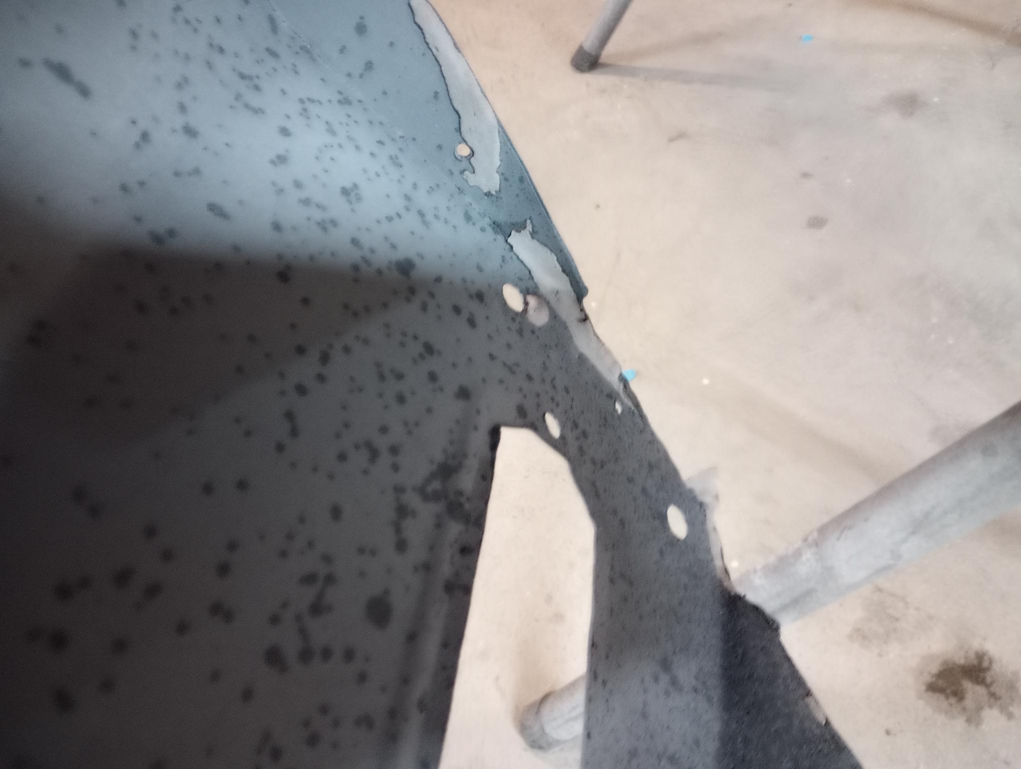

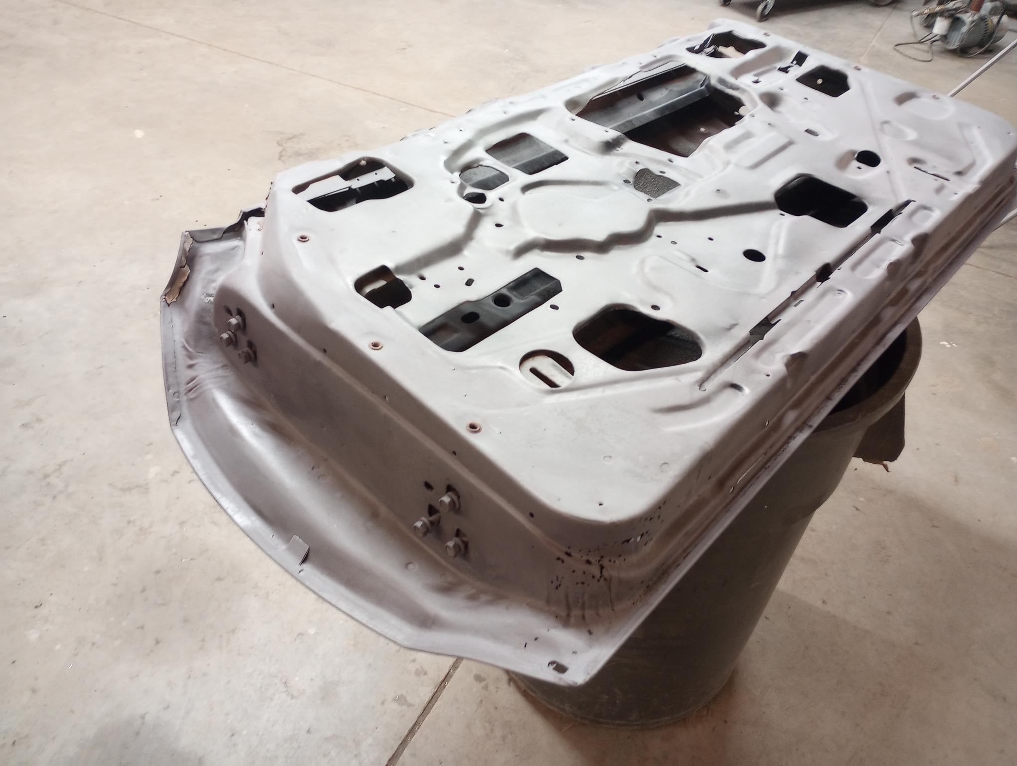

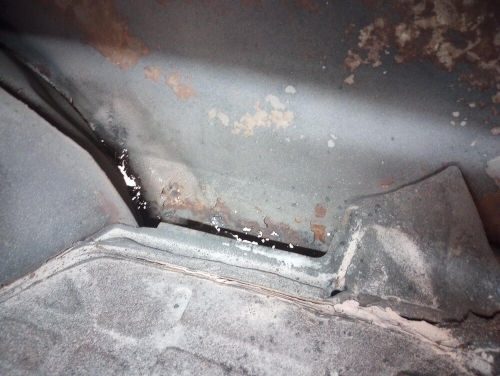

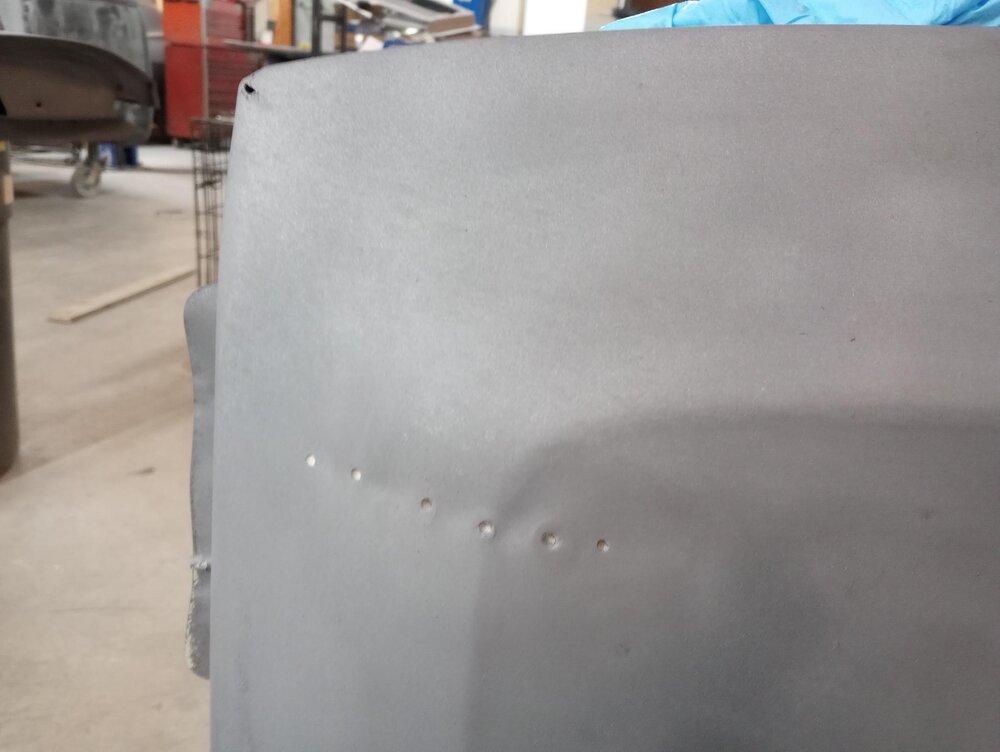

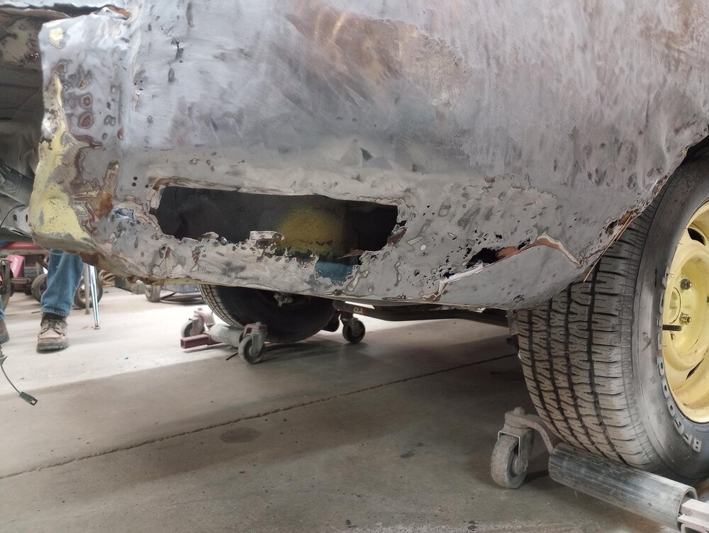

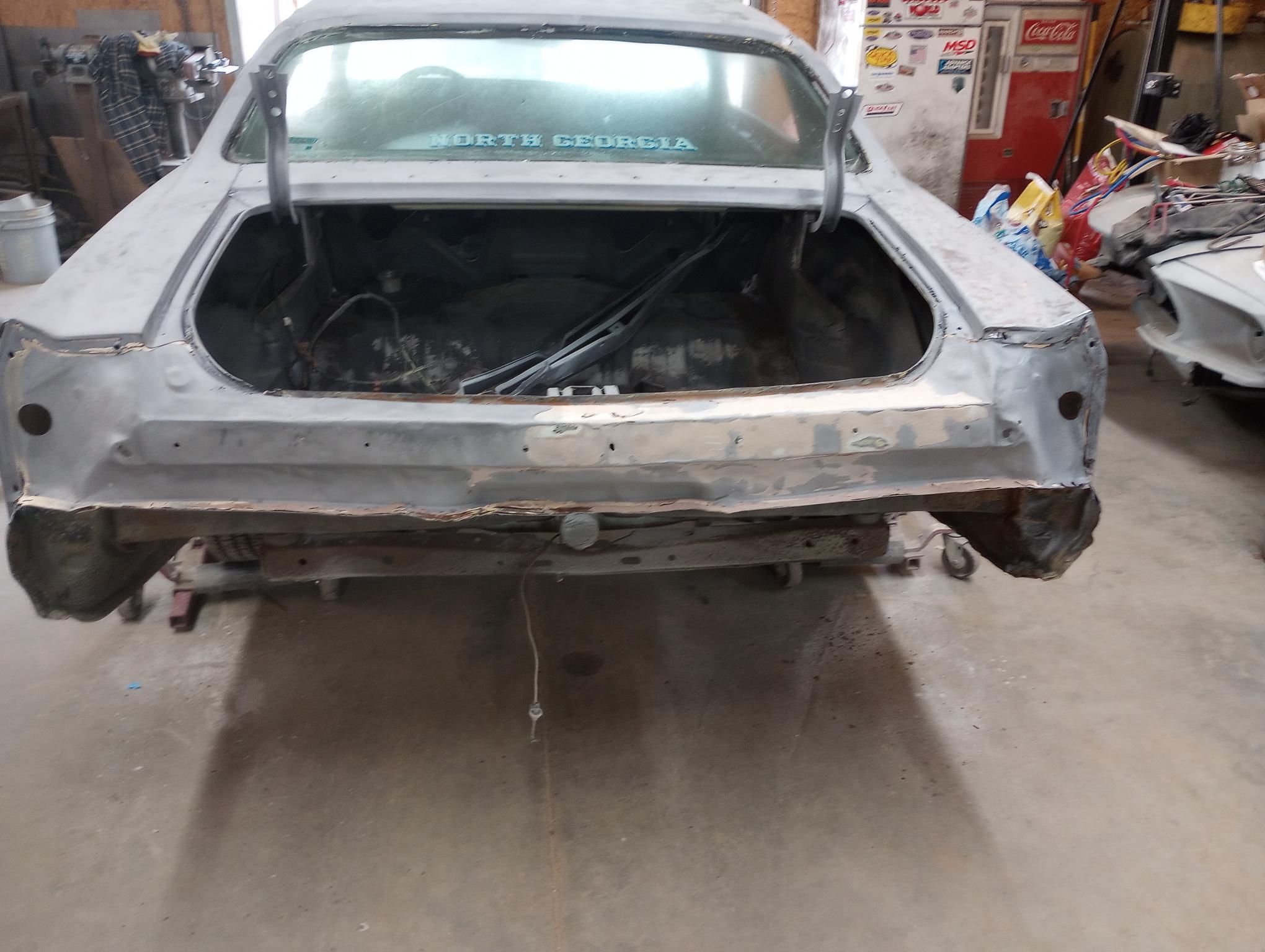

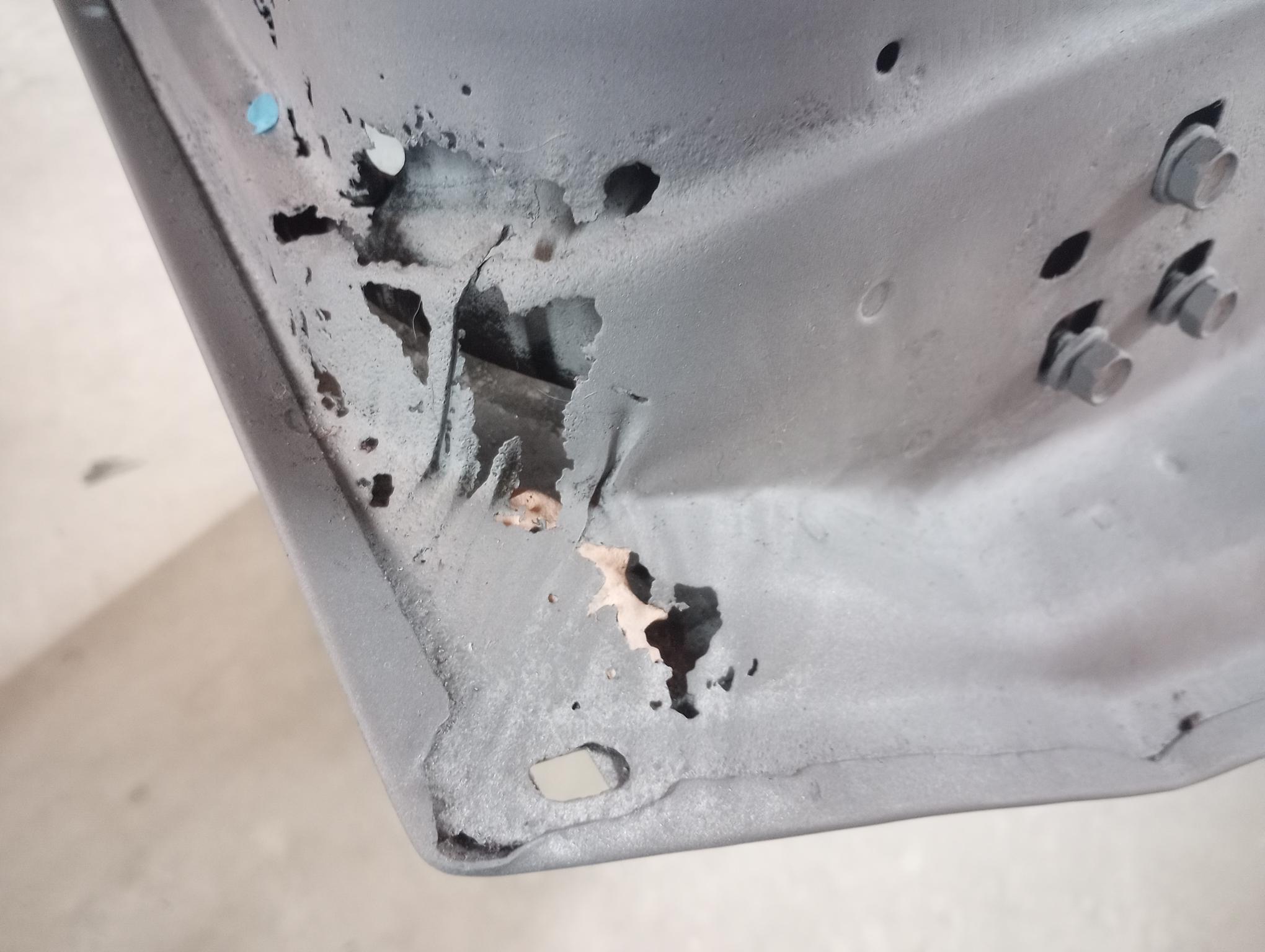

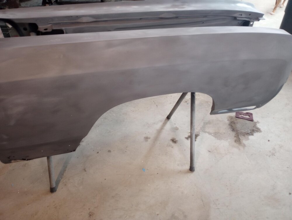

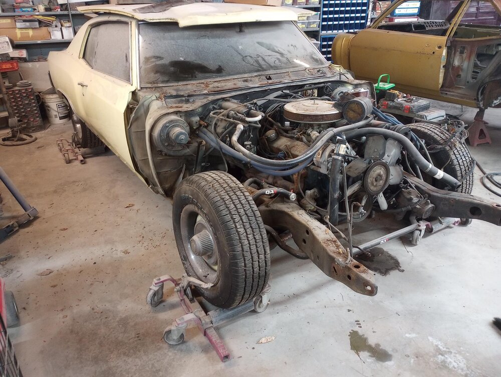

  8. And as promised here come some pics. Disassembly is underway and sandblasting. As always the removal of paint revealed a lot more problems that I had hoped. Apparently at some point before I bought it in 1984 it had gotten hit in the rear and there was a lot more rust than I realized but it's still fixable and will be done right. Luckily I have it at one of the best bodymen and metal workers around in Clint Morris and Morris Body Shop and Restoration in GA.
  9. Oh and yes that is a new gas tank. After sitting for over 25 years with old gas in it I decided to go ahead and just put in a brand new tank.

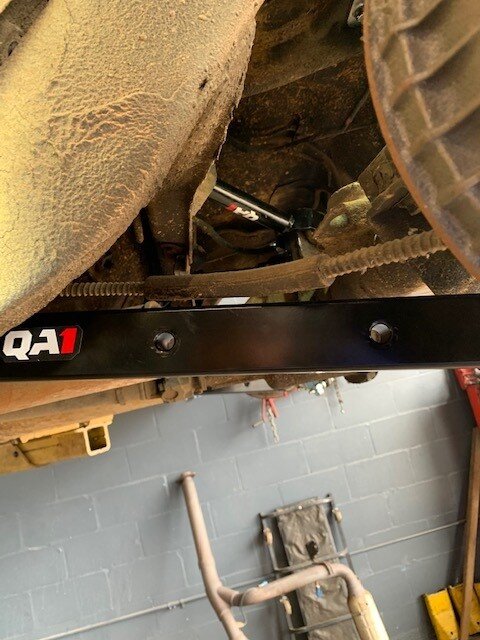

  12. Everyone said they like pictures so here's some pics of the QA1 level 2 suspension installed.

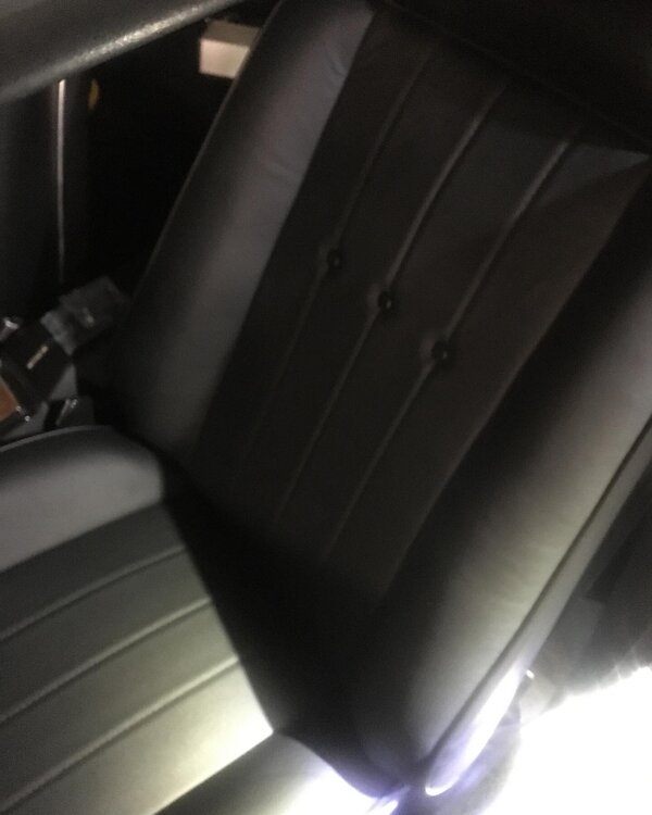

  19. Sorry about the poor picture quality but here is how they look.
  20. I did the same as far as 3point in mine plus I beefed up the foam and added bolsters to the original type buckets. I plan on doing some track events and wanted the extra support. Plus the extra half inch or so of foam in the seat is VERY comfortable driving... I also went with leather instead of vinyl or the cloth.

  22. QA1 makes some awesome complete suspension packages. I installed their "Stage 2" kit on mine with three position coil overs and it handles very nice. I haven't dropped it to the lowest position yet but I know in the middle it's low and handles great. They use tubular control arms, Heavy sway bars, and all the mounting hardware to convert to coil overs. Hardest part was taking off 50 year old components LOL.
