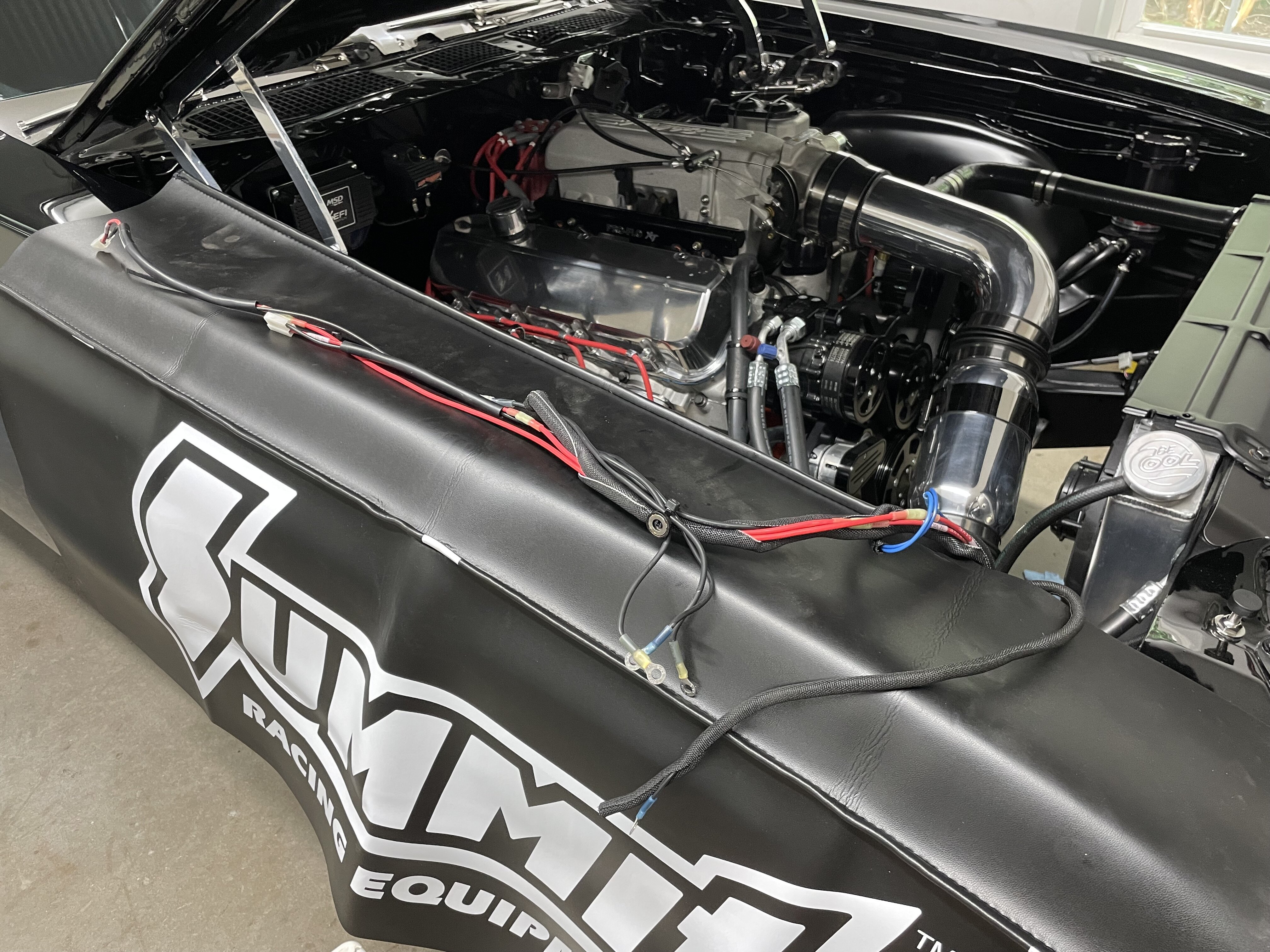

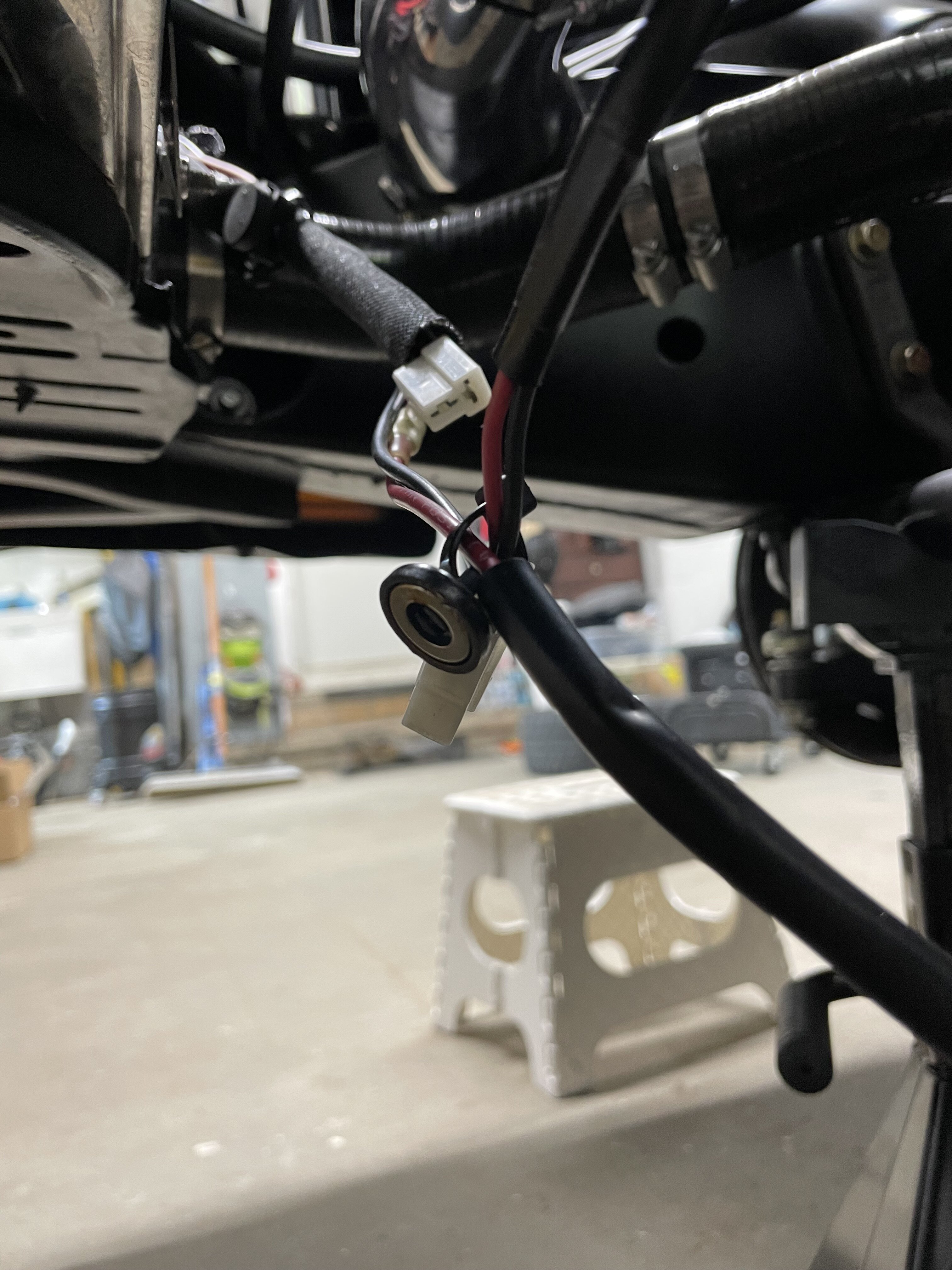

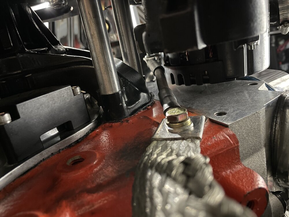

Re-wiring update. I'm done, for now and hopefully for a long time. I added some photos of my ECM mount which was really the final piece of the puzzle. Supposably the Edelbrock Tech forum contact was going to provide some detailed mounting and wiring instructions to help reduce the TPS issues I had been having, but he never did. The mounting idea just evolved but mostly came from a member I met at Carlisle. I'm terrible with names and our conversation was cut a bit short. He's from Rochester (Grey monte w/ LS)? So far I've drive 100-150 miles since the re-wiring and so far it's been great. My TPS issue appears to be resolved and when the TPS is happy, the car is happy, very happy. The fan module is great. Although I need a good test drive in traffic on a hot day, I've not been over 190 since wiring in the separate fan module. I think the biggest improvement was increasing my alternator to batery wire to 4ga. Not only did I wire it back to the battery disconnect switch / battery so the car quits when the switch is closed but my voltage is constantly 13.8 - 14.1. I wish I documented this before the change but I'm sure I was close to 13.2 and fluctuated. I don' think this was good with EFI. My only and still remaining concern is the voltage drop when cranking. (10.2-10.8?) It should be 11.0v or higher. Not only did I add an additional 1/0ga positive cable to the original 2ga I ran. I also added a relay for the ignition signal to the starter. I was unable to increase my ground wire size (1ga) from the battery to block so that might be part of the problem? My other though is to eliminate my starter disconnect solenoid thats rate for 150A continuous to see if that helps. I'll deal with it this winter. Lastly. I was on a mission to go to a car show last weekend and get good test drive. The first place I went (35-40mi) was cancelled so I got on cruse finder and found one another one 10mi away. Nice small town show with 50-60 cars. I was the only 1st gen Monte. I represented well and came home with hardware. Enjoy the pics. Final Fan module mounting. Made new bracket so I could see display. I used the hole I alrewady had for the previous fan relays. ECM mounting location The fancy bracket made with aluminum and rivets. Install photos. ECM is elevated and isolated from everything. And the dash fit without issue Hardware and photo from Car show. -

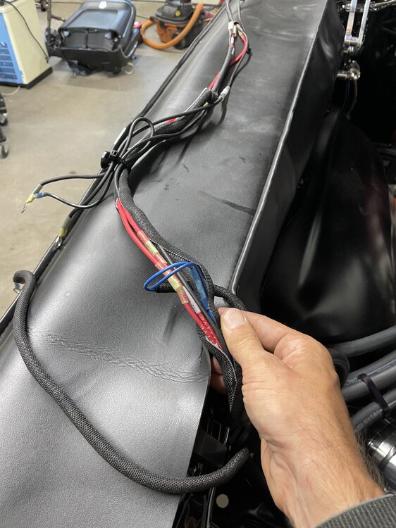

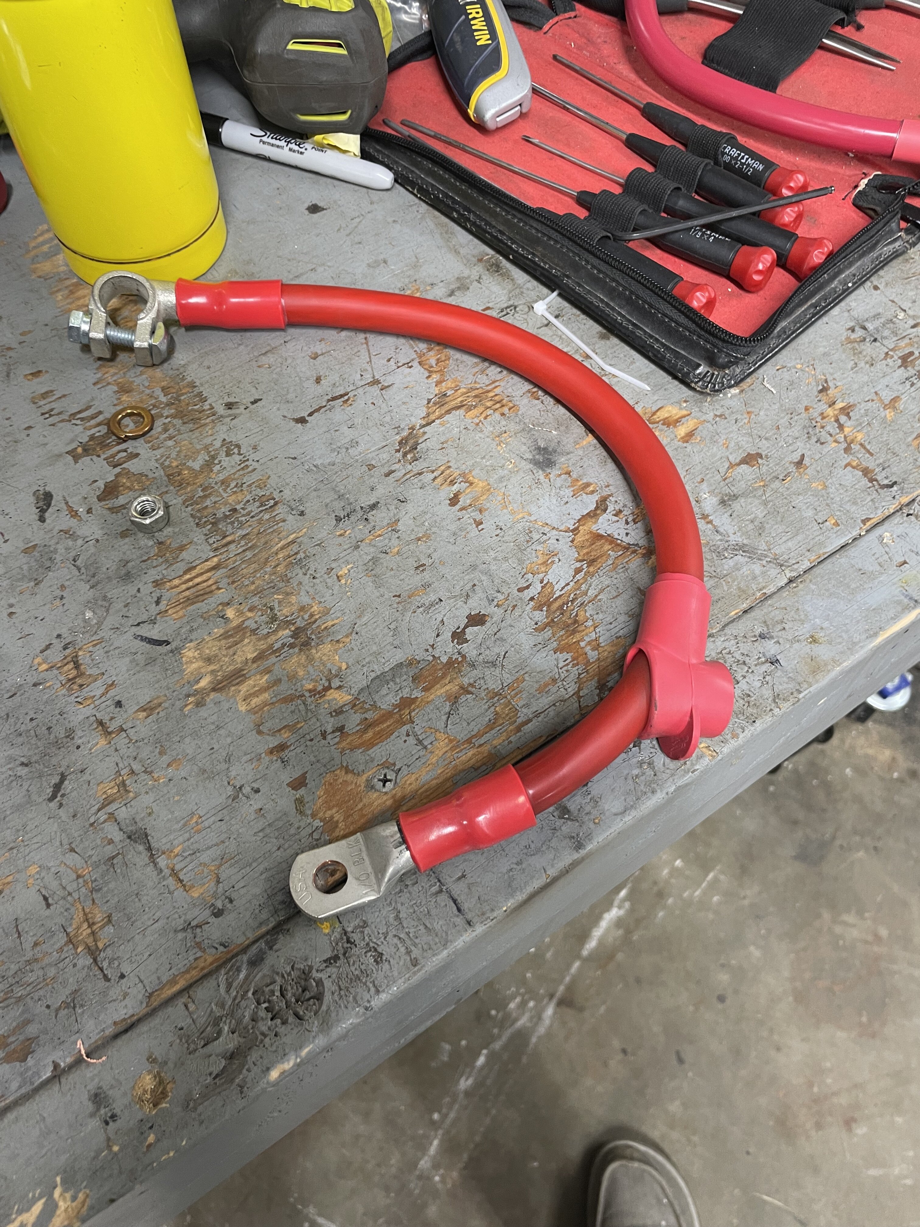

Updatre on Re-wiring Project. The car is back running and fires right up. I now have some Dakota digital issues I need to figure out. I have yet to take any voltage readings at my starter now that I've got a 2ga. and 1/0 ga. coming from the battery but the car fires up immediately and what seems much quicker than it did previously and I don't notice any lag from the starter. A relay for the ingnition wire was also instralled. The fan module is sweet. I'm thinking I had a fan issue on/off for some time. I did find one of my fan wires that looked compromised during disassembly. The fan1 starts at setpoint, fan starts 10 sec. later., once the temp drop 5deg below setpoint, the fans go off. I have to believe if it worked this way at Carlisle, I would have been fine. One cool thing I installed are Maven bulkhead connectors. They have a button to release them. Now, I can remove and get the the wiring behind my battery box by disconnecting three connections. Unfortunately my TPS (throttle position sensor is still flaking out. Thats a total bummer but I'm going to reach back out to Edelbrock. My ECM is totally free and I ran a new ignition wire directly an open spot on by fuse block. Overall it has been worth the effort since I really cleaned things up and addressed some actually issue I found. Unfortunately, the car will be in the garage while I go to the Syracuse National. I'll be out one of the two days. Game time decision as to which but I know where everyone will be. Enjoy! New ECM location pending fix to TPS sensor issue. To make bracket to support. Dakota digital module. Location. Held with Velcro. Mave Bulkhead connectors. Not cheap but you get what you pay for. Used $0 amazon hydraulic crimping tool. Maven connectors comming from my secret switch starter solenoid to disconnect positiove from starter. Final product. I relocated my fuel pump relay so its accessible. It was behind the back seat armrest. The Carnaige. I should have kept all the wire ties I removed. -

Re-wiring progress update from Sunday: I got myself into a project alright. Syracuse nationals may be a stretch but I'm making good progress and it gives me a good target. It does make it harder when you want to keep it clean and tight. I ordered more parts and pieces late last night and can't imagine I wont think of something else. It's been at least 3+ years since I wired and fired it up. Overall my wiring didn't look too bad when I really tore into it but I've also learned a lot since then. The two issues I did find are: 1. The frame from my back seat was pinching my fuel pump power wire. Oops. Good to find now and fix now. 2. I noticed some heat/discoloration on the power feed for FAN 1 which failed or didn't start at Carlisle (cause of overheating). The fans were previously fed from my fuse panel. I used an M&H updated OEM type harness that came with ATO fuses and some spaces for extra circuits for my build and I used the 2 - 30amp spare spots for the FAN power originally. I'm now running an 8ga. wire to feed my fan module directly from the trunk/battery and will use one of the existing extra circuits for my ignition to starter solenoid. Back seat out and carpet moved to access power wires. My pinched fuel pump power wire. Didn't seem to impact anything but I'm glad I found it. Out with the steering column. The only way to really get into it. Ugh! There it is. My ECM is now out. Now where to put it. I had de-pinned and re-pinned the EFI harnesses during my original install to keep the firewall holes as small as I could. I only have so much cable to move it was bundled some. Burnt/hot FAN1 wire found during disassembly. Never popped a fuse either. I got lucky this snap bushing fits the previous alternator wire hole in the firewall and will allow for the larger alternator wire. I'm trying to avoid any new mounting holes, etc.... Some of whats been removed thus far. Original fan relays, old Alternator feed wire. Spare wires never used. The best part is I'm using all the toys/tools I have like this label maker. Last one: Next up is to get the Alternator wire run and ignition relay mounted and wired up. Figure out plan for new ECM location. Fan relay is ready to install. Just waiting for new Mandrel for rivnut tool that I broke. I'll try to keep the updates coming so you can all see the progress. -

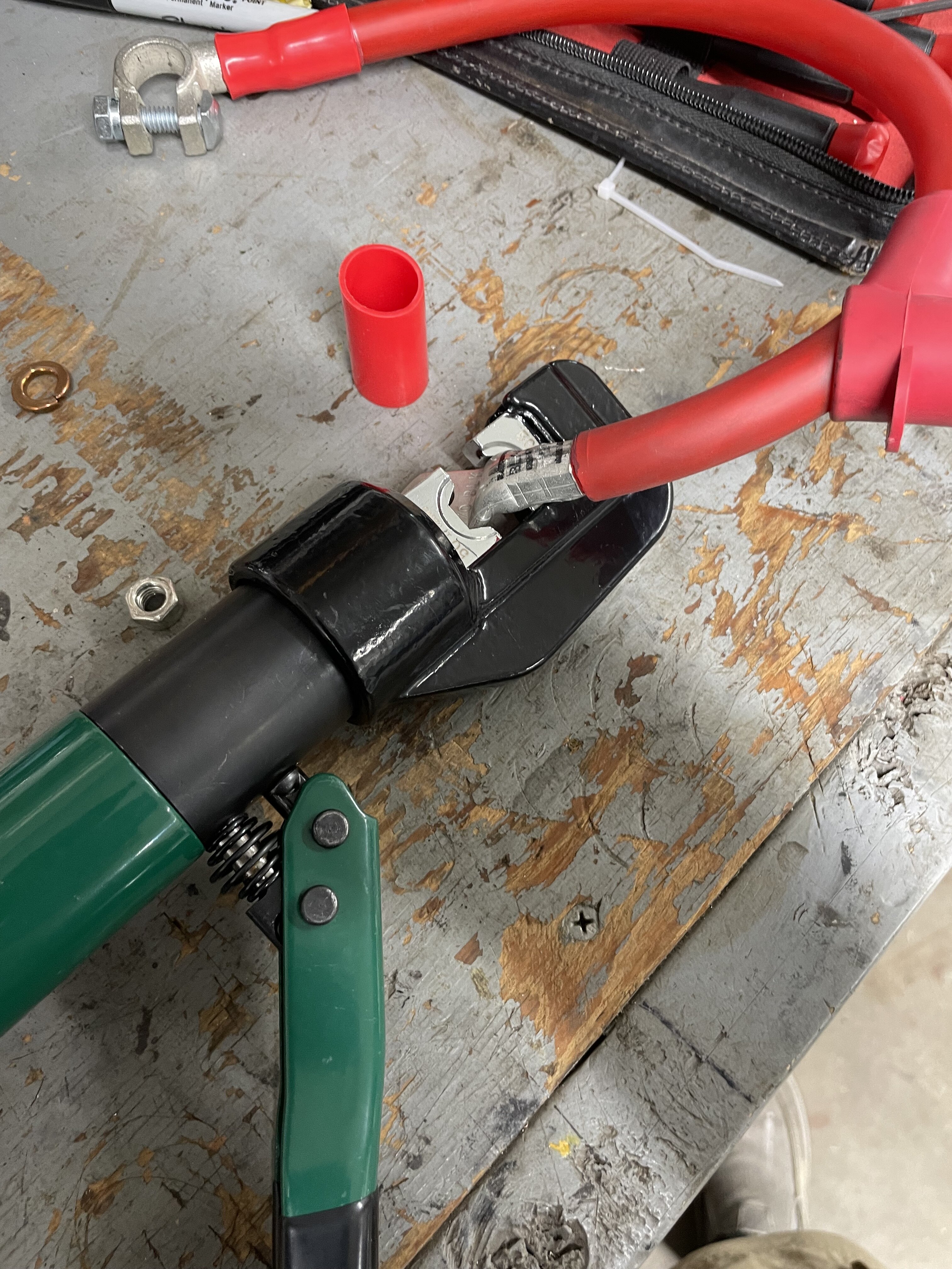

I found my original crimp was pretty crappy but I bought custom cables with one end already installed. I jusrt bought a cheap hydraulic crimp tool off amazon. Less them $50. I should have bought one before I built the car. Works aweome! -

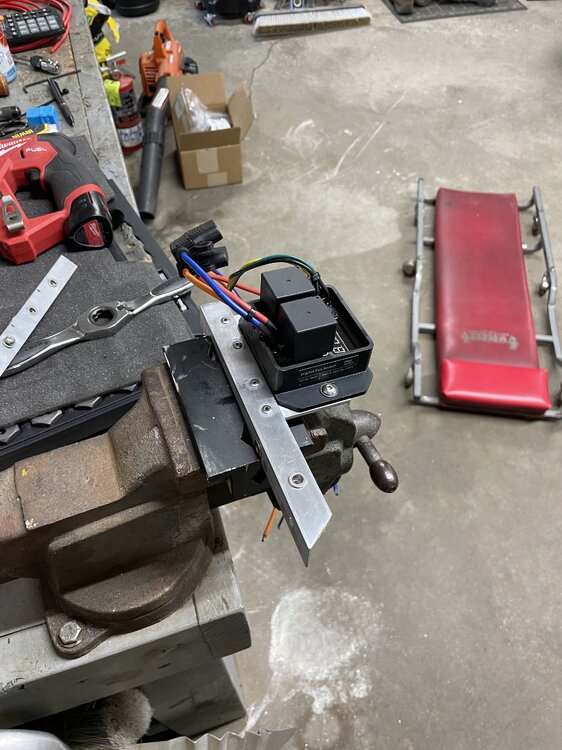

Hey everyone. I don't typically post much but figured I'd try to post up my latest modifications. I intended to keep it short but I got out of hand. Sorry. After overheating at Carlisle and some additional testing, I decided to eliminate my ECM from controlling the cooling fans and I bought the same fan module Steve (Dragcat) has. The car must be reliable so I'm better off dealing with the issues then not drive the car due to reliability concerns. Knowing this was gonna be quite the job, I add the following to the list. My goal is to be ready for the Syracuse nationals. We'll see. I'm hoping for a lot more good progress today. Fan module. This will eliminate ECM fan signal to start the fans. Move my ECM. I have a gremlin with my TPS (throttle position sensor) and it'll creeps up randomly impacting drivability. This is my BIGGEST issue to date. After many attempts to address the issue and based on feedback from the Edelbrock Forum, I'm told I need to relocate my ECM which I mounted inside on the firewall. It's right behind the coil and MSD box on my firewall. I'm told that EMI is likely my issue and moving the ECM and isolating the power and ignition feed will fix. I'm quite certain I can get the the studs but being tucked behind my vintage air make it a rough. What was I thinking trying to make my firewall look nice and clean. Upsizing alternator to battery feed from 6ga. to 4ga. and increased alternator ground to 4 ga. as well. This has been border line size wise with the battery in trunk. I'm also wiring it through my on/off switch so that works as intended. Upsize the feed wire to 4 ga. that is coming from my battery to my main power distribution block in the trunk. Upsize starter wire. I recently had to replace my starter and discovered I have too larger a voltage drop when cranking. (<11.0V during cranking). After more digging and testing, I discover I had only run 2ga. wire back in 2018 from the trunk to the starter. I ran 1 ga. for the ground and recall adding the ground later in the build. At any rate, to my amazement, I was able to feed a 1/0 cable through my frame and up to the starter. Due to the way I had installed the original cable, its not going anywhere so I might just double up on the positive cable. I'll upsize the ground at a later date as needed. I'm also adding Melvin racing connectors for where the main power and ground go through my trunk vs. dealing with exact wire lengths and grommets. Nice quick release feature and clean look. Ignition relay to starter. My ignition feed voltage was also low when cranking (11.0V) so I'm adding a relay to ensure the feed to the starter solenoid has no/little voltage drop. Cruise control. I'm running a speed signal wire from my Dakota digital module to the cruise control module. This is in an effort to get my cruise control working. I'm not getting the speed signal from the GPS module as I expected. Blinker reminder. Might as well. I'm adding some wires so my Dakota digital dash will remind me to turn off my blinkers if I don't do it. I think that about covers it. Sorry for the novel and I'll try to post up so progress picks and final results. I never seem to find/make the time for this. 2ga. vs. 1/0ga. If your making cables, spend the $40 on Amazon and get a crimper. Worth every penny. Some of my previous connections were suspect and this eliminates any issue. Harness to fan wiring. More fan harness New Fan module bracket to replace existing fan relay bracket. Should keep it clean. Curent trunk suituation. Awaiting Melive bulkhead connector for battery cables. Old alternator ground connected(12ga). 4 ga. connected in below pic. Almost too short. Wiper, ignition and AC clutch wiring pulled for modifications. FYI - I used a lot of magnets wire tie holders to contain and hold my wiring when I put things together. Thats been a big help and I recommend them if your struggling to figure out something. I use multiple versions based on application. Finished battery to on/off switch cable -
