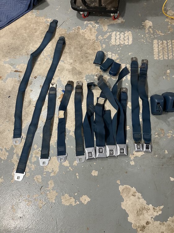

  2. Yes they came with the car and has bucket seats. Long story but the car was totally disassembled 5 years ago by a some jerk who was to do a restoration. After money guns and lawyers were involved the care was moved to another shop that did not want to complete the resto because they did not disassemble it. So the they completed most of the work but the interior came back in boxes. We did determine the small belt buckles are the front lap belts and we have a complete set. Thanks to all who replied!!!
  3. I have no male ends to fit the small buckles. Its going to be a garage queen so he wants to stick with stock. I have seen buckle parts for sale in some magazines. I would like to disassemble the buckles I have to clean and lube. How are the buckles disassembled?
  4. That could be the case but there is no way to connect them to the shoulder belt. Also the console has the 4 buckle pockets.
  5. No the do not fit the 3 rear male ends.
  6. This configuration is for bucket seats. From left to right the first 2 are the shoulder. The next 3 would be the rear. The four buckles would be for the buckets. What are the last 2 for? I would believe we are missing the rear 3 buckles. Any help would be appreciated. Joe
  7. We are now ready to install the interior and I have some questions about the seat belts.
  8. That is correct.

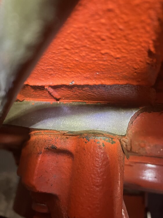

  15. So we did inspect the block code yesterday. Below is what we found after cleaning. When you magnify the photo it would appear some very faint numbers or letters are possibly there. Hopefully next month we will be ready for the new exhaust system to be installed. I will then check the transmission code when it is on the lift. Still chasing down some electrical issues. I have a thread open on the electrical forum and will post there. Again thanks for all of the info!!!
