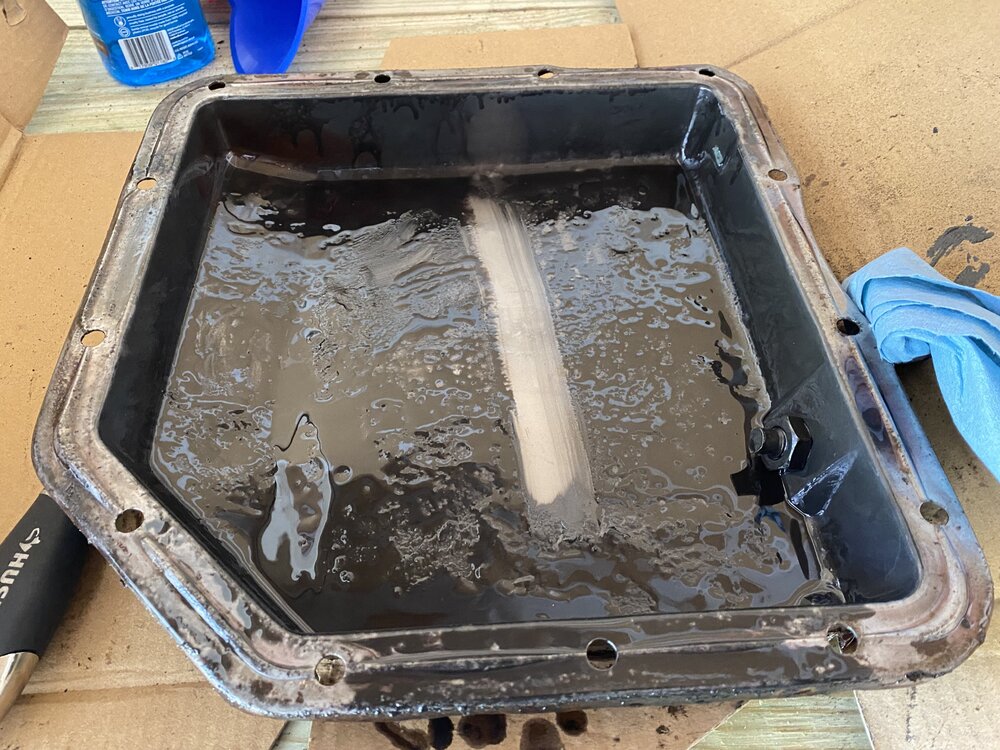

  8. I hope so too. Need to rent a pipe expander tomorrow to finish the exhaust. The h pipe was dented a bit on one end so the pipe won’t slip in 🙄 once that is fixed I can drive it and hope for the best. A rebuilt is only like $1600 so it’s not too bad but I’d rather not have to replace it
  9. And yeah all that material in the trans pan does not look good. If the trans takes a crap on me I’ll throw another one in 👍 thanks for the advice everyone. Mc1of80 sorry I got my panties in a knot 😂
  10. Yeah I know what he was saying. Telling me there’s no way it was clean fluid put me off a bit, I saw it with my own eyes I know what it looked like. No worries on my end.

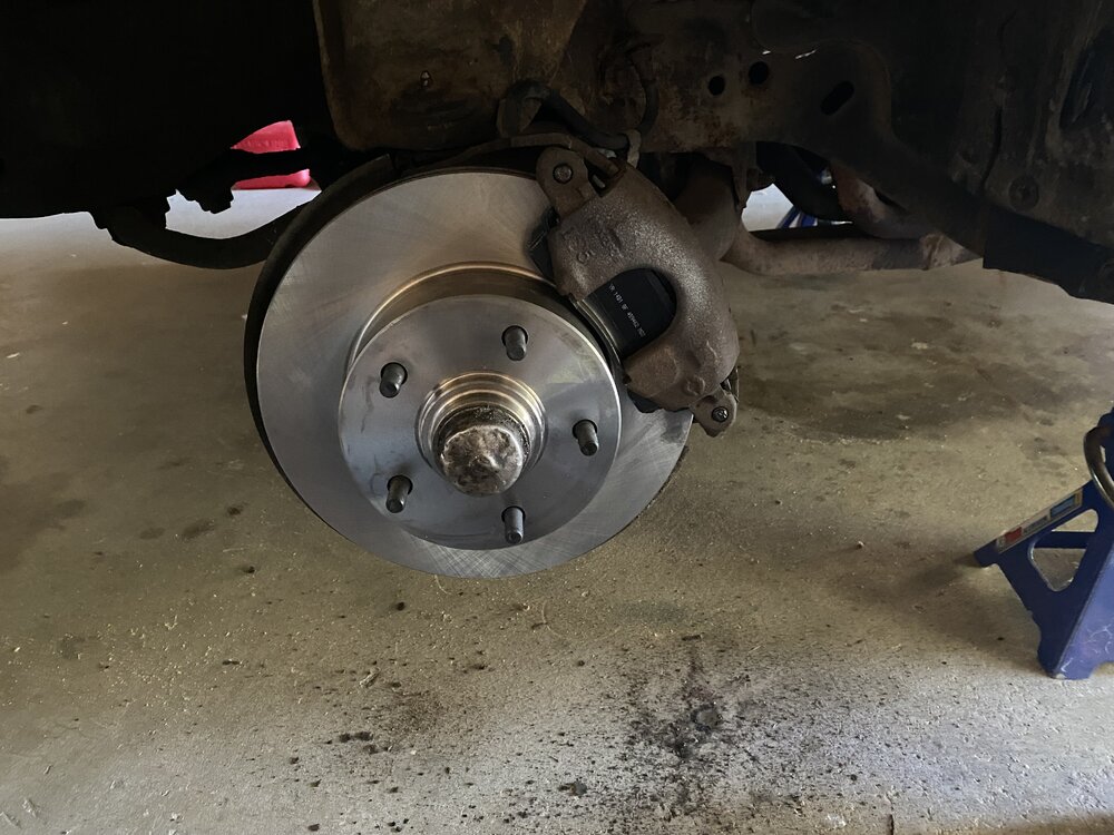

  12. It had multiple grooves in it, and a really deep one near the outside edge

  14. Last thing I got to before I started to lose daylight and energy to keep working was replacing the drivers front brakes. Again the rotor was grooved so someone did a pad slap on a damaged rotor. Not the ideal way to make this repair. I replaced the pads and rotor and cleaned and repacked the bearings. Tomorrow will be the passenger side brakes, both front shocks, and an oil change. Then it’s Flowmaster time 😁
