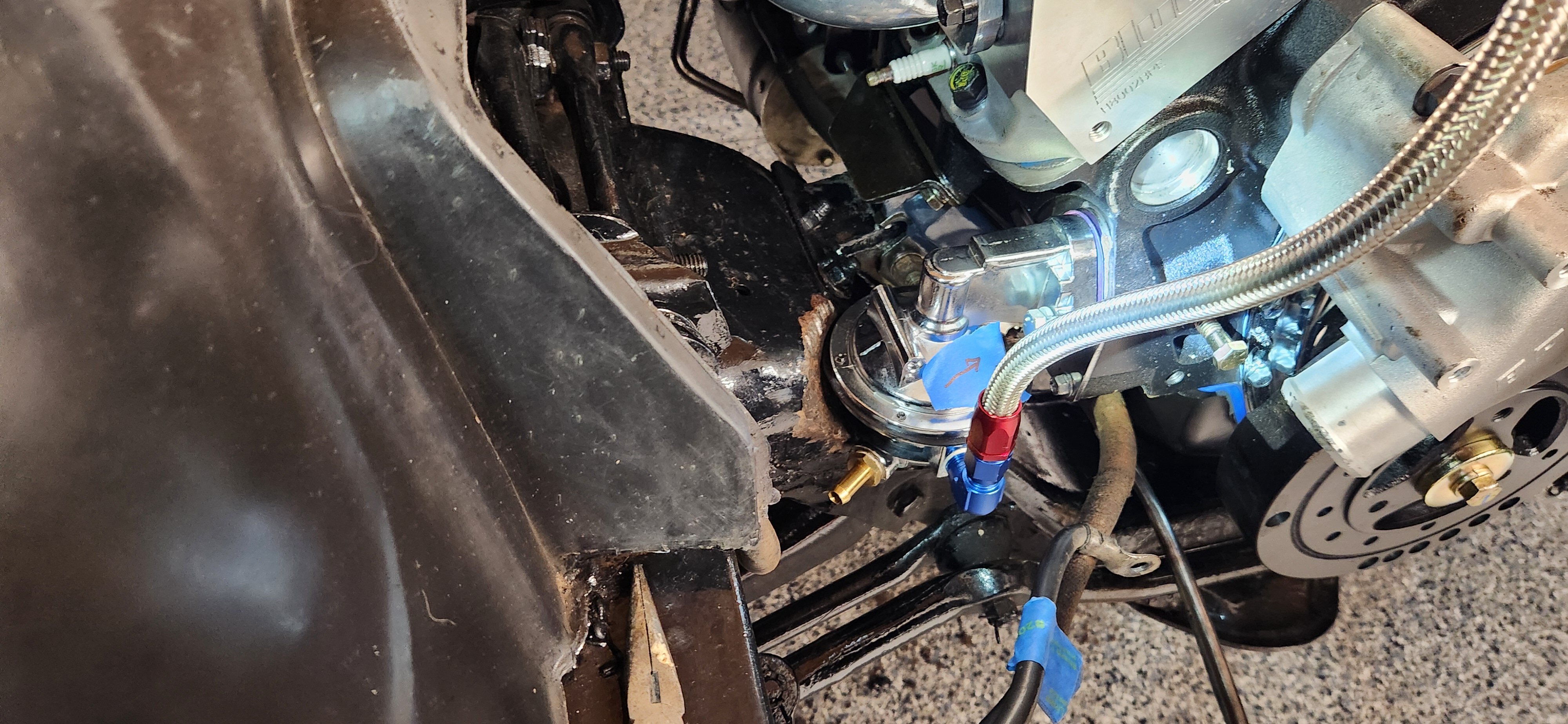

Yes, me. Crate 383 had an oversized mechanical pump. The cutout was about 1/2" too shallow to fit the pump, so out came a handheld propane torch, a 3/4" round steel bar, and a big hammer. Slowly shaped the cutout by heat, bash a little, test fit. Wash, rinse, repeat until I had about 1/4" gap all around. A few passes with a flap disc in the angle grinder cleaned up some of the carnage, and then applied POR15 and glossy Rust-Oleum top coat. With solid engine mounts, that's plenty of space to prevent contact. -
