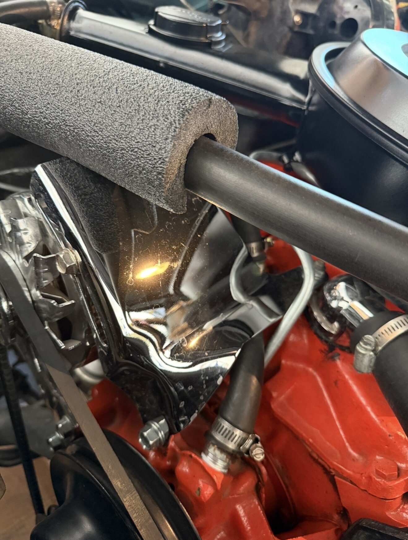

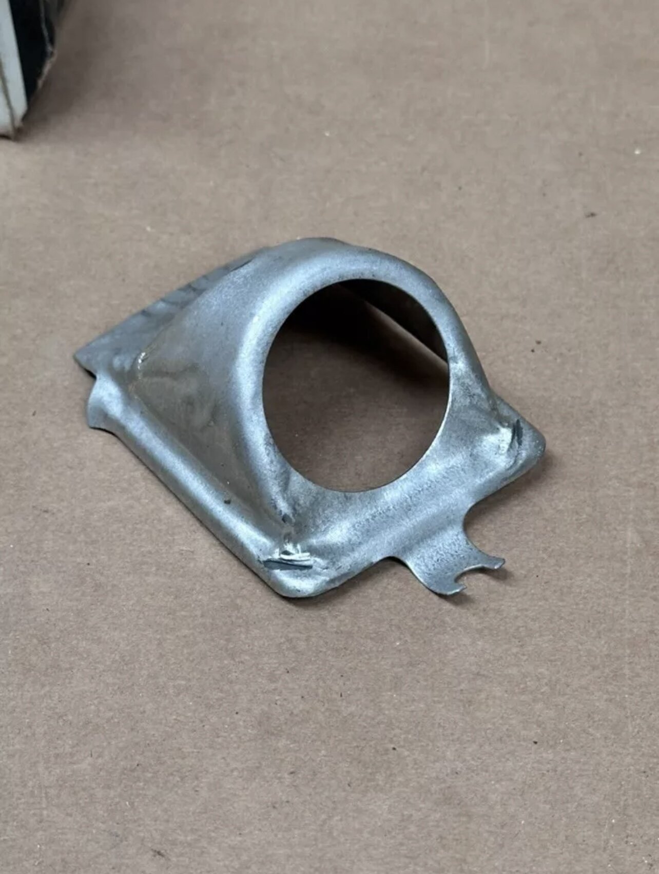

  1. @Rob Peters and @Marks71 Thanks. Now I see. The thermostat housing for sure. Looks like I need to replace the bracket that connects to it as well. @Dtret I need way more than I thought. Let me know….If anybody needs these chrome parts I will sell them as a whole for a good price. Valve covers, alternator brackets, alternator, thermostat housing, thermostat bracket, and power steering cap. I don’t want any chrome under the hood.😂😂

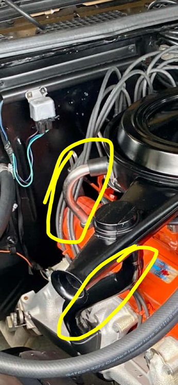

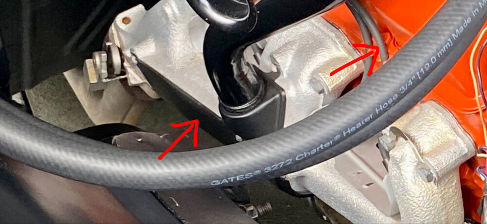

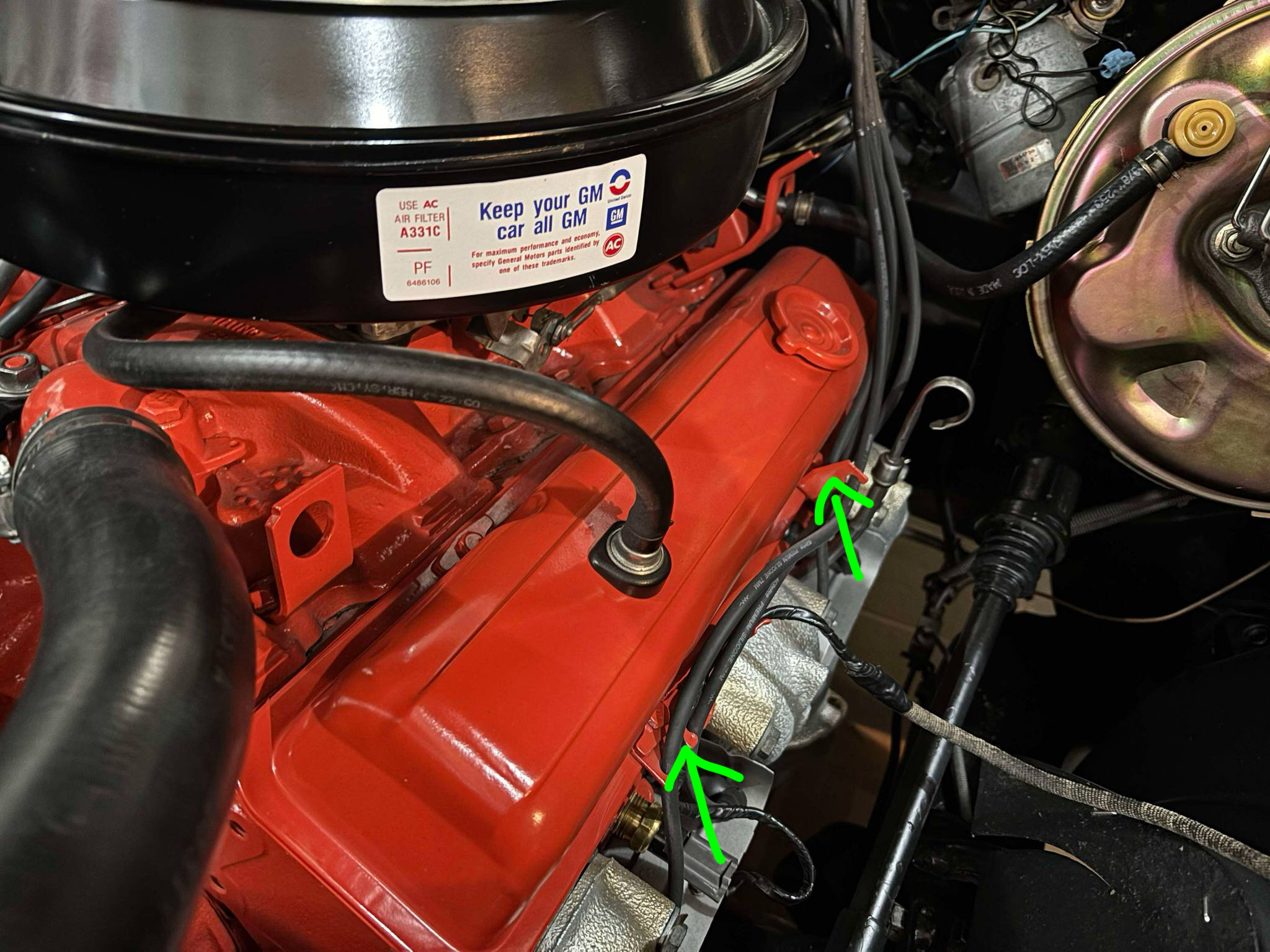

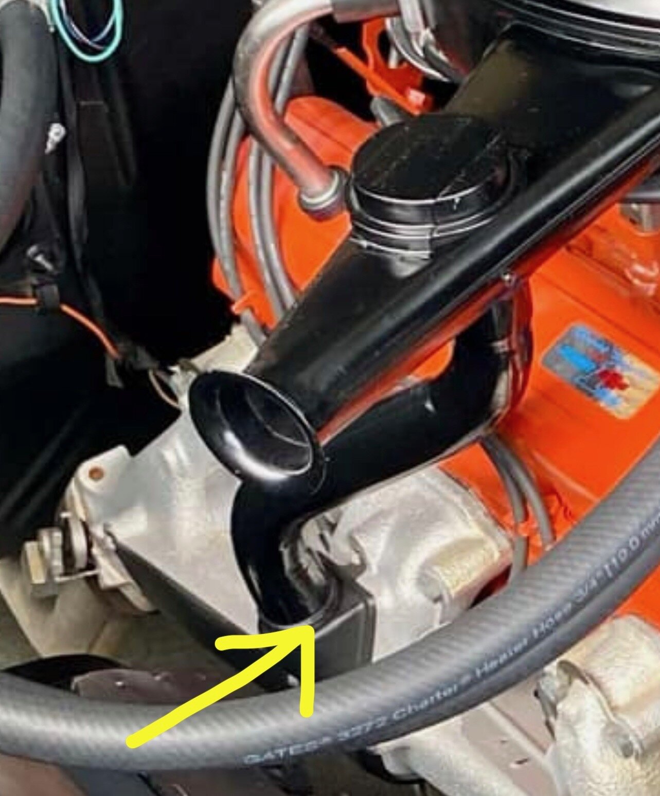

  4. @Dtret I also need these parts. I don’t know the correct names. Aaron sent me these photos of his. I simply put arrows in the pictures pointing to what I need. One part goes under the heat stove on the passenger side exhaust manifold. The other parts are pieces that hold the spark plug wires. Please let me know if you have these as well as the alternator bracket. Thanks again.
  5. @Dtret Sorry, I didn’t even think about it until after I bought the other parts from you. Here are a few photos.

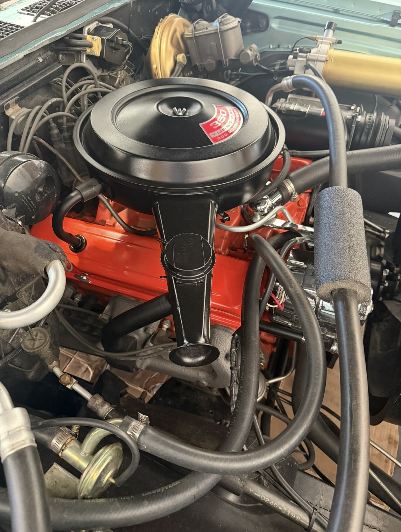

  6. @Dtret and @Canuck Thanks again for all the help. Valve covers and air cleaner are complete. Now I need to get rid of this chrome alternator bracket and get an OEM one. Would either one of you happen to have one or a lead on where to purchase? 😀

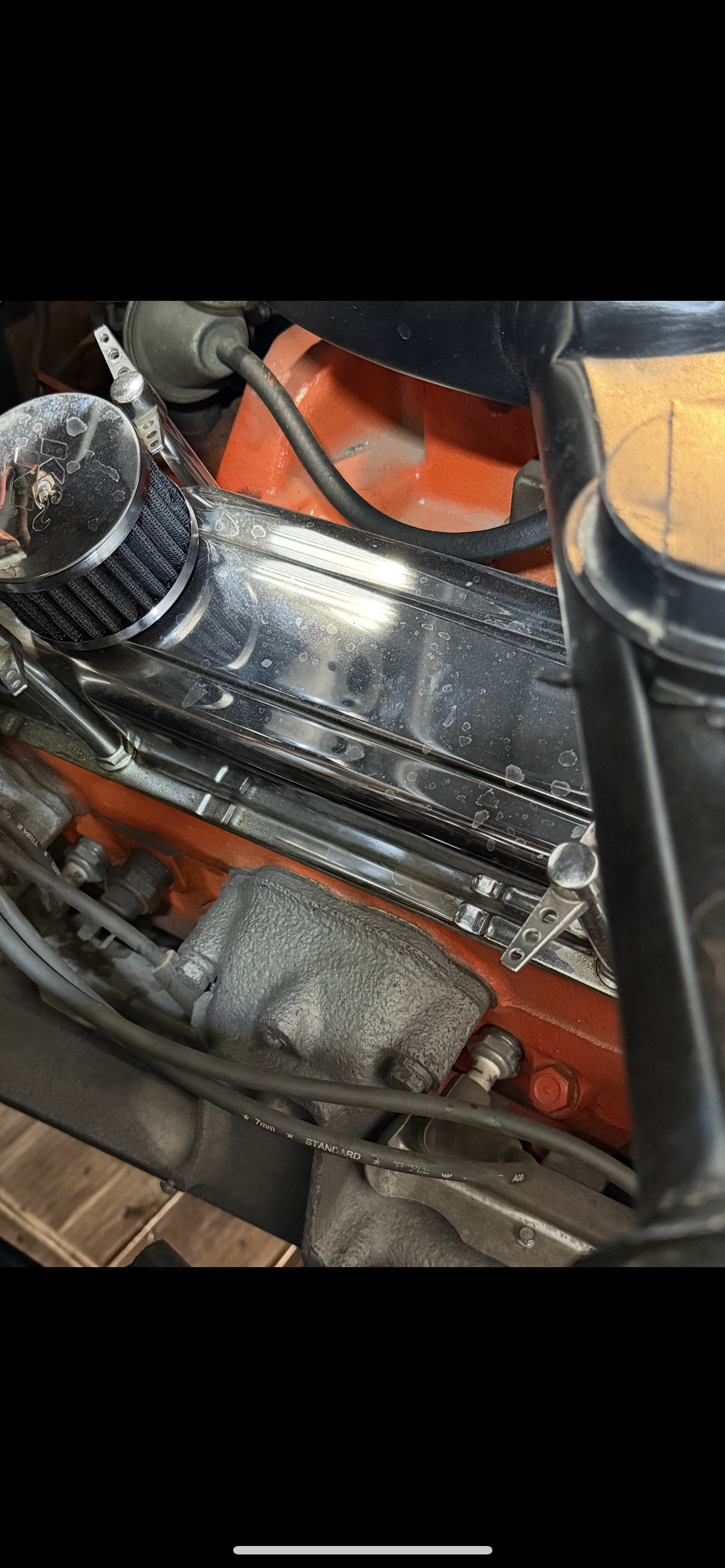

  8. @Dtret Yes, I need the part from the exhaust manifold to the air cleaner, and I also need the part from the valve cover to the air cleaner. Both of these pieces circled.
  9. @Rob Peters I really appreciate it. Will I have the stock look if I order those parts? I’m aware that the parts aren’t OEM, but I need for them to at least have the factory correct look.

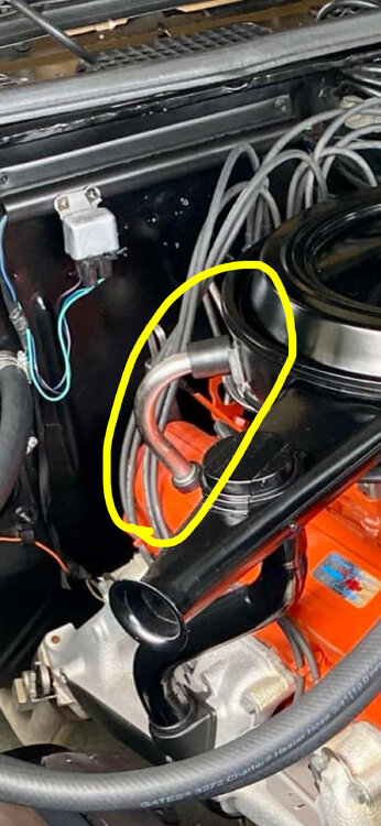

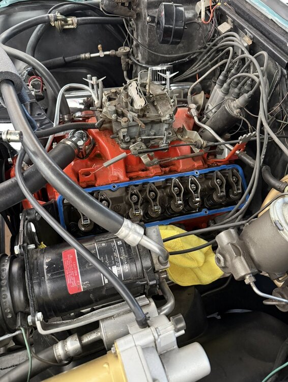

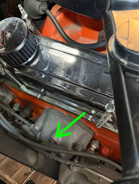

  10. Hey everyone, I’m looking to install the OEM air cleaner and valve covers on my 1970 Monte Carlo. It has the original 350 engine. I’m hoping someone can help me with a couple issues I ran into. 1) The rivet hole on the exhaust manifold to hold the upper heat stove is blocked. Do you think the best way to get access is to just drill the piece out? Please refer to the photos for a better understanding. And 2) Can anyone tell me the name of the hose that I have circled in the photo? It goes from the valve covers to the air cleaner and I need one. Any help would be greatly appreciated. Thanks

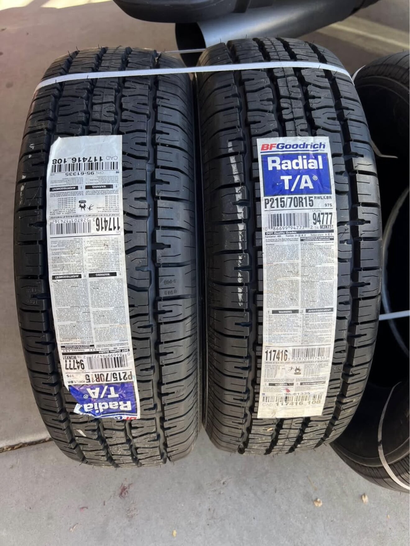

  20. Merry Christmas to all. I’ve been getting mixed responses and I’m hoping for a definite answer. I have a 1970 Monte Carlo. I’d like to put my 15x8 4” offset rally wheels on. The front tires are 215/70/15 and the rears are 255/60/15. Will these go right on without any clearance issues? I have stock suspension
