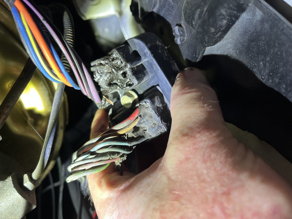

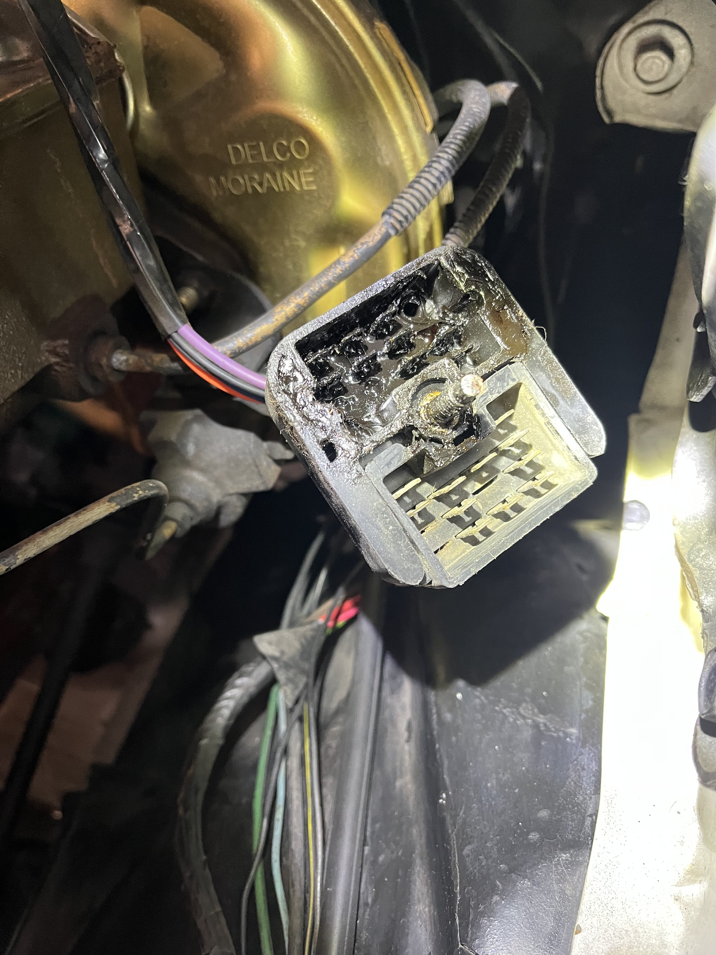

  5. I guess the goop broke down on one side but not the other; I feel like it's a miracle that there were connections being made in there that weren't causing intermittent problems. I am through most of this now but several of the wires that got sent with the gauge kit are way too short and I'm having to splice them. Thanks everyone for the insight.
  6. Happy Saturday! So I'm installing the idiot light to gauge conversion and have to add some wires to the forward lamp harness connector. Please see the pics below, not sure what happened here but I am assuming that both sides should be relatively clean instead of black gook? Not sure if this is dielectric grease or leaking brake fluid from the past or something else. I think I am going to try brake cleaner on this on both the firewall side and the plug side. Any suggestions here?

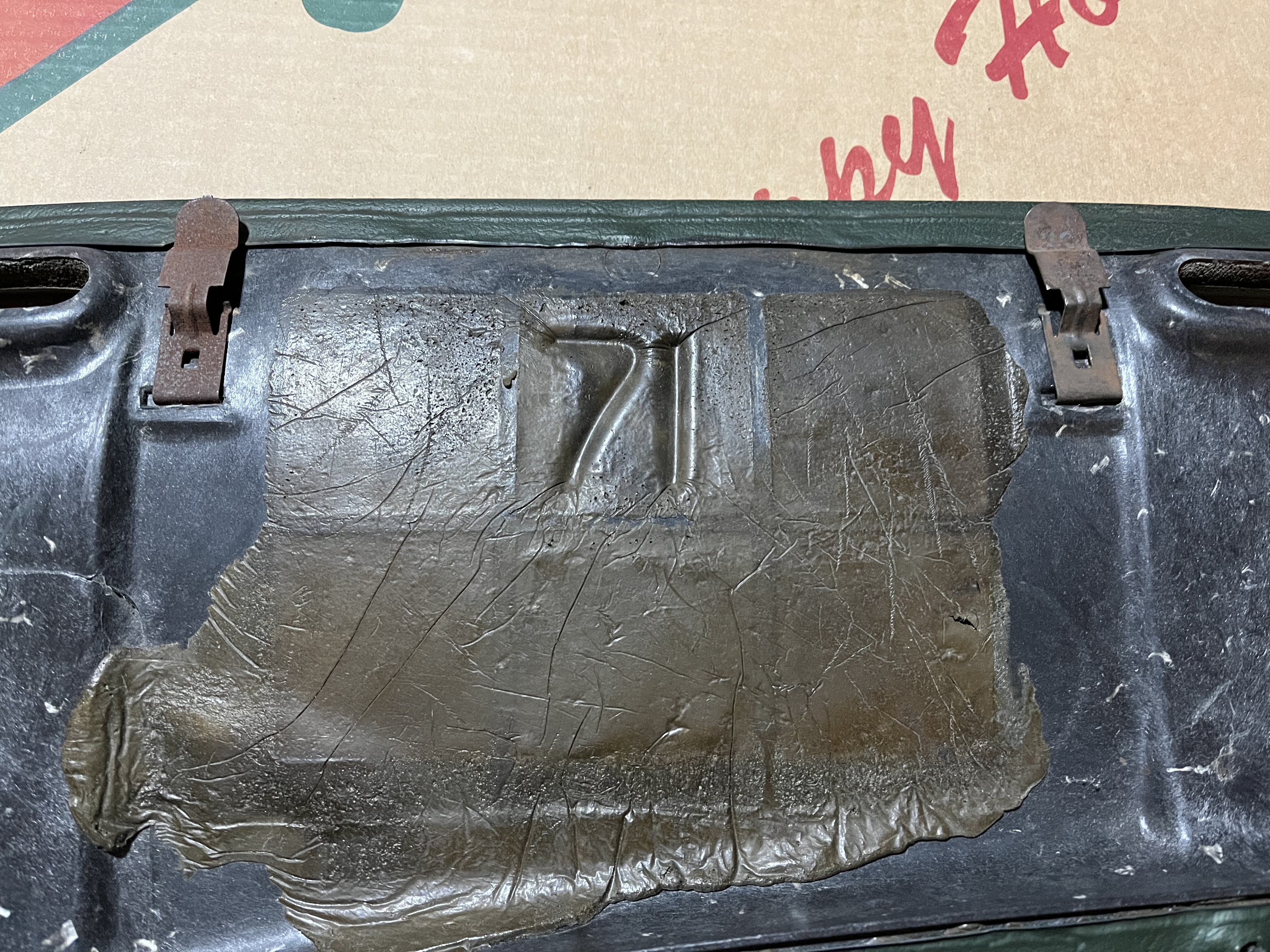

  8. So I pulled the dash pad on my 1970 Monte so that I could troubleshoot the gas gauge, and on the underside it has a "71". See crazy photo. Does this mean the dashpad was, oh, I don't know, from a 1971 car? Or does it mean something else? Or does it mean nothing at all? The gauge had sort of worked-ish but now is sitting firmly at 3-o'clock. I measure 54 ohms to ground from the tan wire at the plug near the fuse box, which is the same measurement I got on the tan wire in the trunk to ground, which seems reasonable. Any insights welcome, I haven't disconnected the plug on the back of the gauge yet because I'm a big scaredy-cat.
