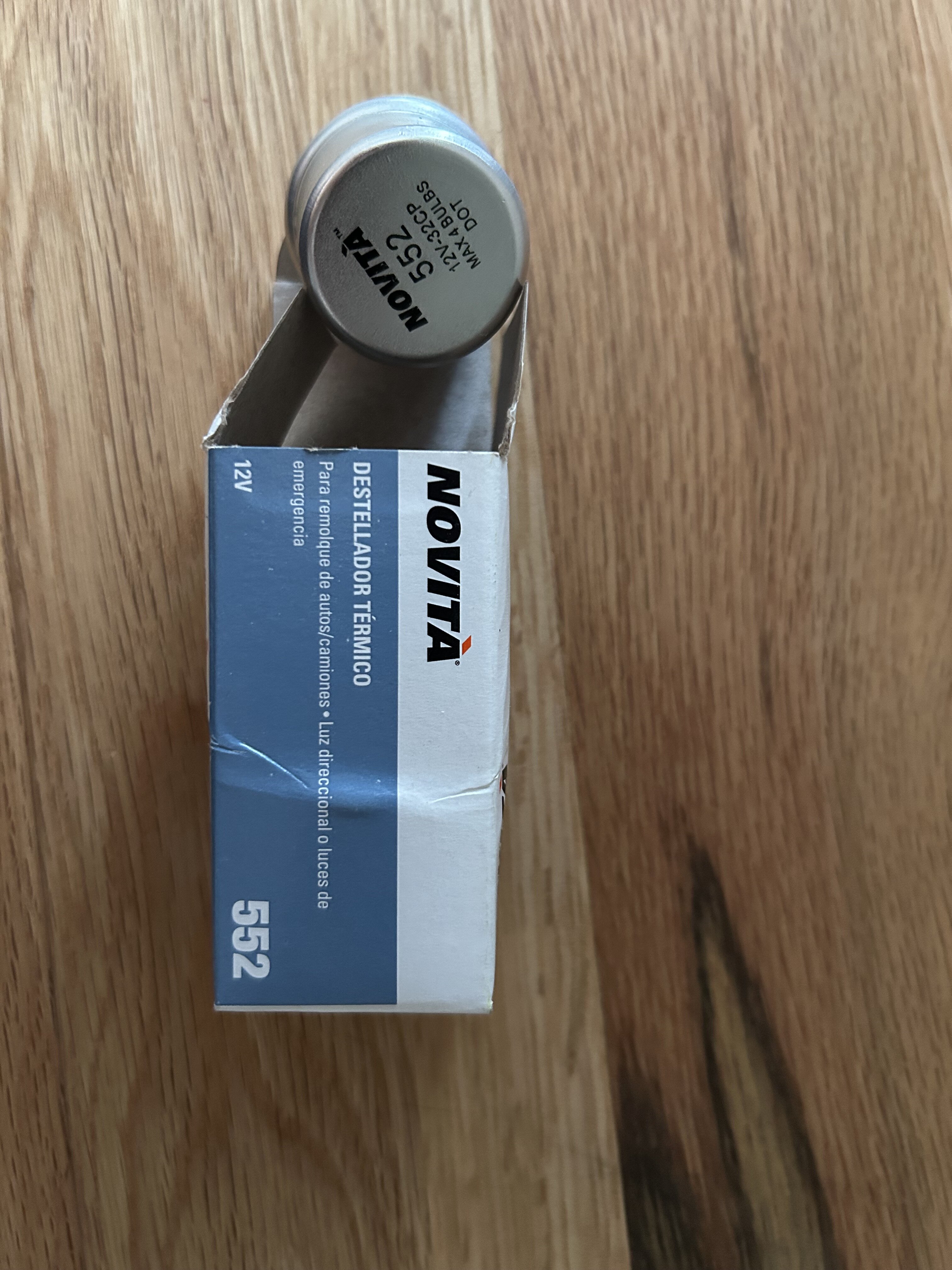

  1. The problem is solved. 😊 The relay was missing, and a cable behind the old connector on the turn signal switch was broken. Sheβ€˜s going for technical inspection tomorrow, and then it will take 4-8 weeks for the authorities to issue the special permit. Thank you guys. πŸ˜ŠπŸ‘

  4. There must be the problem somewhere. The relay is missing from the fuse box and is wired externally. Does anyone have a tip? I would be very grateful.

  9. I'm getting desperate right now. 🀣 The switch for the hazard warning lights works correctly again after the replacement, but the hazard warning lights don't work. Does anyone have a tip? I also replaced the relay. No difference. Otherwise, everything works as it should, except for the hazard warning lights, which won't turn on.
