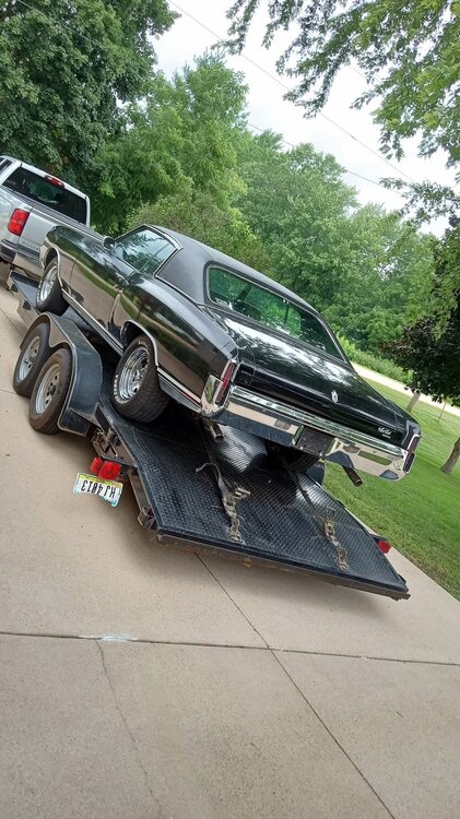

  5. Yeah that was the point, I don't do body work! (Mechanical and especially electrical is my thing)Had to find one that wasn't rotten, that being said it has rust around the vinyl top, and the normal rot under the window and into the trunk, already have a guy lined up for spring, me and my son are going to strip the car, and pull the engine and trans and start rebuilding those over the winter.
  6. So a couple months back me and my son purchased this Monte and it has been an adventure in reworking someone elses poor choices and bad habits. So brakes, had a siezed caliper, bad brake hoses. Got those replaced, also noted the master appeared to be leaking through the cap, cleaned all that up and bled the system, should be all good. Well we drove the car and the brake performance was not good. So later I decide to rebleed the brakes. Upon opening the master cylinder It appeared the fluid hod dropped but there was no leaks, other then the cap seal. At this point I assumed the MC was leaking back in the brake booster. So I ordered a new booster and MC. When I went to take it all apart I discovered that the pushrod in the booster was missing, and that the plastic retainer was what was pushing the MC (Yikes.) After looking at the brake pedal and the crazy differences in the clevis rod length (the bad booster was waaaay shorter and they just set the pedal farther back) and the way the brake pedal was set I decided they had adapted (poorly) a booster from something else in this car and it was far from correct. So anyway on my way to putting it back together correctly I realized there was no return spring on the brake pedal arm, no bump stop, and they had drilled a screw with a ground wire directly into the center of the pedal bracket. What I need is maybe some pictures of someone else factory brake pedal setup, like where the stop mounts, how the spring mounts, normal resting position etc. Any help would be greatly appreciated.
