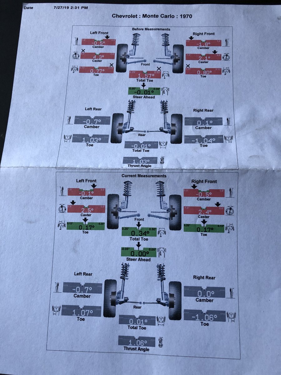

    silveradoss454@yahoo.com

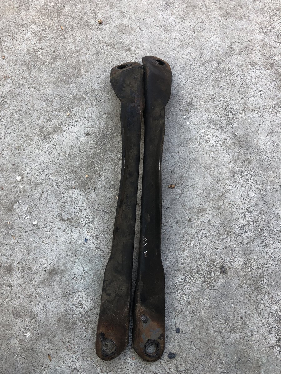

  2. I’ll check again. I found 2 and used those, but I’ll look for the other 2. The original trailing arm brace was a little buckled as shown in the previous pic I posted, and one of the know upgraded ones I had to extend 1/4 more. That’s why it’s lead me to believe my frame may be a little bent at the rear.

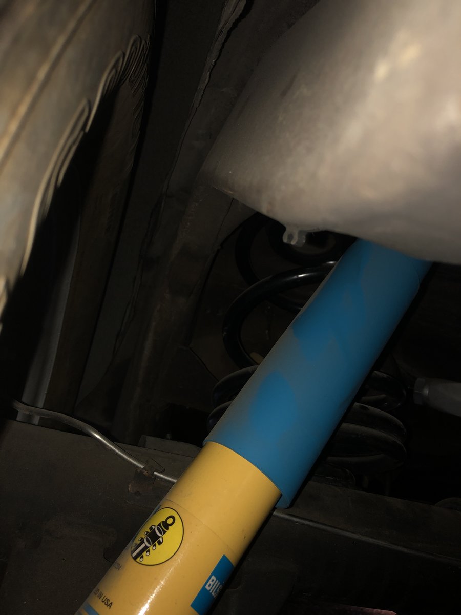

  5. Ok guys so this is where I’m at. I stuck stuck a beefy screwdriver in the “guide hole” and tried to swing the tail of the body to the right to center the rear end to the body. Didn’t move much And I took the car to get aligned. Keep in mind the whole car has Hotchkis suspension besides the springs. That I plan to swap when I lower the car. So here’s some pictures n let me know what u guys think? Normal, bent frame and if bent should I swap or get it pulled??? last pis is of the trailing arm braces I took off. The Hotchkis ones the left one I had to extend 1/4 more than the right to fit.

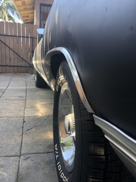

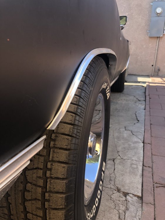

  8. Here’s some shots of how my rear tires sit right now. When I did my body mounts they really shot and disintegrated, but I didn’t tighten the new ones down until everything was is. I also did the X measurement and seams really close/almost exact on the cross measurement. I’ll get the car alignment done this weekend and go from There.

  12. I mean 1/2” ... it became visible when I took off the 3rd gen camaro irocs and put my rallies with 275s. Plus measuring .. the left wheel is tucked inward and the right is right under the wheel well lip. I guess the real question is will the frame be weak that it affects the stability?
